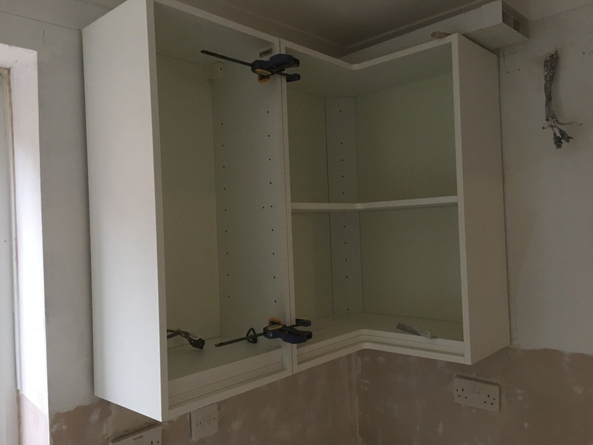

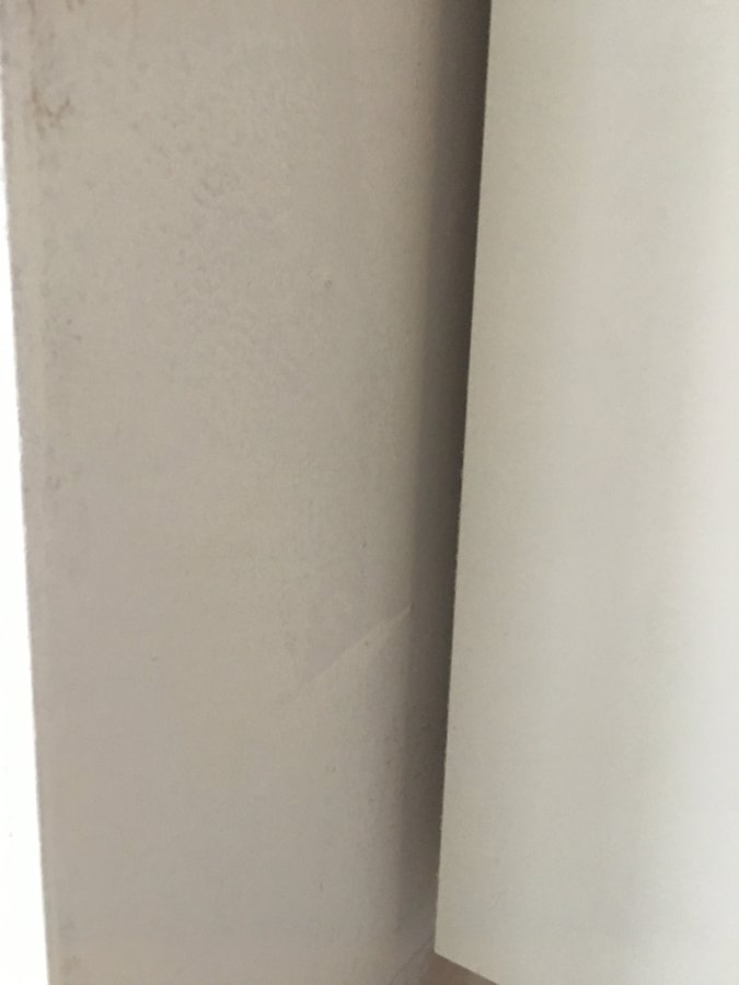

Hi. The walls we are fitting to are not not square straight. The units are fine but we noticed a big gap where end panel goes. We put the end panel in position and realised it doesn't fill the gap.
What are our options to fill this gap.
If you're going to tile the wall above the cooker, and then fit the small wall cupboard first, and then fit the corner cupboard, You'll then need to pack behind the corner cupboard top and bottom to keep it solid, and then use the tiles to push behind the gap.
If you have a spare end panel, then you could take 2" off the long edge, and place that between the wall and corner unit. This will allow the wall cupboard to swing back against the wall.
I'm well aware of that, and gave you two options, but a third option that springs to mind, would be to use a base end panel, and cut that down to the required size.
