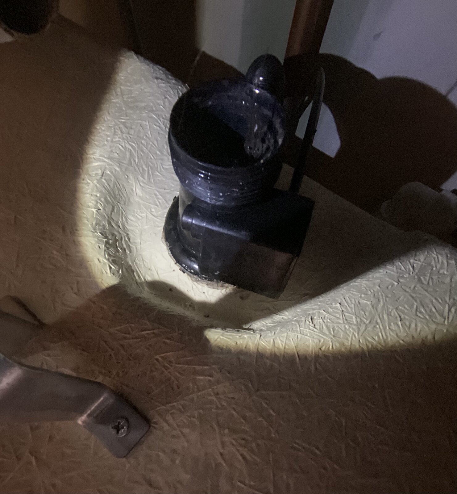

Our kitchen is directly below the bathroom and this morning my wife noticed a brown stain on the kitchen ceiling. I went up to the bathroom, removed the bath panel, closed the plug, and half filled the bath. No leak showing. Opened the plug again to empty the bath and the water came pouring out from the waste onto the floor. Closed the plug immediately. Then saw that there was no rubber washer fitted but simply a thick wad of clear silicone instead and this was hanging loose allowing water to escape. I have decided to replace the whole waste but the problem is that the tap and waste are on the side of the bath against a wall and I have no access to either other thsn removing the bath completely or cut an access door in the bedroom wall and fit a new waste system through there. I think that simple pop up waste with an overflow facility would suit fine but I am not a plumber. Advice needed.

It would probably be less hassle to sort out the issue with the current waste.

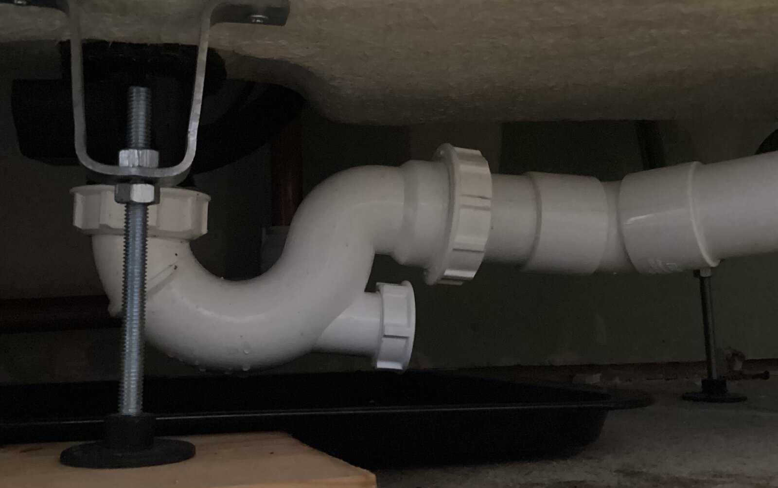

Can you show a clearer pic of the waste fitting from behind the trap ?
Is it the joint between the underside of the bath and the waste fitting that leaks ?

2. Can you show a clearer pic of the waste fitting from behind the trap ?
Too difficult getting my iPad in the space.
3. Is it the joint between the underside of the bath and the waste fitting that leaks ?
No. In the pic below, the silicone used in place of the washer, is located immediately below the triangular grid. When I turn on the tap with the waste unplugged, the water can be seen from below, running down the outside of the threaded part of the waste.

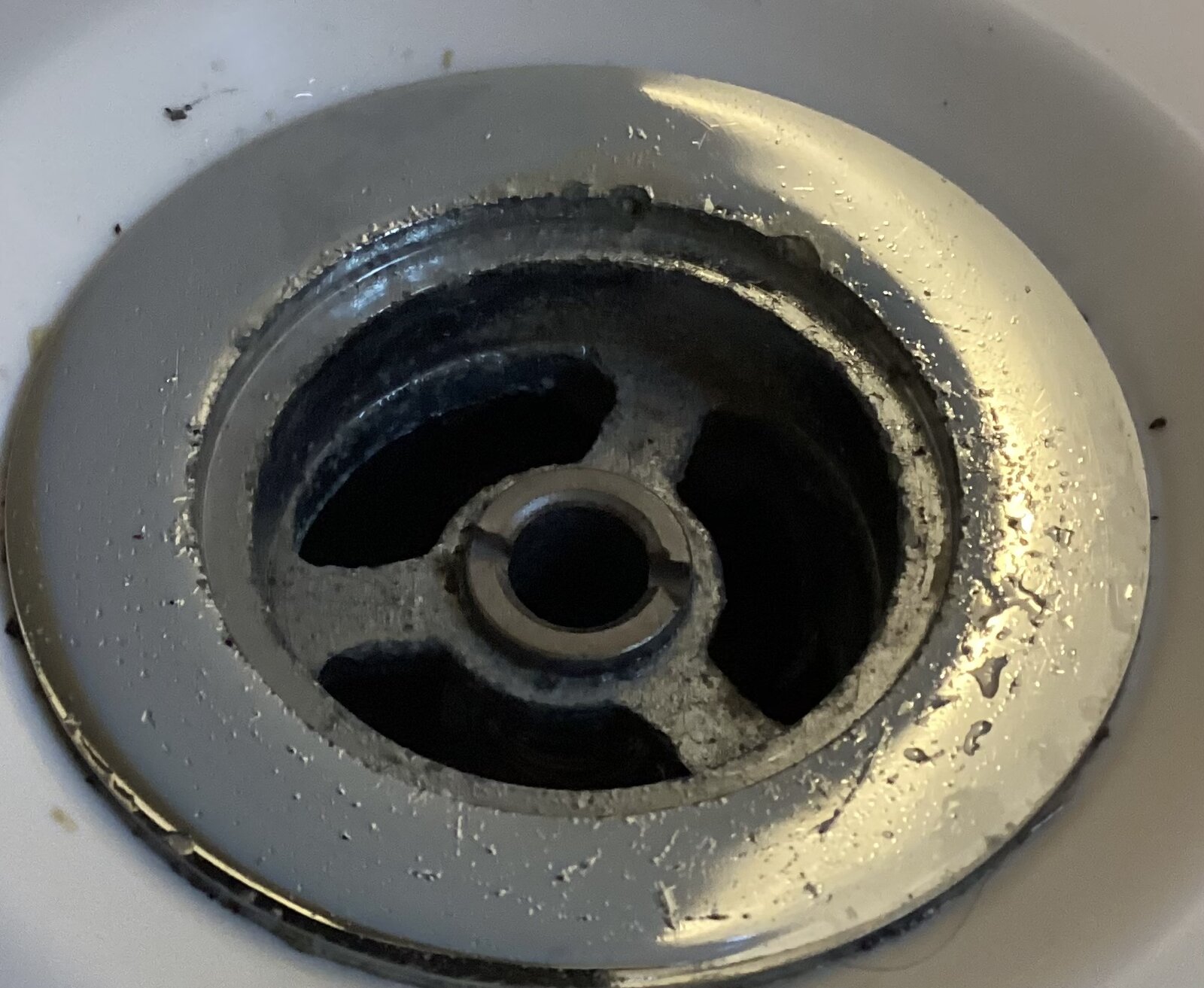

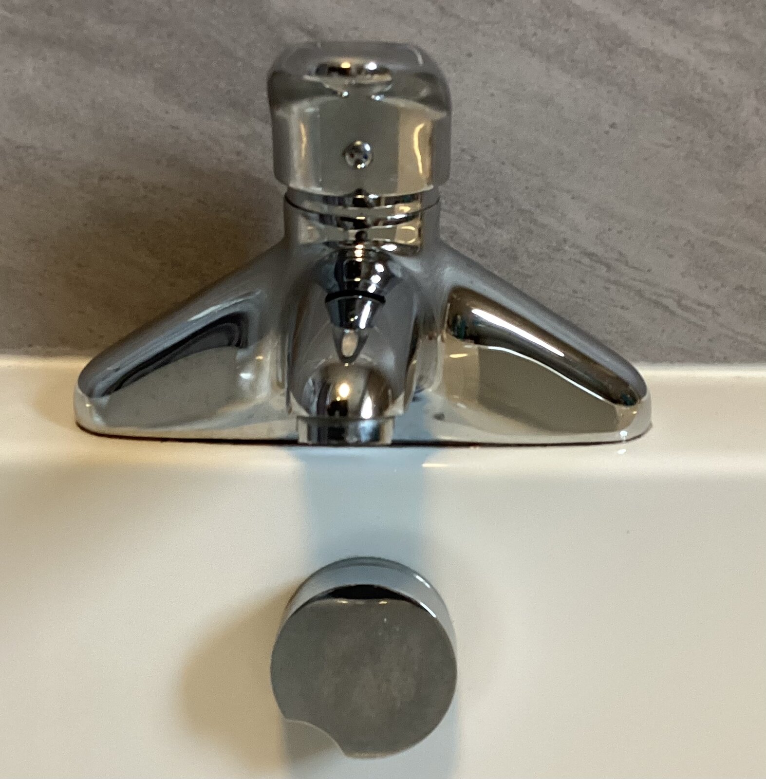

Have just discovered that the plug release knob is faulty too.

Have you tried to tighten the bolt ( in the centre of your last pic) ?
I hadn’t but having just had a quick shower and baling out the water, I gave it a go. The result was that after more turns than I expected, the plug instead of rising to around 4-5mm is now around 10-12. That said, it doesn’t closely when the knob is turned and has to be pushed back down manually. Will have a look at this probleM after snd if I can get the big leak sorted out.

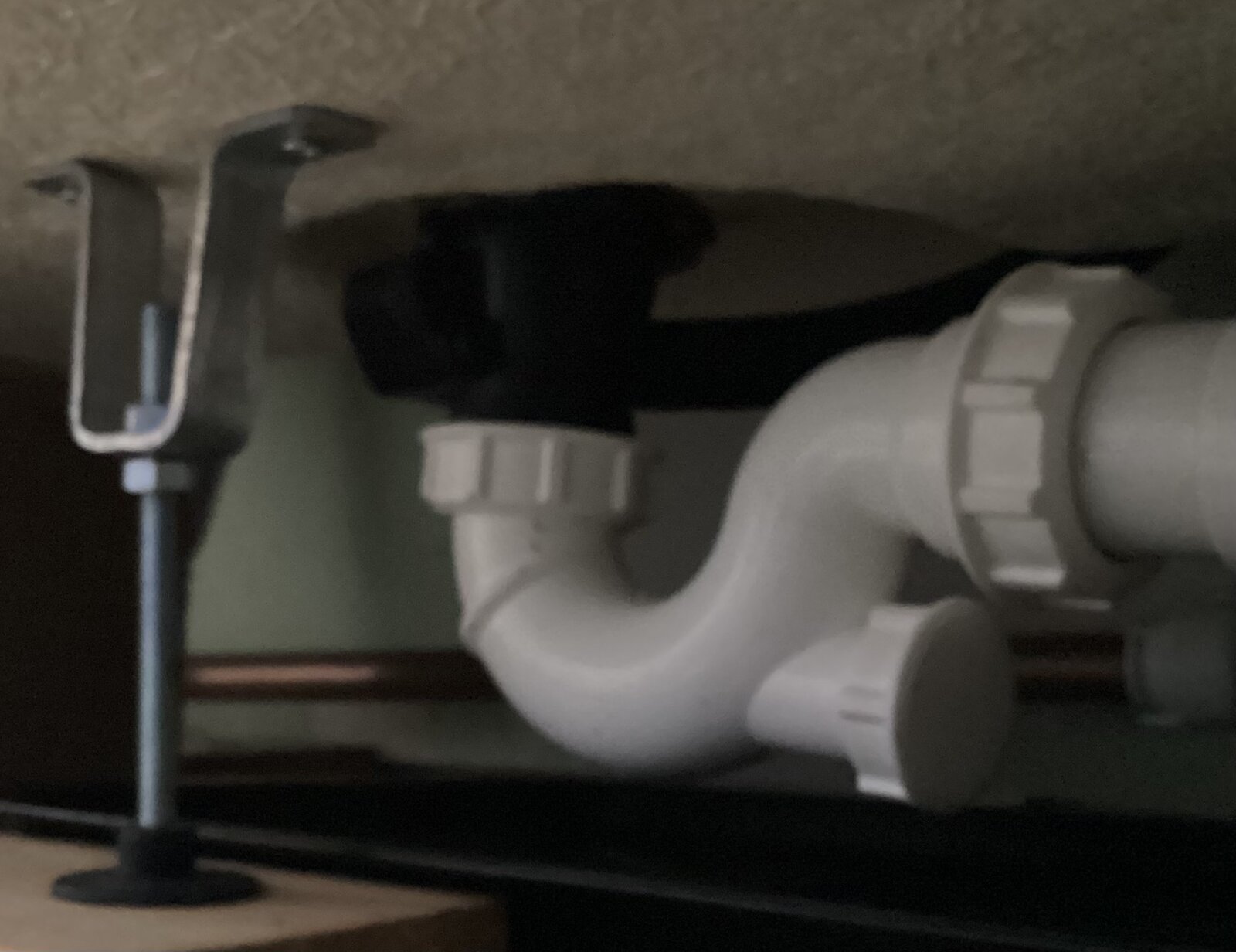

Tried a few and this is the best I can get. Above the trap the waste unit is black with black overflow cable and pipe attached.
Edit: Perhaps the new image below might help.

If you unscrew the central bolt ,the one I previously suggested tightening, the black part beneath the bath will detach. You should then have enough room under the bath to clean it and fit a new seal.
A complete new waste/ overflow combo can be fitted without removing the bath ,but it's a pain in the rear and needs two people !!

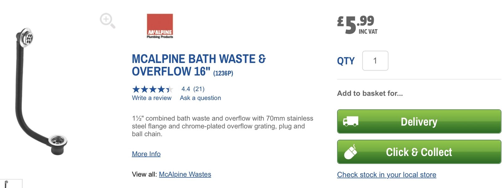

Despite the hassle, I’ve decided to have a go at a completely new combo unit and in the ‘Similar Threads’ section below this thread, I found the link below and the item . However, reviews indicate that a better quality combo would be preferable. But which one?

The linked item is a basic plug and chain job ,and ok if that's what you want.
If you want a style similiar to what you have now ,Screwfix code 27022 is as good as any. Around £20 ish !
Thanks for your patience. What I really want is either a good quality plug and chain unit (ie not plastic), or a similar quality unit with a pop-up plug.
If you unscrew the central bolt the black part beneath the bath will detach.
And it did!
The first thing I did after removing the screw, was to remove that part of the waste that was inside the bath, give it a clean and remove the old silicone from around the hole and the plug assembly. Have now applied new silicon and refitted using the screw to hold it tightly in place. When the silicone holding the plug assembly has set sometime tomorrow, I will again undo the black part of the waste below the bath, clean it thoroughly, removing any old mastic and the refit using silicone on the rubber sealing ring. The following day I will reconnect the trap and test. Have I missed anything out?
Not really ,but you could have done it all at the same time. I have never found the need to use silicone below the bath ,the seal is all that's required ,and if I were you ,I would use a new seal.
