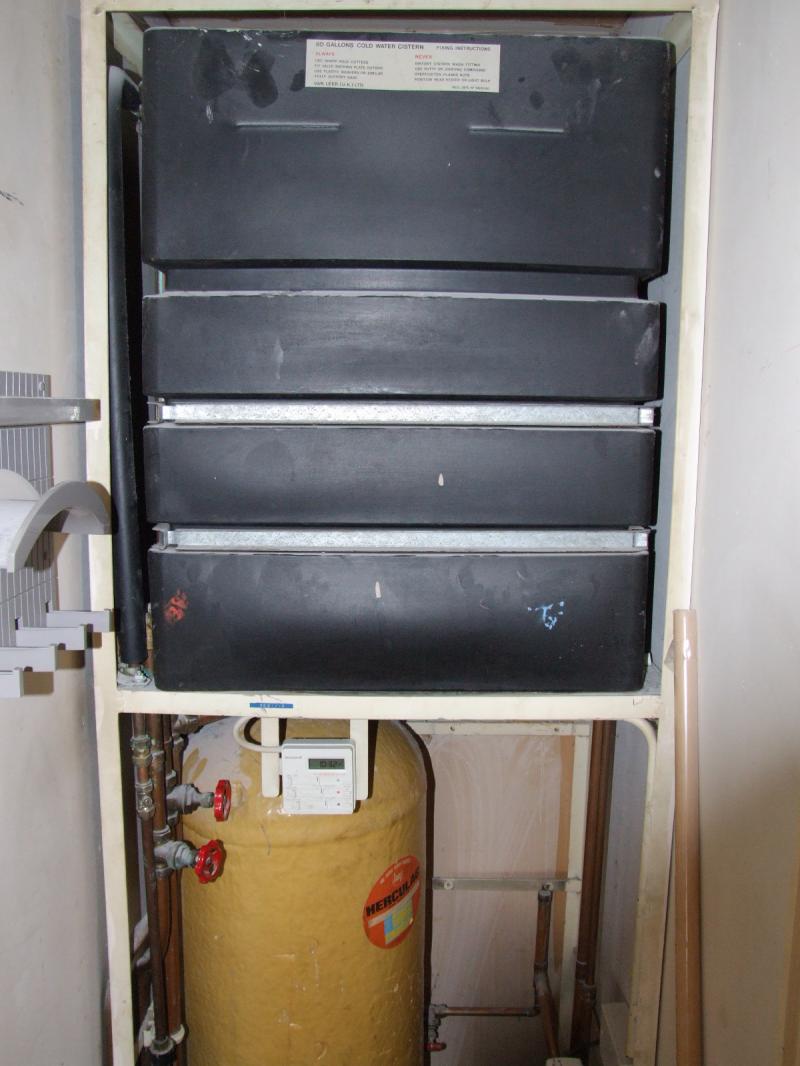

I have just noticed my water cistern above my hot water cylinder is divided into two halves, one hot and one cold? One side is cold supply and the other hot (vent). What is the advantages and disadvantage of having this split system? Also with a system like this how do you fill your primary?
I`m planning to flush my heating system this summer. Help would be appreciated.Thanks

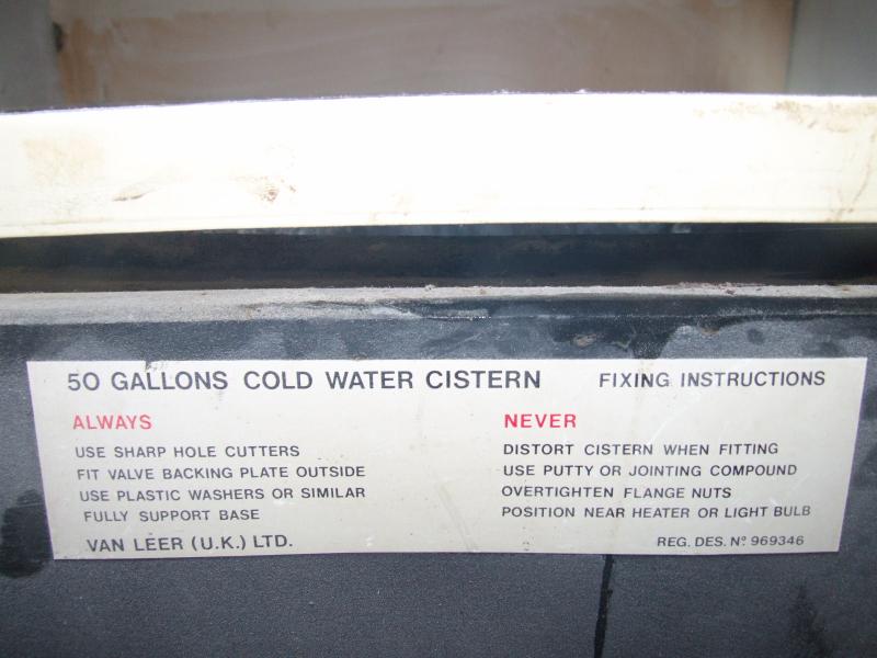

No there is just one tank above the hot water cylinder. There are no other tanks including the loft area.The tank is divided into two halves. Will post a pic soon. Is this a common set up?

I think you guys are on the right track here. What is the advantages and disadvantage of systems like these.Are these systems common? The HWF&E is build in. In the summer I wish to clean and flush my Central heating system. How do you fill the primary? Thanks
Ok the bigger side of the black tank is the cold supply for the cylinder and the small side is the heating feed..
I hate these bloomin things so always advise they change em for a nice combi ;)
Do you fill the primary through the back smaller hot water f&e? This summer I plan to drain down the central heating system.
