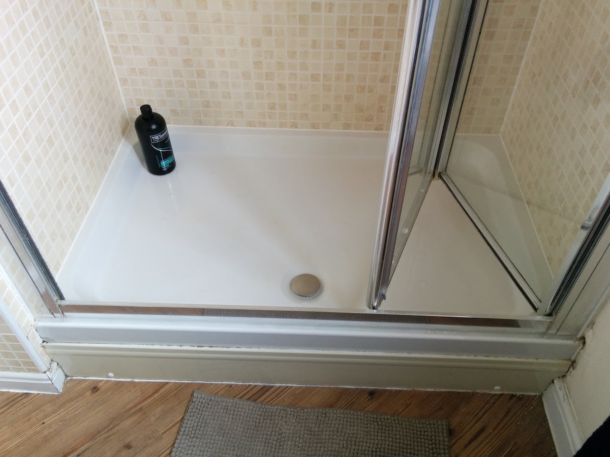

Hi All
Firstly I should say that I am a complete DIY novice and have a real fear of it.
We just moved into a new house and have discovered that the shower unit is not watertight and water has been coming into contact with a plasterboard wall. It seems like this has been happening for a while as the wall is a little damaged. We are now looking to replace the shower door as having it sealed doesn't appear to have worked.
Aside from replacing the door I would like to get the wall fixed as its a bit unsightly. The guy who came round to seal the shower door said that it would be an easy job and I should do it myself. He suggested poking away the damaged wall and then using a foam filler to fill in the gap. After letting it dry I would then need to simply sand it down and pain over it. Would this work? I'm a bit worried about poking away at the wall to be honest.
Anyway, what do you guys suggest? Please be gentle. Im a novice :(
If there is a chance that I could mess up badly then I'm happy to pay a pro to repair it. If I do how much would it cost do you think?

Let's see...*puts on glasses on tip of nose*
Pop down to screw fix, and pick these up...
http://www.screwfix.com/p/no-nonsense-dual-moulded-stripping-knife-3/19995
http://www.screwfix.com/p/ronseal-exterior-ready-mixed-wall-filler-grey-1-2kg/71739
Over all your cost shouldn't reach beyond £10.
Simply scrape out loose plaster and brush out dust with a paintbrush, till all bubbling plaster leaves an even wall that isn't damaged. Let the area dry, or dry with a hair dryer.
starting on one corner, and don't rush to fill it all in, build up the filler as you go along.
As you do this, use the putty knife and push it into the corners, and using the un damaged wall as a level that you are looking to achieve. Keep filling and keep levelling and you'll have a wall filled in level with the good wall, which you'll want to leave to dry.
Do this to all areas and take it's all stages if you're nervous, just remove damaged plaster, dust off, and fill in.
Just remember to paint over it after it's completely dry.

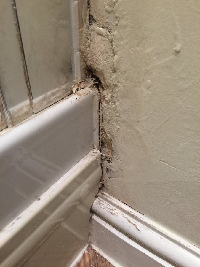

Added a couple more pictures so you can see where the plumber tried to seal the shower (which failed sadly - water still bubbles under)
Water seeps under the door frame in the corners and runs along a small channel where the only place it has to go is into the wall

Question...
In the right side of the picture, the corner where the door frame meets the brown tiles, what is the silicone seal looking like?
You have three weak point.
That area from top to bottom.
Horizontal from that bottom point running along the base where the door touches.
Where the door catches when it shuts, on the opposite side.
Any chance of a picture zoomed out, preferably middle to lower half of the door frame hinged corner?
I have stuck some more pictures up here
https://goo.gl/photos/fsec2CgBqFTdD2d59

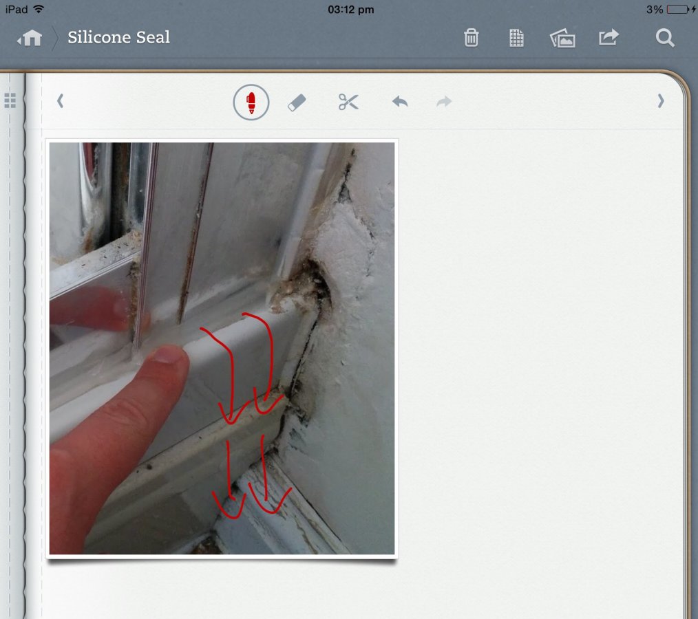

Hopefully you can get some more details. It seems that the vertical seal is OK. Water seem stop get in under the frame, where Im pointing. Same in the other corner. I think in the other corner the damage is not as obvious because the wall is tiled.
I'm not sure where there would be any screws to tighten. Before the plumber put sealant in there was none along the bottom of the frame. I can see why as this frame is not super stable and it would be hard for any seal to stay water tight. Not sure if the door was just installed badly?
Excellent. Now it makes sense.
Two things. An inside part that appears to missing that is causing the water from inside to travel outside and into the wall causing the damage.
The outer silicone seal that you are pointing to? That is only directing the water into the wall and not onto the floor outside. Let me give you your options.

Solutions.
1: have a local joiner/handyman cut a plastic piece and silicone glue it in the place, making sure it's all sealed using waterproof shower silicone.
2: If it's just cheaper to buy a new one from B&Q and have it installed by a competent fitter.

warpkid,
Patching & poking and gluing bits here and there wont work. You will waste time and money.
Dont buy anything until you have determined the extent of the damage and what you will do next.
The enclosure frame must be removed - i suspect that water is getting behind the vertical, metal frame channels at both sides of the enclosure.
Tile should have been run behind the enclosure channels, ie before the enclosure was fitted.
The skirting boards on the left and the right look to have water damage.
Its also possible that the moisture has been creeping down into the floor.
Take the frame off the wall and examine the damage - then post pics on here.
Are either of the walls stud walls? The first pic shows what appears to be a stud wall. If so, then the framing might possibly be fungal damaged.
I'm unfamiliar with a shower base installed like yours - carefully examine below the platform for water damage. Are there stains on any ceiling below?
FWIW: when you stand in the tray does it flex?
