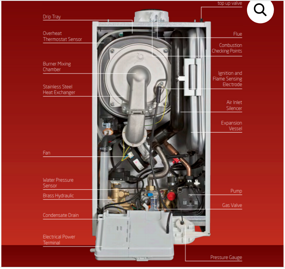

This is the combi I'm planning to have installed.. You have to admit the internal designs are very impressive. Everything looks easily accessible and well thought out. They've even put the schraeder valve for the EV on top
Main compact 30
