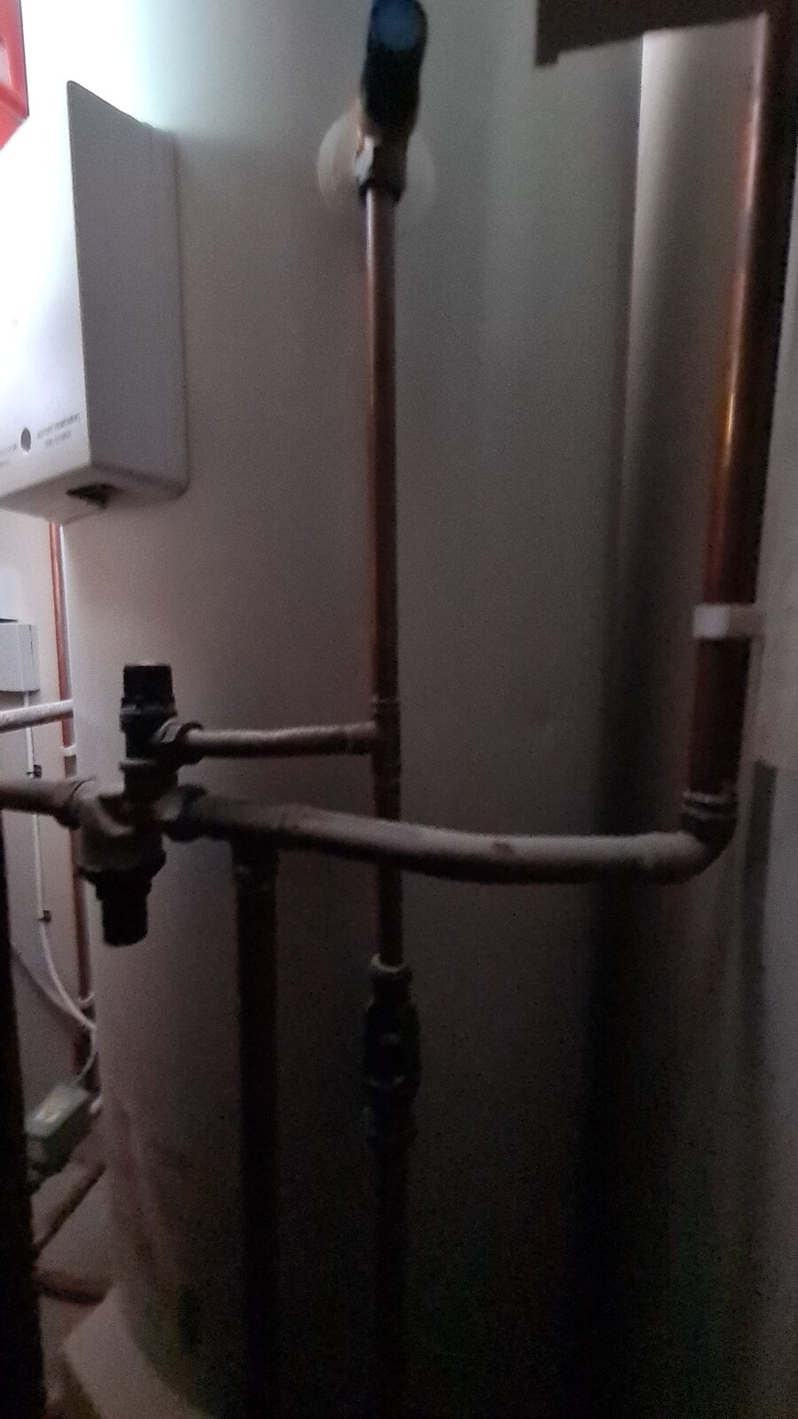

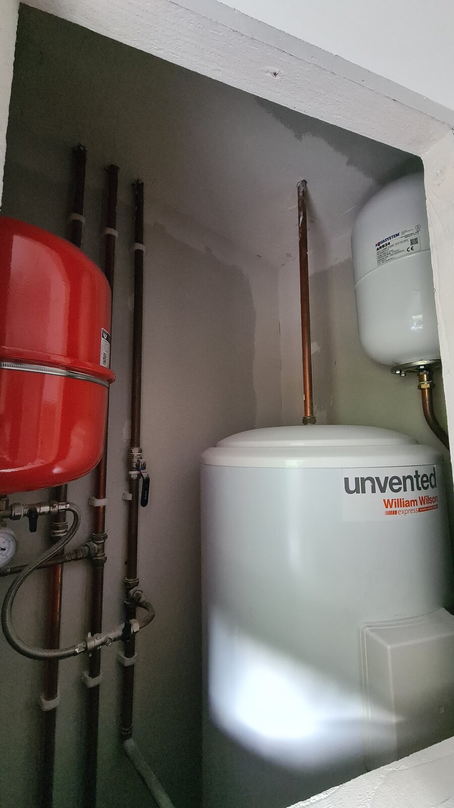

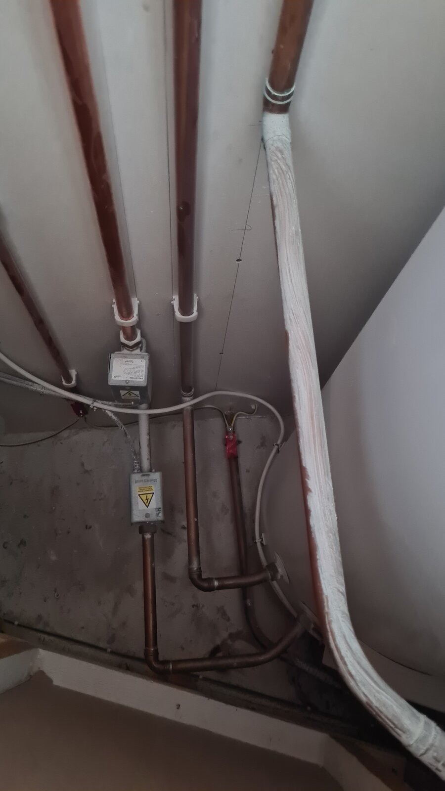

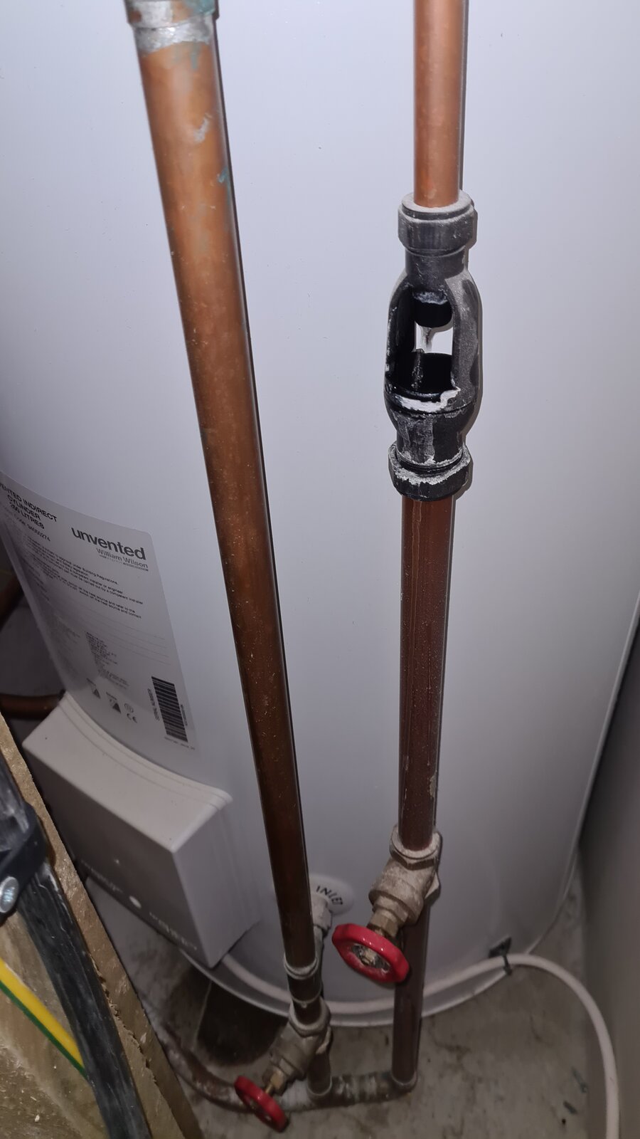

@Johntheo5 I'm not sure, it's quite boxed in which doesn't make it easy to figure out what goes where. I've added some pictures, hopefully makes sense
I'll also add that I checked the water temp coming out this morning and it's hot water.

Ideally you would install a Pressure Reducing Valve (PRV) onto your incoming mains and set it to 3bar. That pressure level will cause havoc with all the water fittings and fixtures in the property longer term. The Unvented is protected by it's own PRV but when it start to wear etc it can go out of calibration.
As suggested though, it's needs a qualified engineer to take a look and service the unit, part of that service should correct the issue you are experiencing.
