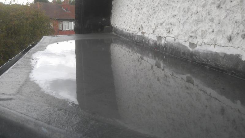

I'm after a second opinion a new GRP bay roof we've had installed. We live in a 1938 semi which had the original lead on the front bay and previously had a plug hole for water to drain out of into the gutter.
Because of the original design the roof had no natural pitch for water to run off the edge but rather water went towards the middle of the roof. Because of this I requested in writing "Ensure appropriate pitch to avoid standing water (water will run off into gutter)" which the contractor I employed translated to "Tilt fillet will be in installed upon the existing rafters allowing an appropriate fall".
The contractor has installed the new GRP roof but water is not draining off the majority of the roof and is rather running towards the wall of the house as you can see from this picture
The water was over 20mm deep where I can reach it from the ladder and I'd estimate at least 30mm deep in places. The bay is approximately 2.5m wide at the wall and I'd estimate around 10 litres of water was standing there when I tool the picture.
Obviously the contractor has not done what I asked him to do or what he invoiced me for but he's saying the roof is in good condition, the amount of water is small and since the roof has the 20 year Cure It guarentee I do not need to be worried.
I'd like to know what are the potential downsides for this amount water and given the builders reluctance whether it is worth pursuing the matter.
