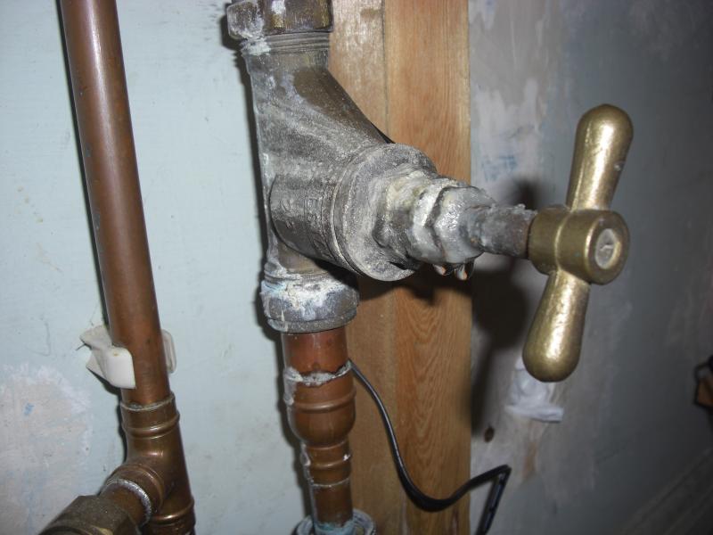

Water Stop Cock Leak
25 Dec 2005
229
Kent
I had to turn the water off in my home over the weekend to fit some new basin taps & I noticed that the water stop cock drips very slightly but constantly as per the pic. Is there a simple fix such as leak sealer or does the whole tape need replacing?
If just tightening doesn't work (probably will), then undo gland nut, wrap some ptfe around spindle and then retighten
Thanks for the replies.
Am I ok undoing the gland nut or will I end up with a big mess?
