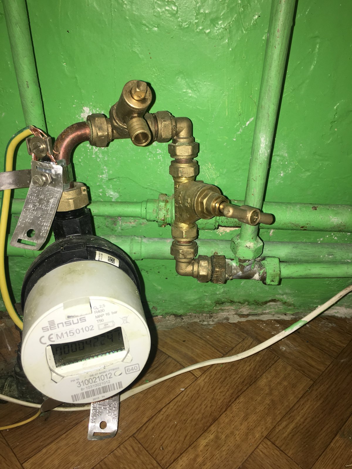

This is what under the kitchen sink looks like
so your stopcock is allowing water to flow into your house plumbing OK if loft tank had good pressure going in to it. i think the tank feeds some of your cold water outlets ( but not the kitchen cold tap which is on the mains ) and the pipes from the tank are airlocked.
