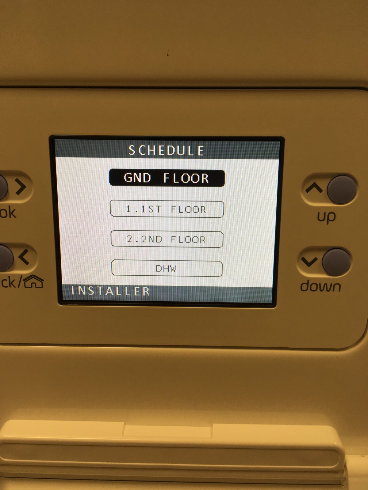

The Vokera evolve boiler will do what you want with either internet weather, wired or RF external sensor.
Fitted with BeSMART there's a 10 years warranty and an A+ ErP package rating for heating. Full remote control and boiler reporting and reset plus zoning if you require.
The WC setup you see explained below is embedded onboard with the REC 10 boiler interface however it is overriden by the BeSMART which has it's own settings that are not as flexible as those below unless you use it as a simple timed room thermostat without the full remote control option.
You get 7 years warranty on the boiler without the BeSMART as it's part of an incentive offer which ends at the end of December
I think Razor is correct in that the internal reference is a preference but ErP reckons 1% improvement and that will depend on the structure of your house. The parallel time reduction on a timer will handle that fine.
