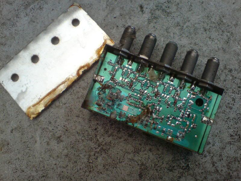

My mum's TV picture disappeared abruptly last night.: NO SIGNAL, according to screen.
Initially thought the cheap Proline box was at fault, as this a common fault with them.
Actually, it was this:
Silly sod of a builder had removed the chimney and resited the aerial but taken the Amp off the pole and left it hanging upside down....
For 6 months it had been collecting rainwater....
:rolleyes:
Not the first and it won't be the last as long as tradesmen do each other's jobs.
Well done for locating the fault. Provided one uses good double-screened cable from the aerial, the masthead amp can usually be located in the loft out of harm's way.
