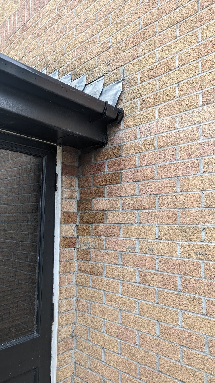

Recently moved in and noticed an area between garage and house that a few bricks looking wet. Not sure if this is ingress from rain
Going to take a look at the guttering and seal between garage roof and house later on
Any ideas? Picture below. Thanks

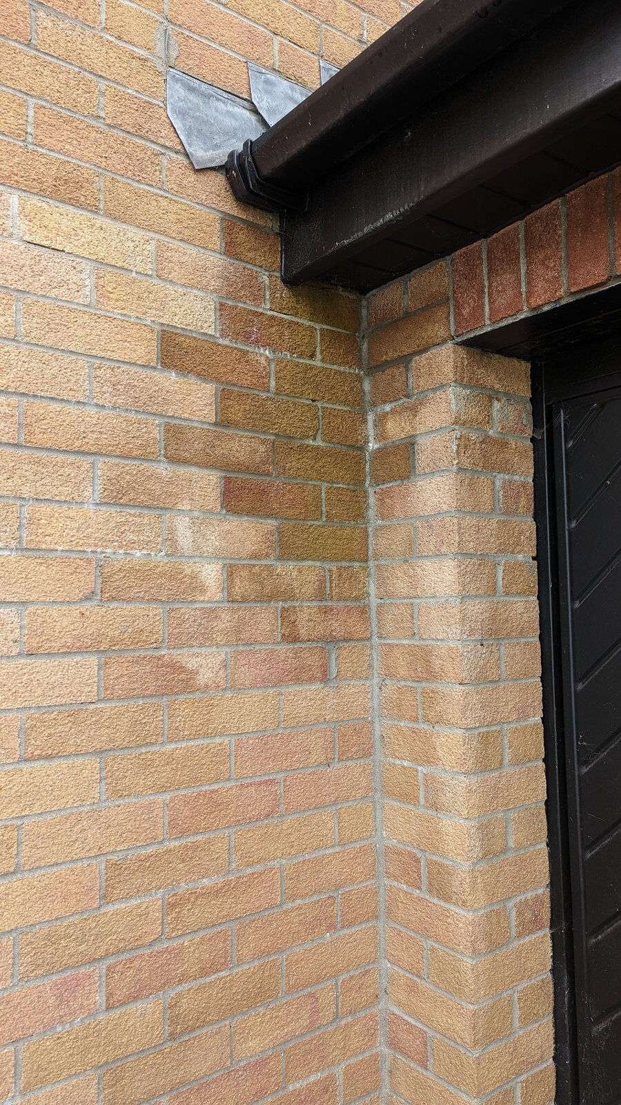

It also occurs on the front garage wall. Does dry out so I'm thinking rain related but hope it's not causing any issues

Well it is most likely to be the end caps for the guttering not sealing properly, but it could be the lead work at the bottom, maybe it is not helping to direct the flow into the gutter, it may be running right at the edge?

yeah seems to be below and around the edge of the guttering. Gaps etc so rain is getting through. Flow seems OK though, so maybe just poor lazy workmanship when the guttering got replaced

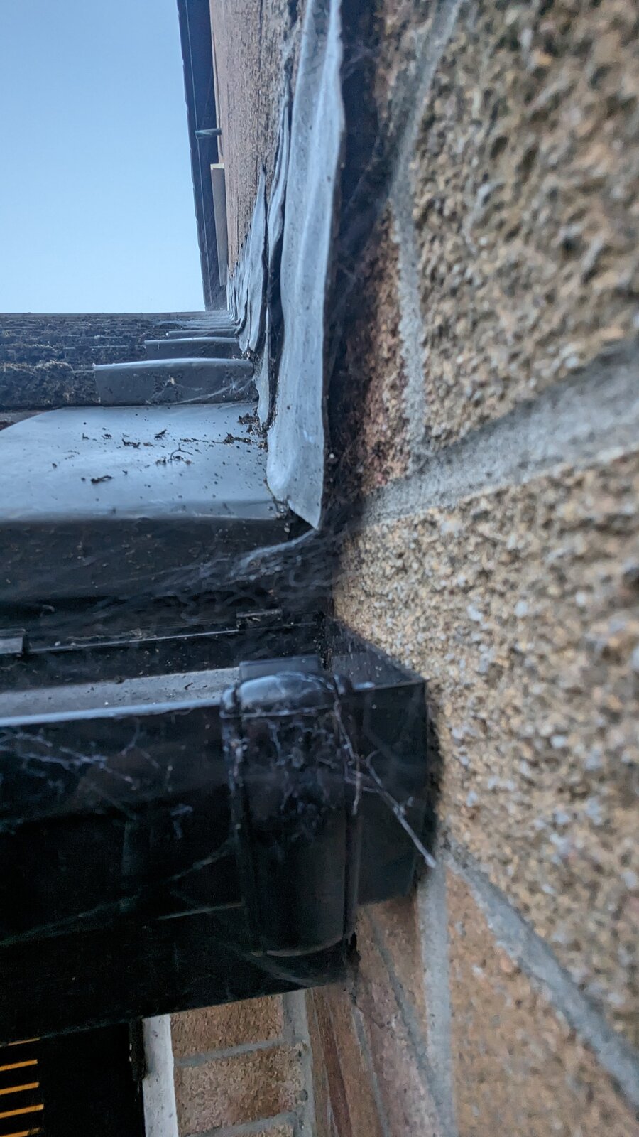

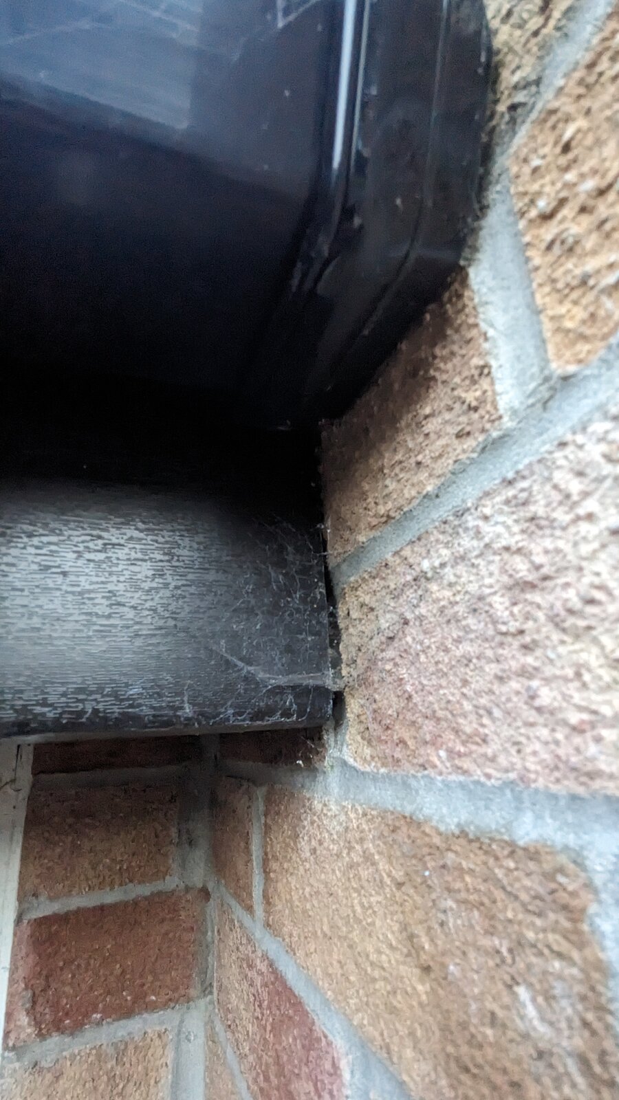

Taken a couple pictures of the gutter area. Not entirely sure what I'm looking at but there are gaps I'm happy to seal if people tell me they need sealing! Fyi downpipe for the gutter is on the other side of the garage

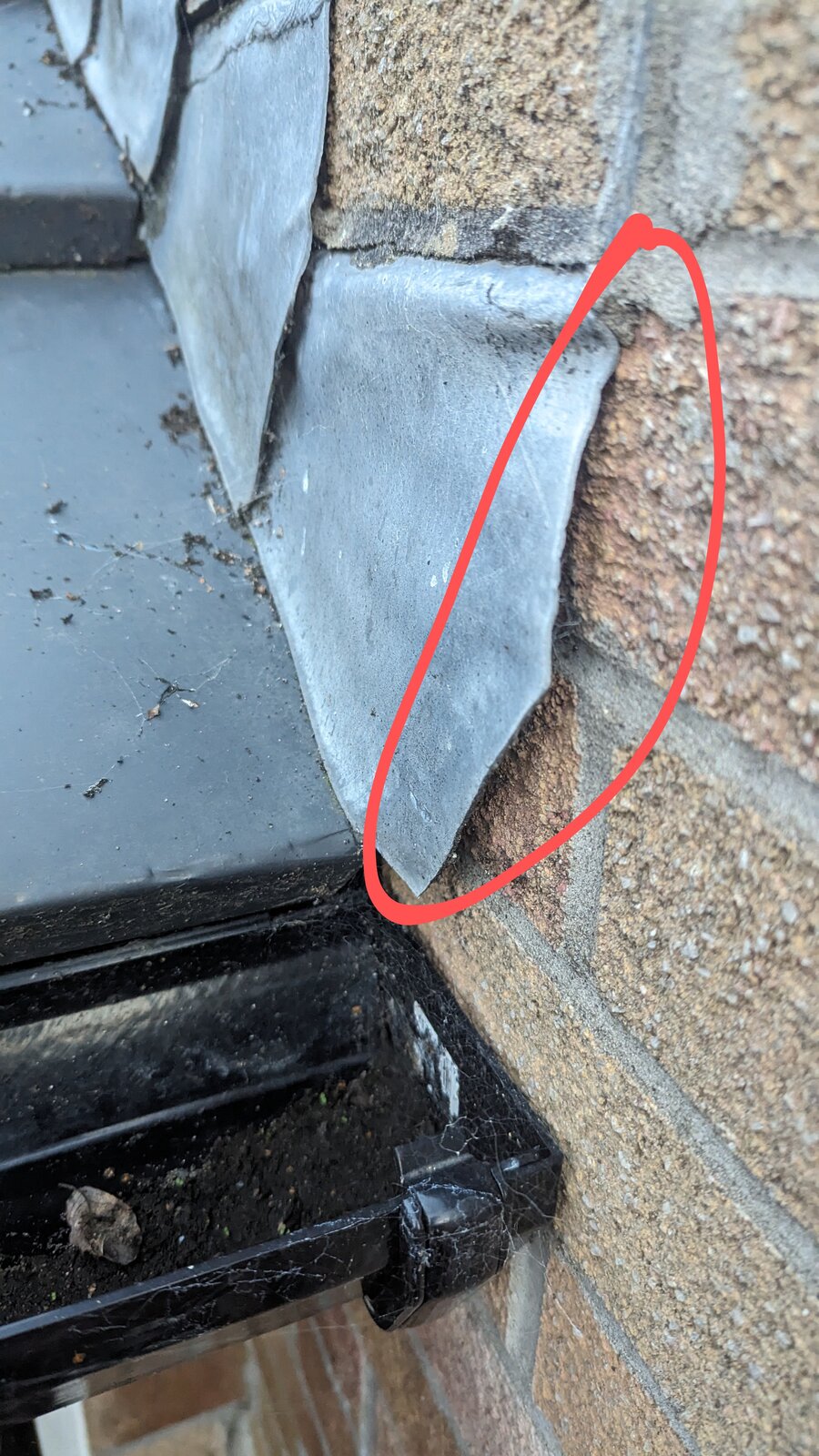

The lead work should deflect rain into gutter, your has a big gap allowing rain to flush against the wall.

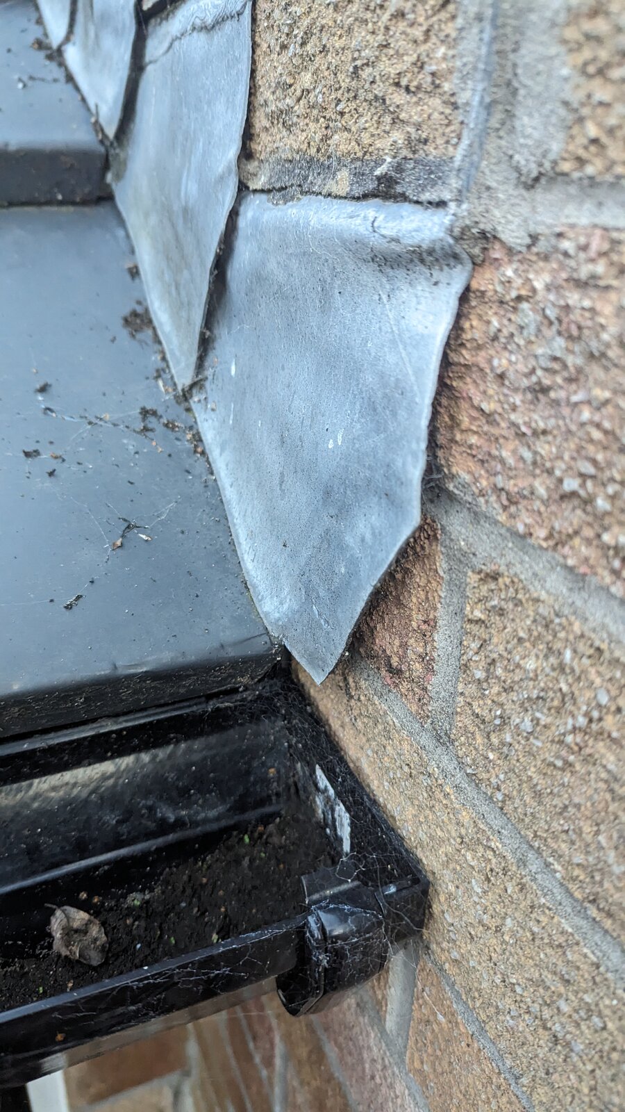

Okay, should I try and seal this section as best I can? Thanks

The gap underneath that section is the problem .
Presume you mean the inside edge of the guttering then? Will add something to that. The lead is going to gutter (had to reshape the end of it slightly as was going back on itself)
I haven't sealed anything yet as hoping shaping the edge of the lead back to the gutter might help.

Okay rain has landed so good time to update. I added some gutter sealant to the bottom edge of the soffit where it meets the wall, hoping this would fix the issue.
Unfortunately I am seeing water seeping from that area on to the brick.
What's the likely cause? Worried this will cause issues in the house soon
