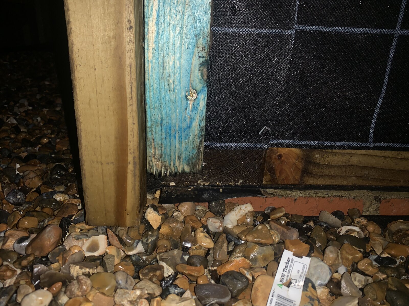

Issue I got is when it rains the wood witch I believe is c16 maybe 24 think 2x4 swan treated keeps getting wet on back left side when rains
Builder said nothing to worry once good weather back he finish roof and he’ll put a down pipe and back gutter in it
but I’m a little worried will the wood last or rot as a lot weight sitting on top
Sorry this is the wood I mean it’s sitting on bricks then vamp proff it’s on the left back corner think from the ground is higher there I dune a 20mm pea shingle all around the outside
It should be kept dry while stored. Throw a tarpaulin or polythene over it, but allow air under to dry it off.
The build is built I mean the wood on the bricks base ? Even tho it’s on the bricks and damp proff it’s still getting wet whe. The rain hits ground
I pea shingled around hoping it would help but the base layer of wood is still getting damp

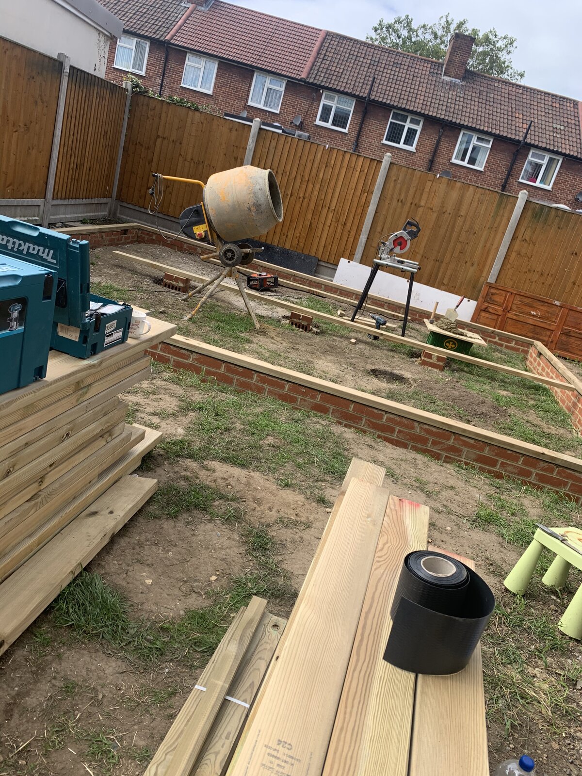

You've got a bad design there, and the bottom timber and cladding will be permanently damp.
There should be what is called a "drip" detail to make sure that water runs of the cladding properly and not soak the bottom of the timber or that bit of wall. Plus there should be no splashes off the ground that splash up the timber cladding - this is achieved by keeping the ground level low and making sure there is a good roof overhang.
Wood rot is caused by water, fungi, and warmth. Two of the 3 ingredients are missing, because they are out of season.

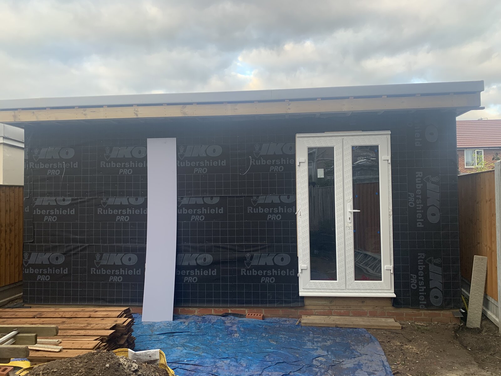

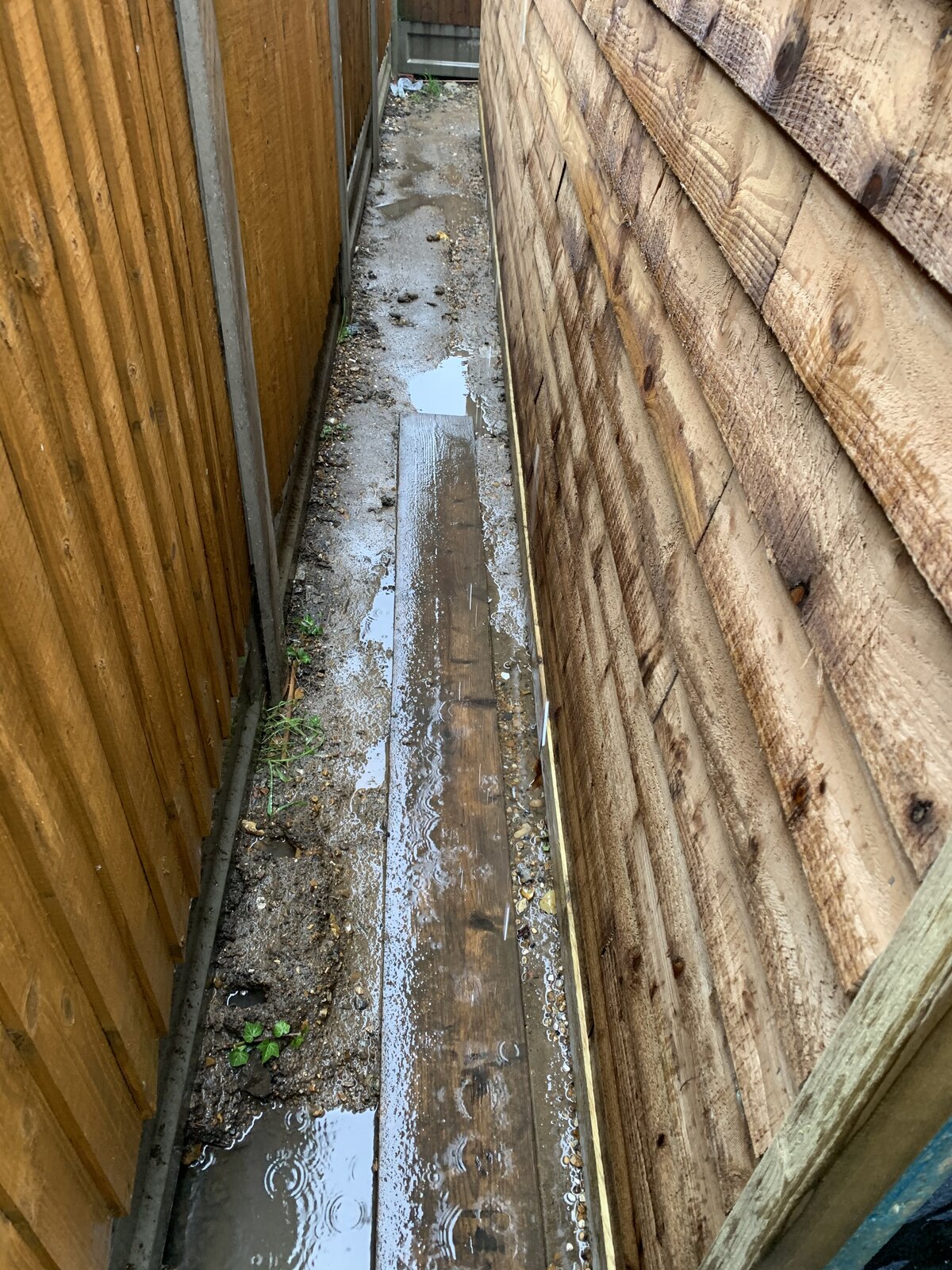

Just took a s quick pic to show just this bottom peice gets wet
will it be ok tho ? Or should I talk to him about it cause he said it be fine treated wood
Any timber needs to be at least 150mm above ground level, 200mm is better.
Treated wood is still not supposed to be constantly wet
Here is a good example of how it should be at ground level
