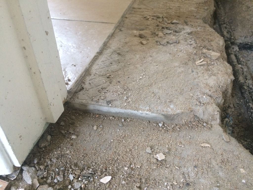

I've had to rip up the tiles in the utility room to replace a leaking pipe. The floor is concrete them with a thick layer of screed or something, about 2.5cm deep. With the tiles immediately on top of this.
As I need to fit new tiles on top at the right height, what is the stuff that they are laid on? Or what should I use this time?
I'll put photos up now in the next post
Whatever the top layer is, you can make up the height with a sand and cement screed, a 3:1 mix. Prime first with a slurry of 1:1 mix.

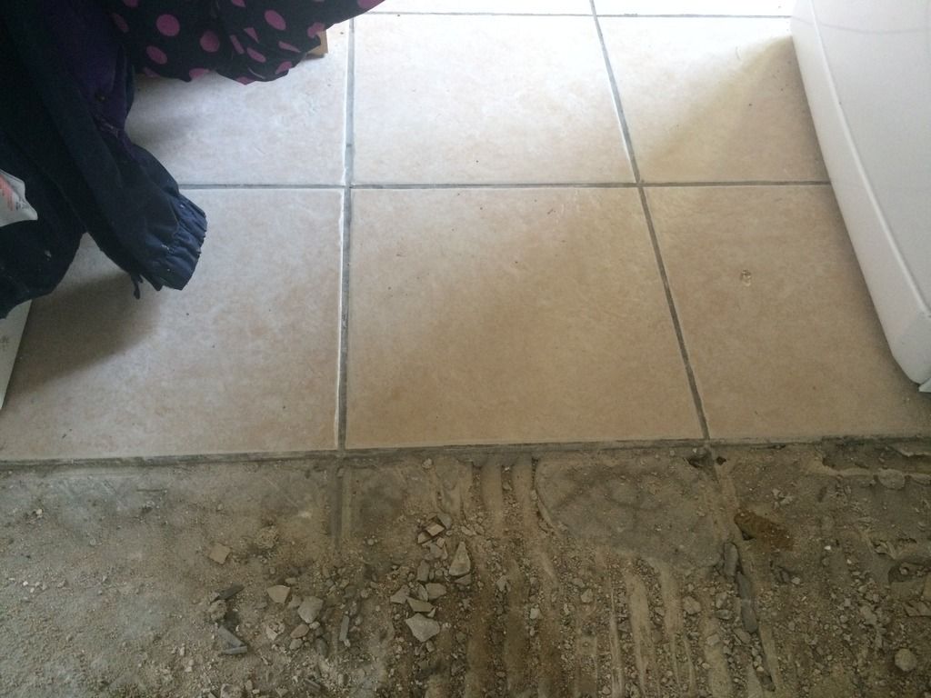

The floor doesn't appear to have any adhesive, just tiles on top of screed, shall I do a layer of screed to get the height and adhesive on that.
The impressed marks, and lines on top of the screed are the adhesive i'm referring to.
I've just told you how to build up to the old level.
You apply adhesive when you are laying your tiles - not before.
