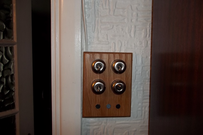

Fragile lath and plaster walls do not allow for cables to switches to be buried in the wall and surface mounted trunking is an eyesore.
A system of WiFi and "smart" lights was considered and quickly rejected.
Instead I used 12 core alarm cable and a few 12 volt relays to control the lights in my cottage
Five ON - OFF switches ( one on the other side of the wall ) and three buttons for dimming.
