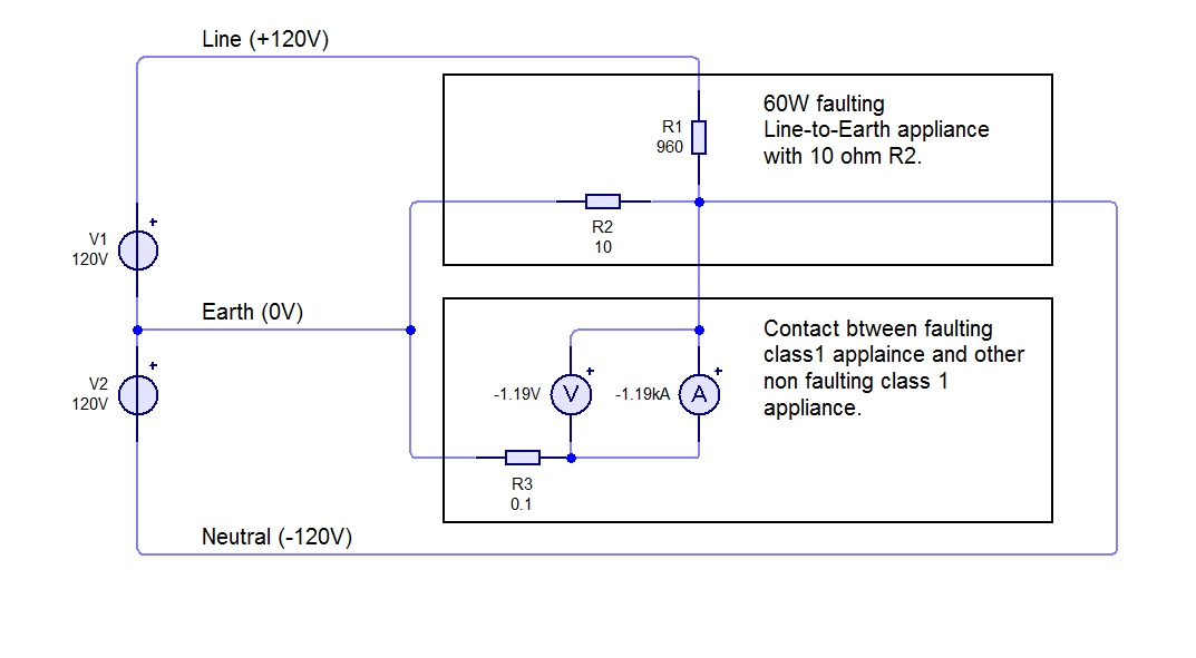

As long as the earths of every Class I item are bonded together you can't get neutral (which is really a line2) and line (should really call it line 1) both going to earth.
Appears your right, as the diagram below shows. Forgive the spelling errors in the diagram.
Realistic with 0.1Ω earth fault path through non faulting appliance:
Edit: Just getting overly confused now and really screwing things up big time.
:notworthy:o_O:censored: Laws of physics must be maintained and must not rely on what simulation programs say! I effectively was bypassing the voltmeter in my diagram thus getting 1.19V :notworthy::rolleyes:
1190(1.19Ka) X 0.1Ω = 119V - Ohm's Law
So now don't know if my diagram is realistic or not?
Major update: appears the earth is floating or nearly floating if that makes sense and is not centred tapped. Despite having 125V between N & E, the current draw between N & E is only around 1.5 mA.

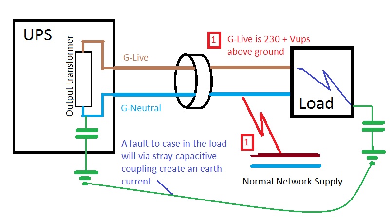

It is very basic thinking. The UPS generates AC power as a voltage between it G-Live and G-Neutral ( reason for G- will be clear later )
The current that leaves the generator on the G-Live ( or Line 1 ) must all return to the generator ( the UPS ) on the G-Neutral ( or Line 2 ). If the current on G-Live is not the same as the current on G-Neutral then some current is leaking away some where, that means there is a fault and possibly a risk of electric shock or fire.
So put an RCD sense coil around the G-Live and G-Neutral and if there is a difference the RCD trips and disconnects Live and Neutral.
If the only connections to the generator's output are G-Live and G-Neutral then there is no other path for current to return to the generator. That means that no matter what G-Live or G-Neutral come into contact with the current on G-Live at the RCD sensor coil will always be equal and opposite to the current on G-Neutral and therefore the RCD will never trip.
G-Live or G-Neutral could come into contact with ( normal ) Live at 230 volts and still the currents will be the same but the UPS output and the circuity in the load will 230 volt plus the UPS voltage which will mean either G-Live or G-Neutral could worst case have peak voltages of 644 volts ( (230+230)x√2 ).
It gets difficult when stray capacity and other un-avoidable sneak circuits as shown in green have to be considered.
The fault to network Live (shown in red ) would via the stray capacitor in the UPS create a fault current along the G-Neutral and thus possibly trip the RCD but only if the stray capacity was large enough to pass the tripping current of the RCD ( 30 mA ) That trip would protect the UPS but not the load.
The fault in the load ( shown in purple ) would via two stray capacitors create a ground current and thus also a difference in the current in G-Live and G-Neutra and may trip the RCD depending on the size of the two stray capacitances in series and the ground impedance.
Creating a low impedance path from the UPS output to Ground would ensure the fault current in both cases would be higher than that via stray capacitance and thus more likely to be enough to trip the RCD.
The short between G-Neutral and network Live may seem improbable. Consider the situation where automatic change over switch is installed without ensured break before make durin th change over.
