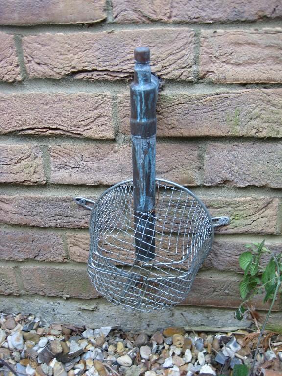

Hi All
Removed a box section the living room - was really bugging me! :D
Found the pipe in the pictures below, it has marking which say its a 28mm pipe - but its empty? I.e. nothing flowing through it!
I don't know where the pipe starts from, but it comes through the floor space up above the living room ceiling, down the wall, then outside to what looks like an open end? Could it be an overflow for something? Nothing recently has come out of the pipe that I can see but it does look like something has flowed through in the past?

Any ideas? I'd really appreciate knowing if I can route this on the outside of the wall so I can get the wall plastered.

Ahhhhh! now that's a good point, that would make sense with the Heatre Saudia Megaflo water system right? That's unvented as far as I remember.
In that case, would there be any danger with poking it outside closer to the ceiling height of the living room? It would still be below the bottom of the hot water cylinder. See any probs with that?

It will make for a dangerous shower ! :eek:
Leave it as it is.

as long as you run it down to low level it should be ok
I can't see any obvious problem with taking it through to the outside at ceiling height, however it might still have to be run down the outside wall to ground level to prevent the potential of dripping hot water on anyone passing below.
If you can get hold of the manufacturer's installation instructions from their website, then there's likely to be guidance in there.
When a condensate drain pipe from a condensing combi is run in this way, then it's usually necessary to either insulated the pipe or use a larger diameter pipe to prevent the water freezing - not sure whether the same would apply to your discharge pipe (as it's not in constant use like the condensate pipe), however it might.

Just ensure you don't reduce pipe size, keep it 28mm.
Guys you are the best.... thanks so much for all the advice and help, I'll give Heatre Saudia a call and ask them what I can and can't do with this pipe now I have an idea of its origin!!!!
If you cannot see any problem then you are obviously not qualified to install unvented cylinders!
Its not just a case of a little "dripping" ! Under a fault condition it could be 30 litres per minute of boiling water !
To protect people against any hazard there are very strict requirements in G3 of the Building Regulations. These cover pipe sizing and the requirement for the pipe to be in metal ( normally copper ) and where the pipe actually terminates to prevent any risk to passers by or children playing.
It looks as if the pipe indoors is in plastic? If thats the case then thats wrong and in the event of a fault there would be a serious risk of the plastic bursting and injuring somebody indoors.
Only a qualified person should work on unvented cylinders.

Q can i use plastic pipes to carry the discharge ?
A
Yes, provided it is a high temperature plastic and rated to withstand a minimum of 101°C.
However, the use of plastic pipe is not specifically mentioned in the Guidance to G3. Approval for its use should be gained from the Building Control Officer. Ultimately the BCO is the final arbiter of what complies or does not, we can only offer advice.
the manufacturers
can't be wrong :)
Adequately rated plastic discharge pipe at 32 mm CAN be used after a fanney trap and as far as I am aware without needing specific BCO approval.
However the fanney trap was not available when the G3 regulations were written!
