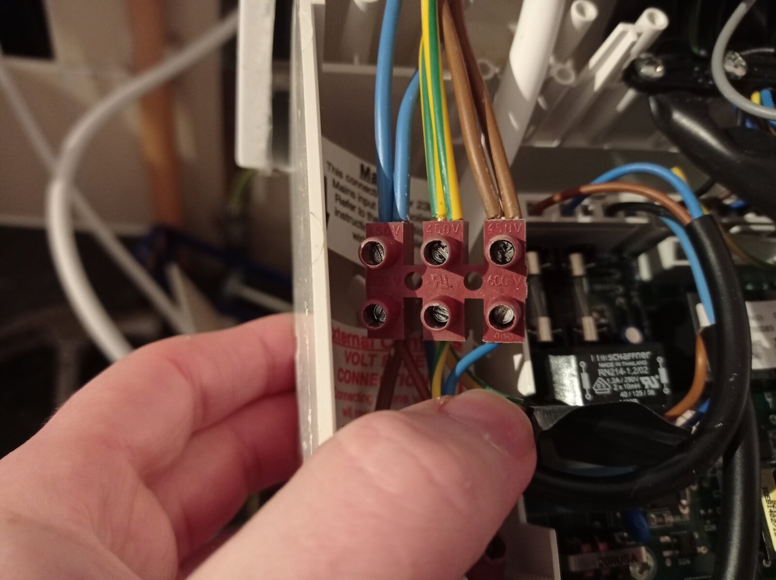

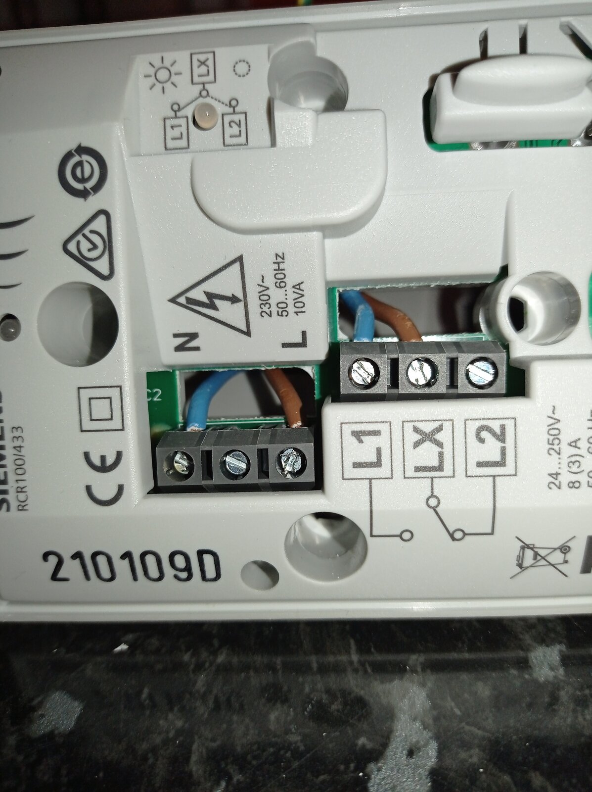

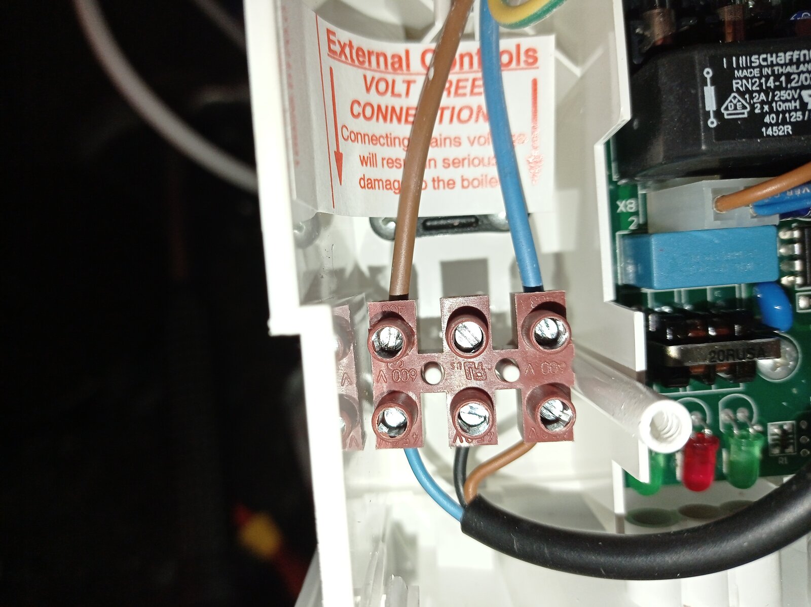

Here are a few pictures of how I've wired it:
This is the wireless receiver. The L and N are piggybacked from the mains to the boiler. L1 and LX come from the external controls side of the boiler.
This is the mains to the boiler. One cable is from the fused spur, the other goes to the receiver.
This is the external controls in the boiler. These go to L1 and LX in the receiver.

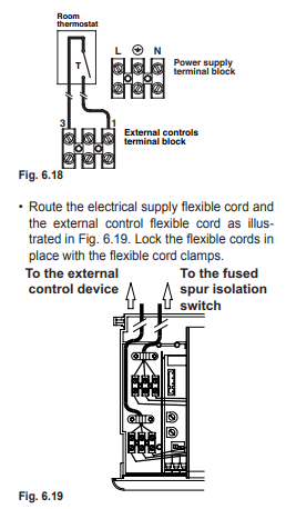

The wiring looks to be correct. Power from L E N, and thermostat contact to 3 & 1
Is there an existing timeswitch somewhere? Perhaps part of the boiler? If so that should be set to be permanently on, assuming of course that your new Siemens thermostat is of the programmable type and incorporates both time and temperature control in one unit.
Are there any other devices connected? An old programmer or stat? Are you able to trace the entire cable from the boiler to the receiver? As suggested, temporarily link the control wires and see if the boiler fires up.
I am not an electrician or boiler dude but the last picture shows brown and blue connected to each other via the chocolate block (black outer cable)?
It doesn’t matter in this application. Blue and brown are just colours, the stat connection to the boiler is what is known as “volt free”. The label on the boiler tells you that.
Fair enough but made me wonder and to be frank scared the sh*t out of me :D

except it's wired N E L and not L E N as indicated by the mismatch of wiring colours and the shown wiring installation note.
I admit my first reaction when seeing the pic was :eek:, I made the guess the blue was likely to be neutral for the thermostat heater.
In my opinion a silly selection of wire colors within the boiler.
Indeed! sorry folks don't know how I missed that :eek: :oops: either need to go to spec savers, or stop looking at the pics on my phone.
I looked at the top connections to see that the new thermostat was connected to the incoming 230V supply correctly which is is. It's the original boiler connection that's wrong.
@anthonyseoul1 you need to rectify that.
