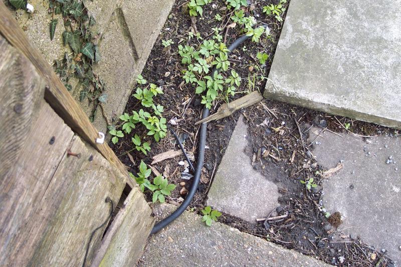

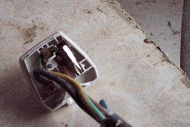

Couple more pics - just for folk's interest!
Notice the fuse in the plug - this was in a socket in the 'wash house' kinda shed out back - it goes through the sheds and the under a slab outside - wandering up the garden to the garage....
