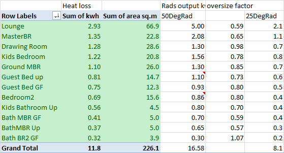

- I did room by room calculation and heatloss was ~11kw for 12 rads (big and small). I don't use all the rads (for guest beds etc) but 4 big rads, 3 bath rads and a fan coil unit runs all the time.

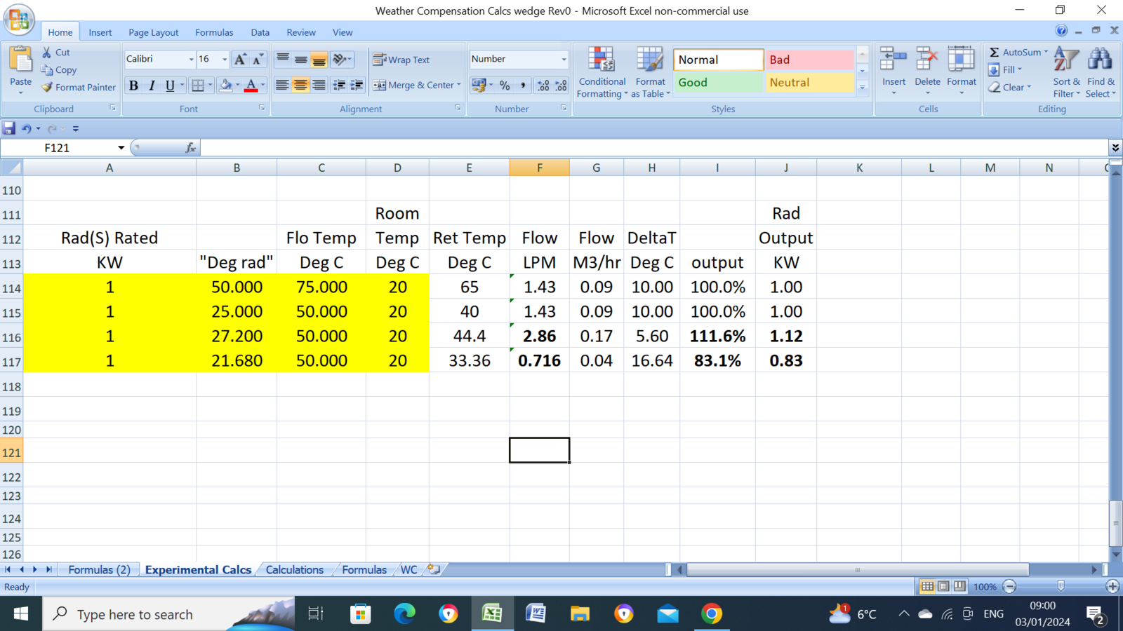

The table is a bit confusing, the sum of all the heat losses comes to 11.8kw, then shouldn't the T50 sized rads outputs sum to the same and not 16.58kw??, the same applies to the T25 sizing, the oversizing factor for each rad should be (50/25)^1.3, 2.462?, and the sum of all these should come to 11.8kw when run at 50C flowtemp and not 8.1kw.
At a room temp of 20C a T50 rad will give 100% output with flowtemp/returntemp/dT/flowrate of 75C/65C/10C/1.43LPM (per kw rad output). the same rad(s) oversized by a factor of 2.462 (say 2.5) will give the same output with flowtemp/returntemp/dT/flowrate of 50C/40C/10C/1.43LPM.
Correct.
My rads oversized and I have stated the name plate or stated output of the rad in this column.
The next column is oversized factor which is 'Heatloss divided by stated output'
Correct. I don't know the return temp to boiler but flow temp of boiler is 49.5DegC. Rooms get to the temperature after an hour of boiler startup. A normal thermometer tells mean water temperature of 37DegC in a radiator so I am guessing my rads are 30DegC. what do you think?
What boiler return temperature are you getting
I have felt the return pipe on boiler which seems cooler; my best guess is it in early 40DegC but it is just a guess have not measured it. I have collected condensate from the drain pipe and it measured 1.5 litres per hour of condensate at this flow rate which tells me that it is condensing.
I am trying to get the efficiency numbers but they are all over the place as it is difficult to get the true gas usage for CH only due to stove and hot water usage.

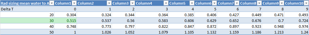

For rads output at different flow rate I use the attach table which is roughly the same as you stated in your post. So in my case I just multiply the T50 rad output with Rad temperature rating e.g. 51.5 in my case hence the 8.1kw number I am getting in my spreadsheet against 11.8kw of heatloss. I hope it makes sense?

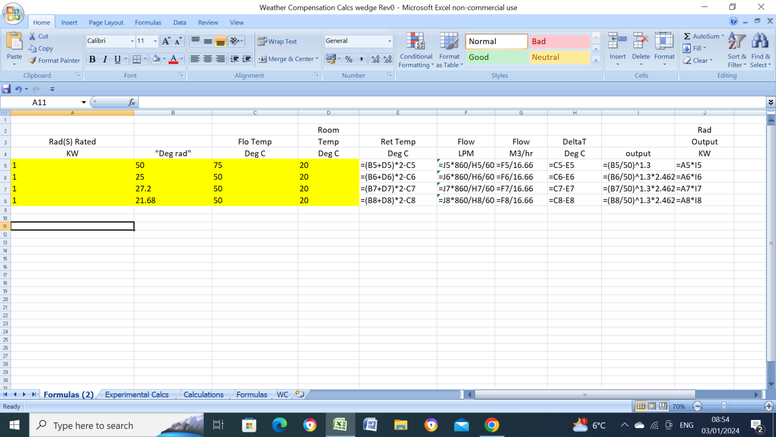

I can't post files on here but you can easily build your own spreadsheet(s) which will be 100% correct.
As you probably know you just configure the first row and then copy and paste for any required extra rows/calculations required.
I have showed the effect of doubling and halving the flowrates on a "T25" rad with a 50C flow temperature.
