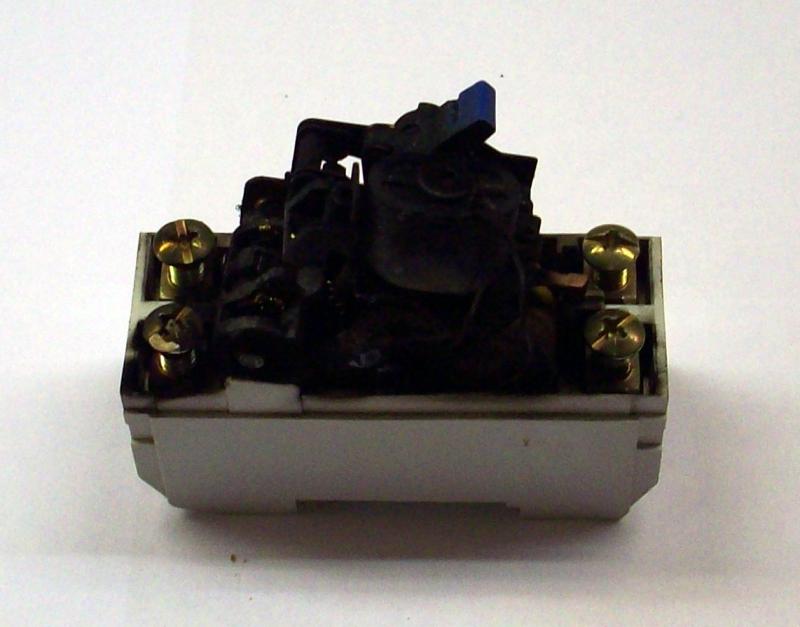

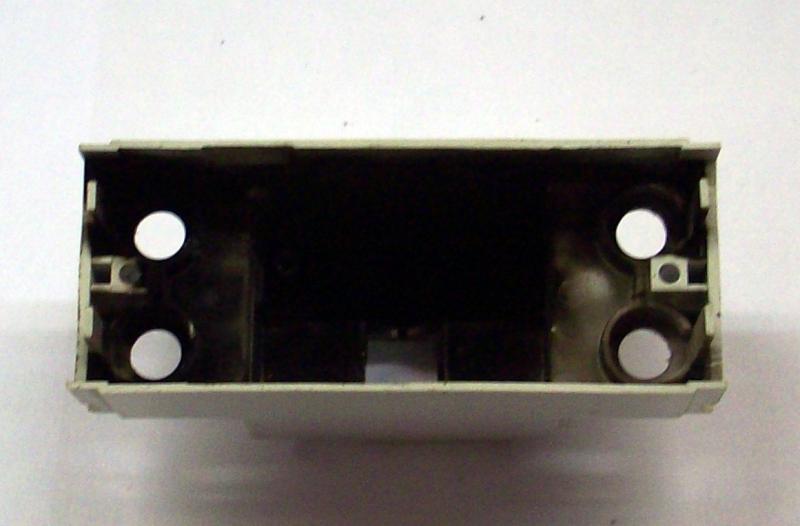

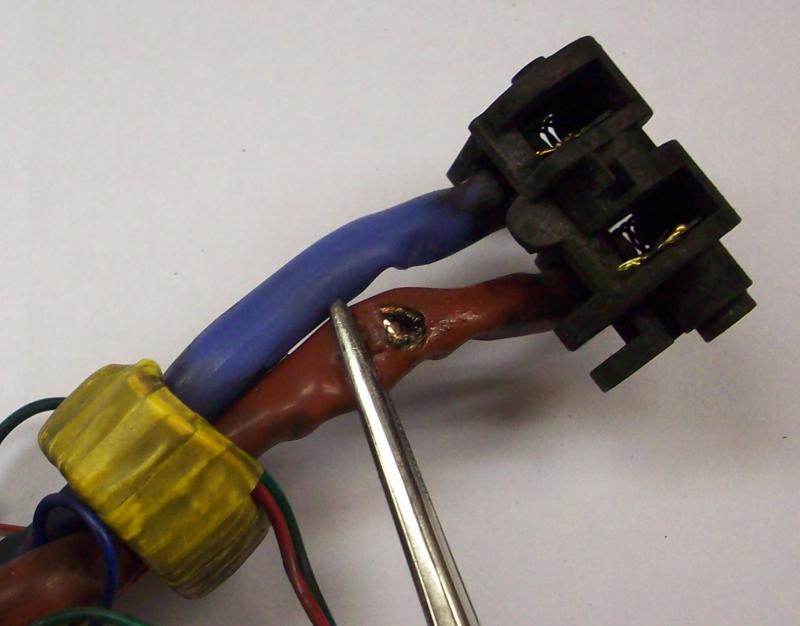

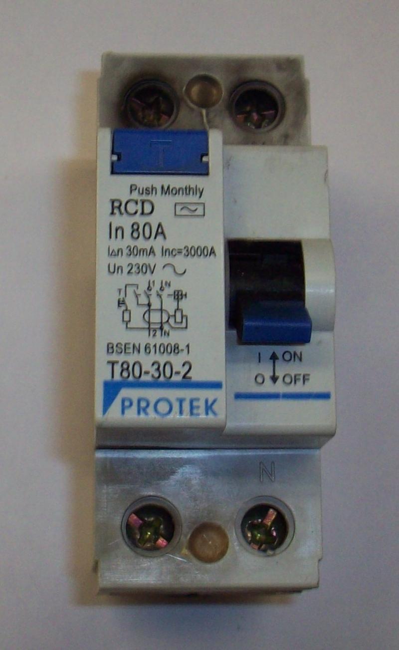

I'm not sure whether you were around when I reported what happened to an RCD in my daughter's CU when she pressed the test button (unfortunately, she's now saying "never again"!) - a very loud bang, a cloud of black soot and a blown 80A DNO fuse, but the RCD still looked essentially intact (externally!):
... and the cause was this - the insulation obvious managed to get chopped by something when the mechanism operated:

Perhaps that and with John W2's RCD it shows that the enclosure has done it's job and contained the blast.

All does not looks good but ……. Protek ?????? ... I would have expected a quality brand from you John!
'Twas not me wot installed it, m'lud :)
However, I wonder which you would have considered 'worse'- my having installed a Protek board (which I didn't do) or what I actually did (on a rapidly darkening Saturday evening, to get the installation back on) - namely replacing the RCD with a Wylex one (and I won't mention the tweaking of the busbar that was required!), given that Protek RCDs are not something I keep on my shelves!
