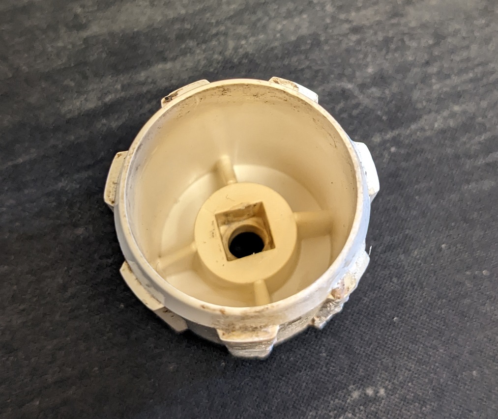

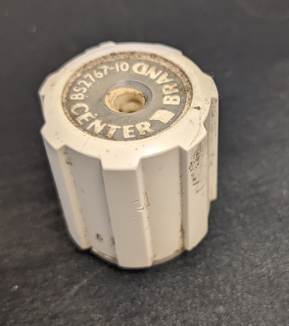

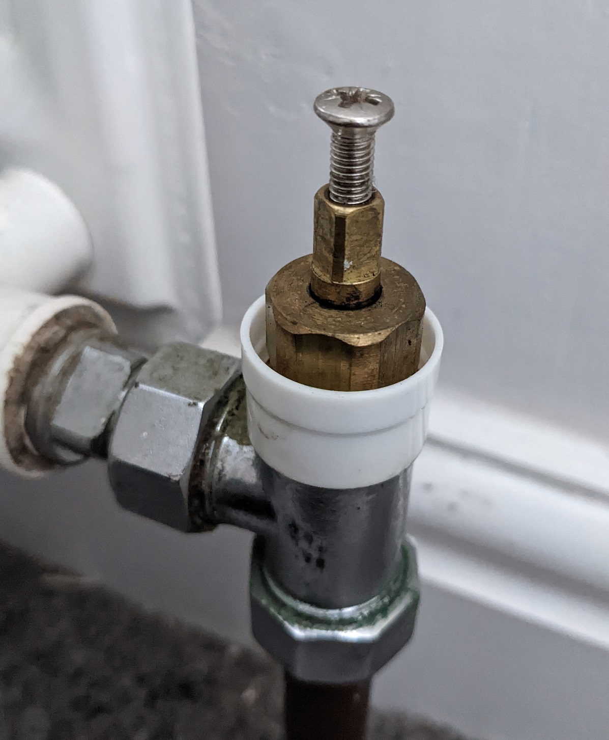

Hi all,
Looking for replacement caps for lockshield valves in my house. The existing ones are labelled BS2767-10 Brand Centre and have a square fitting with a securing screw, and on the valve itself seems to be some sort of plastic sleeve which I can't get off (at least, didn't want to try too hard in case it broke).
Pictures attached.
I will need 8 of them.

They are wheel head valve tops, allows the valve to be turned on and off, lockshield covers just sit on top and don't allow the valve to be turned.
You may struggle to get one with the same size of square to fit the spindle though they do look like wolsley centre brand ones .
th
You do get universal ones with adapter plates.

Tried searching for those terms plus more, I'm not finding replacement caps for sale anywhere.
I saw those yeah, don't really want blue lettering all over the top of my radiator valves though.
Spray the tops white
This is the link to the tops I posted -
Though the link doesn't seem to show much - might be an idea to give them a call and see if they stock them or not.
Otherwise it'll be a generic universal top or a new valve.

Yeah the link works but then try to add to basket it errors. I'll email them. I emailed another company that had the pegler valves and they came back to say that was old picture and no longer stocked.
They are definitely re branded pedlar terrier
