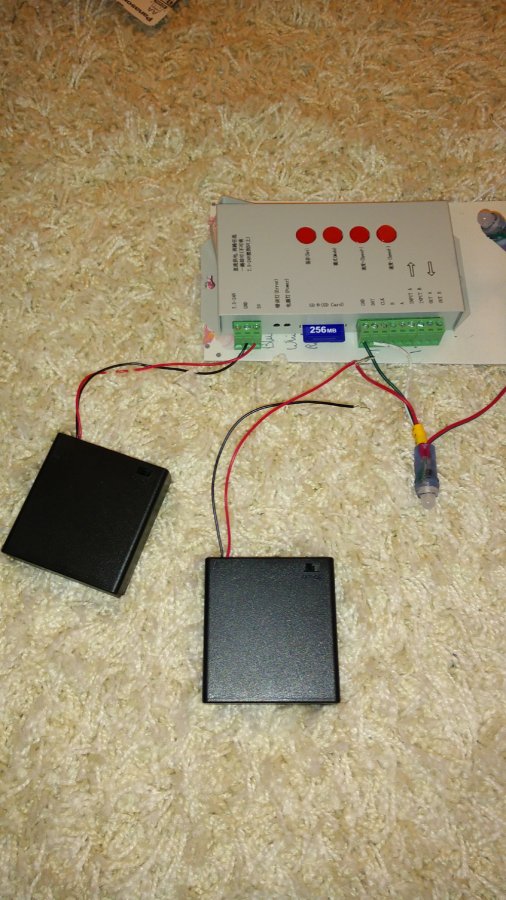

The kit has arrived, but at present I'm stuck when trying to get this working with two possible scenarios - though I have a feeling I should only concentrate on getting scenario 1 working. If you could possibly review the two attached scenario pictures, especially scenario 1, and give me your thoughts, that would be great. (see attached pics)
Scenario 1
(see attached picture 'scenario1.jpg' )
The Data and GND from the LEDs are connected to the Data and GND on the T1000S.
1x 4.8v power pack (Enloop pro) is plugged into the 5V and GND at the top of the T1000S
1x 4.8v power pack (Enloop pro) is plugged into the red 5V power line of the LEDs.
I'm not sure where the negative line should be connected from this power pack?
Scenario 2:
Powered with one battery pack only:
(see attached picture 'scenario2.jpg')
The power line of the LEDs are also connected into the T1000S power.
The result for scenario 2, is that when the controller is turned on (with sd card already inserted) the power light stays on, and the Error light comes on for 1 second only. (I assume the controller is initialising). Then nothing happens. If I press the MODE button on the controller, the Error light flashes once, for about half a second.
Why not as per the wiring diagram in the manual? (The RH side - the left looks a bit dodgy).

Good success this evening - spotted I had got the Data and GND lines the wrong way around (after I looked closely at the PCB markings on an LED through the frosted plastic). I've since been able to run 150 LEDs + controller, from one 4xAA battery pack. I grounded the end of the LED chain back to the controller to get an even distribution of power. Worked well. On the weekend will find out if the 4xAA's can handle 300 lights, and for how many minutes...
