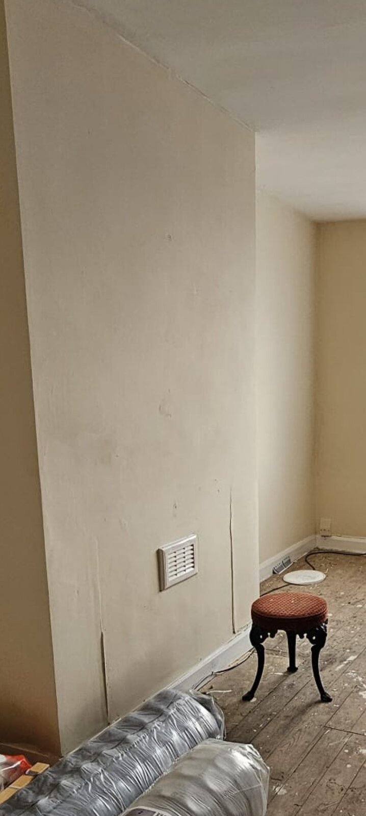

So as some of you guys may know I'm about to fit a socket behind the TV on the chimney breast.

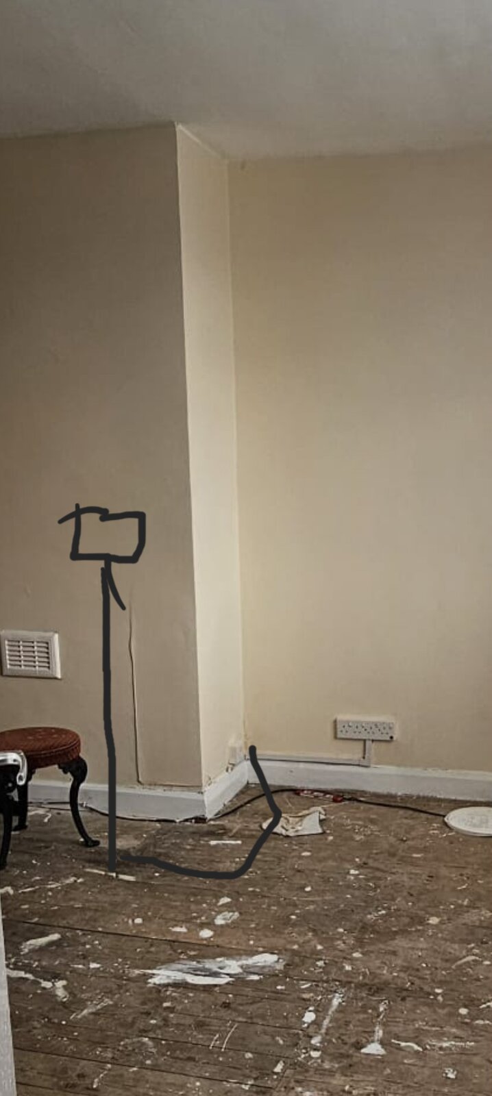

Thank you...I will be chasing the wall to hide the cables.. then take it under floor boards make holes in joist and take it around to the side of the chimney breast and put it in the switched fused box which is spurred of the side socket.
As per this picture. So I will need trunking or conduit for the t and e cable. Which side would I need ?
Ah, no picture. Do you mean size, or side?
Are you extending the ring - that means two cables - or running a spur?
please reply to my earlier query
Sorry its here.
