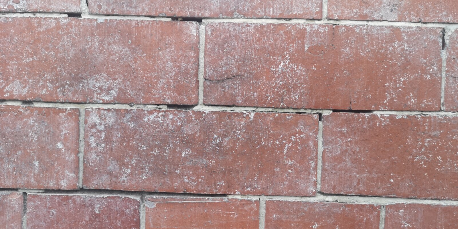

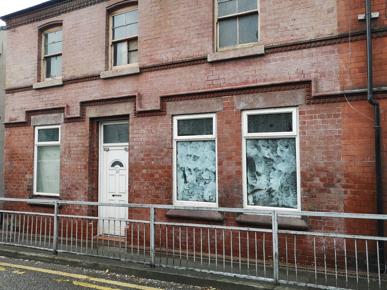

I Cleaned some tyrolean render off some engineering bricks and its left a residue on the brick, I have used brick acid, thinners, turps, wire brushes and nothing moves the residue, has anyone had any experiences like this.

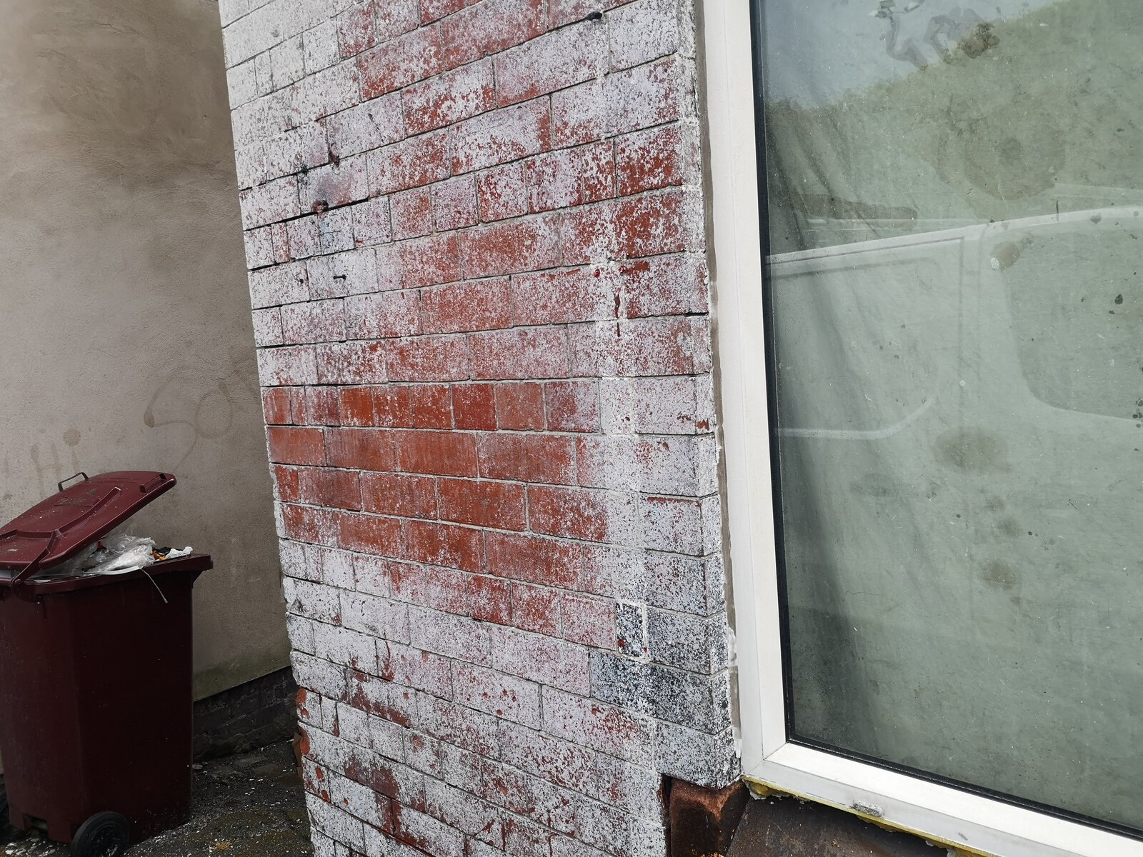

Hi footprints, no I am quite sure it's not, it was there when I took the top layer off with a scraper, then alot of hard work mainly with stainless steel scourers.

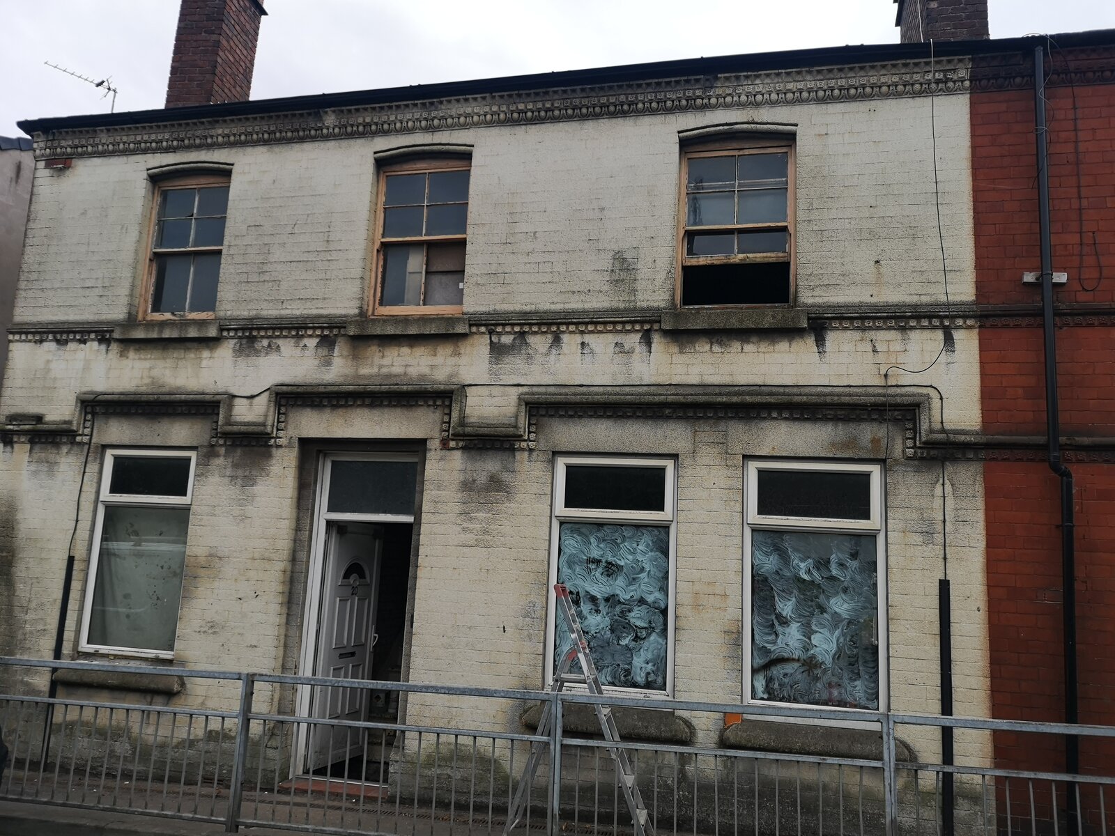

Your pics dont show any Tyrolean only a thick coat of paint.
Thats not efflorescence mate its the resideu from the paint you scraped off.

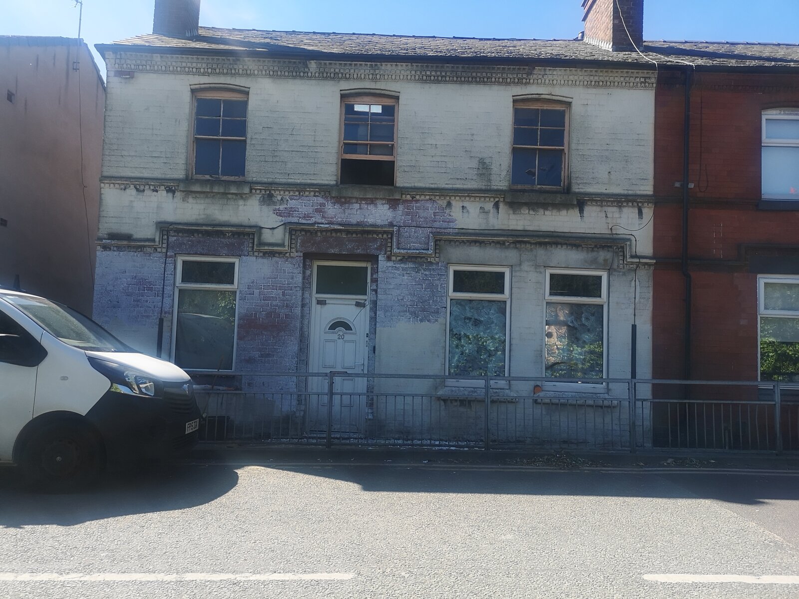

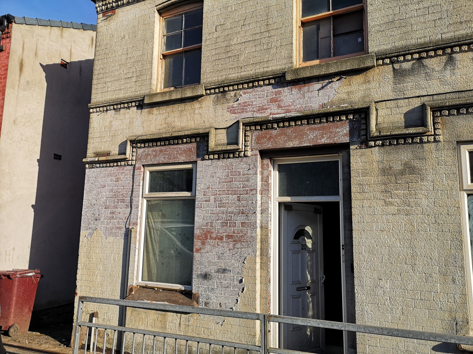

I hadn't seen the 2nd set of photos when i posted earlier. Are you sure this is render and not just the remnants of paint?
my advice is to get a steam wallpaper stripper £20ish I think. steam the marks and if you can get any movement from them then steam is the correct way to go. the steam cleaners aka torik are very gentle because its 150c but low pressure so won't damage the bricks.
Try a few bricks with a hot air gun. It looks like paint or a glue residue from under the tyrolean. As others have said be careful with pressure washer or blasting as it can damage the mortar and brick. Ended up myself having the front of my house meshed for the new rendering as it would of been too risky on the old brick.
