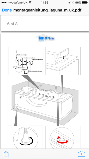

this is the setup, see attached image. thanks in advance.

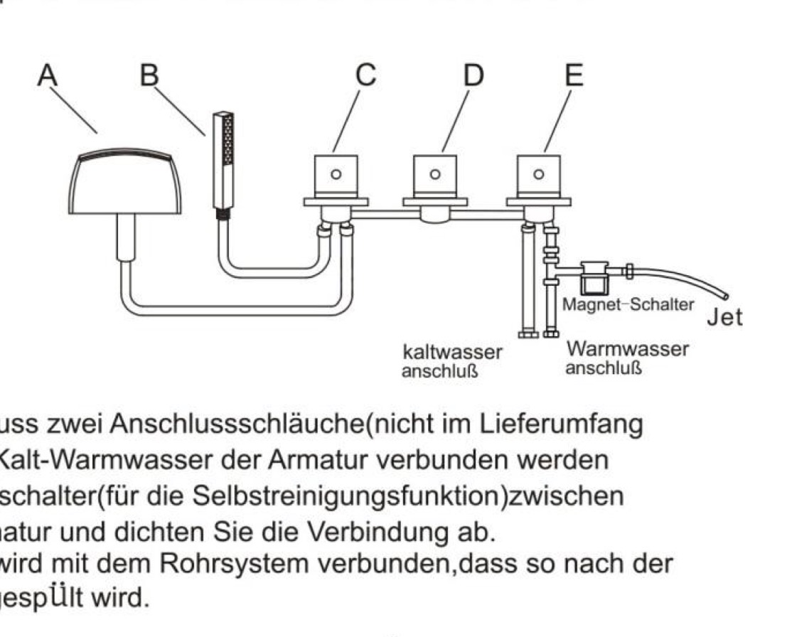

please refer to this onc, not my last image of the setup!

Do the taps have flexible tube?

Do the taps have flexible tube? – yes ½ inch, a quite a few of them, see above image “img 8680”
Insufficient hot water pressure on hot water, the taps is unsuitable for low pressure system which is the hot water system.
You need to find out the spec of the taps to see what working pressure need to make it work.
Either a combi or a booster pump for hot water will solve it. Flexible tubes does'nt help either.
