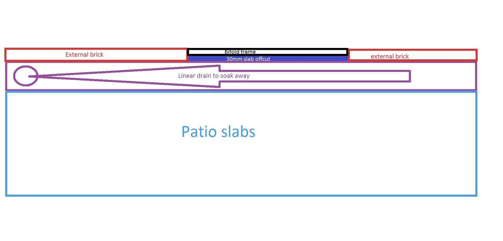

I was thinking…
Part of my extension will mean I will be removing a down pipe. I’d like to install a drain against the back of the house, including under the bifold. This drain will run to the down pipe.
As the frame will be set back approx 30mm from the brick face, I was hoping to fill the gap under with some of the patio slab we will be having.
here’s a birds eye view of what I’m imagining.
