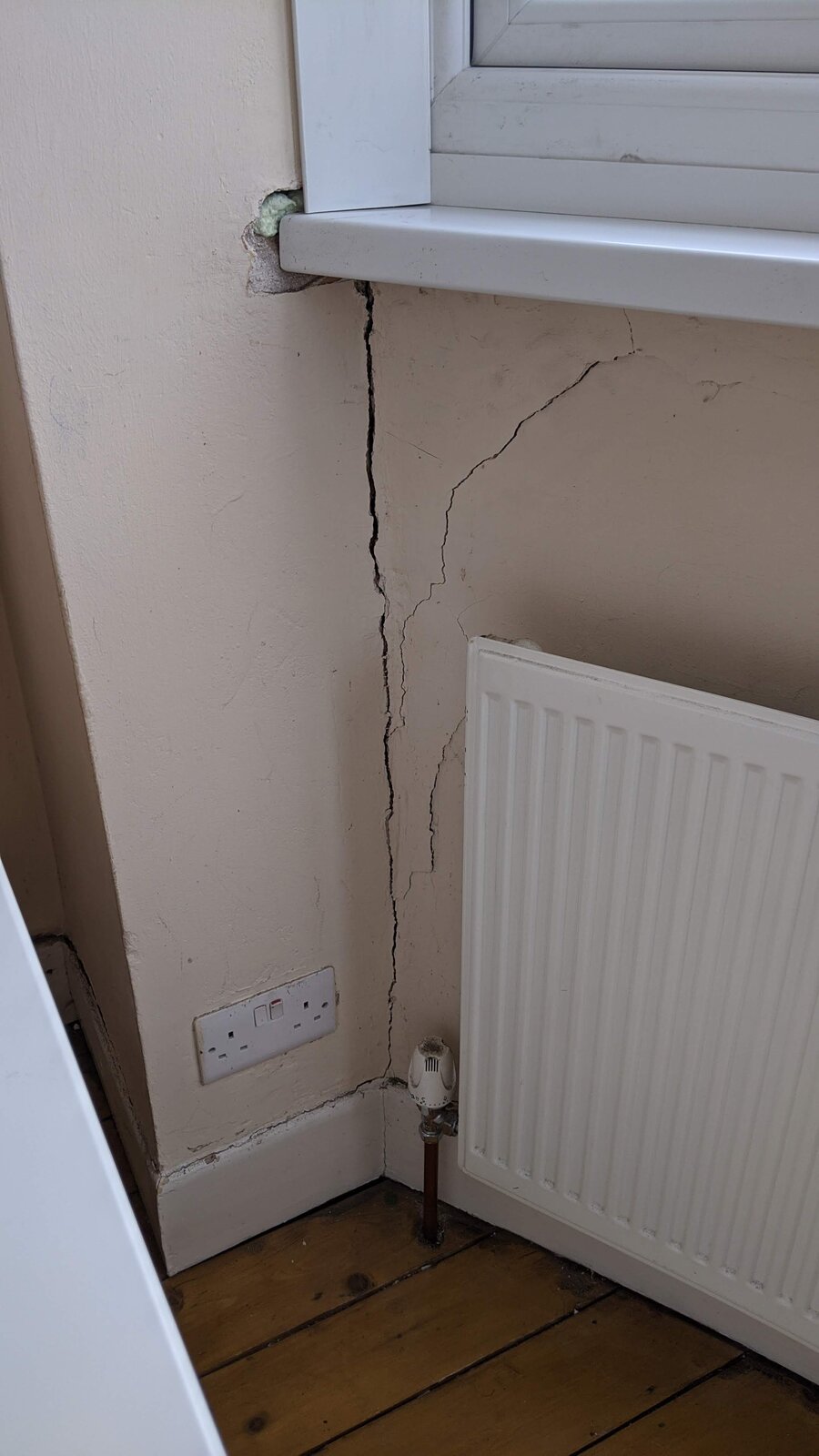

Morning all,
Having UPVC windows fitted this week. Which is more stressful than I'd hoped. :( On the unpredictable times they have turned up, it's all felt a little slapdash. Luckily I'm paying on completion... I'll spare you the little snags but... oh boy - the upper bay window...
I have a theory as to why this has happened. Please see pics. There was a very small crack before but it has just got huge on both sides.
But what would you say re the cause. And should I be worried. Well I'm worried obviously, I'm just trust to gauge how worried :sick: And im guessing it may well keep shifiting.
And should they be putting it right?
Any advice/thoughts gratefully received.

An outside pic would be helpful.
If you already had a crack, that might've gone all the way through the block work and the rip out might've disturbed it.
It's hard to know if they are at fault, if the masonry was already unattatched it's not surprising it moved.
Is that Single skin below the bay?

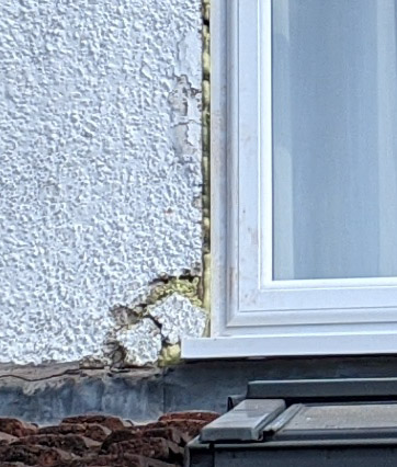

Hi there - not sure is it single skin but yes a big crack on outside too both sides. Will try and upload a pic.
Just concerned they didn't prop below sufficiently.

OMG! It looks as if it wasn't supported at all as the frame below it was removed. I don't know that much about UPVC frames, but seem to recall reading somewhere that they often have to be special structural frames where the original frame took the weight of the structure above.
I would expect some minor cracks from shrinkage over many years, but that is major and needs to be expertly addressed quickly with proper support and repair. Any reputable window company should be aware of what will be needed, though it seems not the company you employed.

You need to look at the original order to see if there was comment made about the bay window. Hopefully they made the window for the lower bay to support the upper bay brickwork. They should also have supported the bay before they removed the lower bay window (Props between floor and ceiling inside the lower bay).
I expect the lower bay needs to be remade with the strength to support the brickwork above. The Upper bay made need to be removed and rebuilt properly.
Hope the window are prepared to put it right at their cost.

Thanks very much all. Well it was minor crack for sure, and again i don't have an issue with a bit of a crack or fixing up some plaster- its just that that has gone form small crack on one side to massive cracks opening up on both.
I feel like they went at it like a bull at a gate with the drill and the day the lower bay was fitted, it was only one fitter on site, the other guy didn't turn up that day, and he used one acrow prop and now I'm thinking that it needed to be better propped at this point before the bottom bay was removed.
I've had look at the Ts and Cs and they pretty much say it is up to the customer to make sure all is sound, but surely they must ensure the upper bay is propped properly. There no ref to it on the paperwork and the guy who measured up didnt mention it.

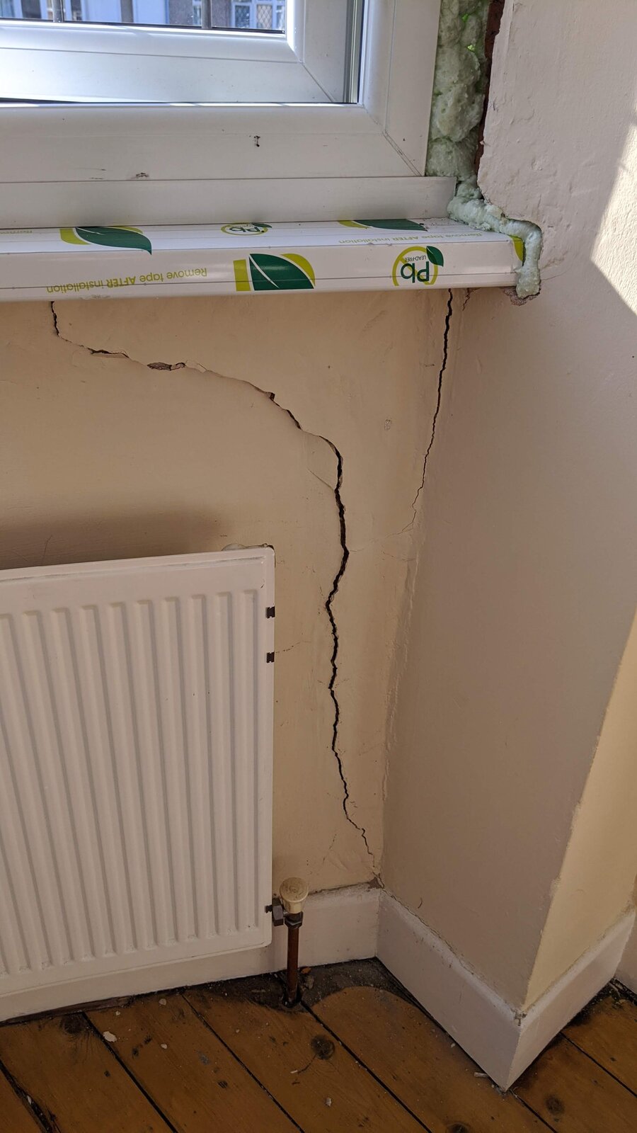

I'll add another pic here of the upper back bedroom window - again, this to me seems like just careless drill work and then bung in some expanding foam, but again I'm prepared to be wrong.
I mean I'm a slow and steady DIYer and pretty meticulous about the finish jobs, so i expect a tradesman to be less slapdash then this... ?

It might be careless, but it looks as if it has been abandoned unfinished - in the photo to the left of the frame, between frame and wall, it looks as if they have squirted expanding foam in and just left it at that. It needs to be finished off with proper frame sealant. Likewise the wall surface they have wrecked, then stuck back in place with the foam. If they are window fitters, then I'm a Chinaman. They were clueless, please do not pay them until the job is properly finished and approved by someone suitably qualified to judge it finished.

Hey all, thanks. Yeah to me it's look shocking. That can even be out down to movement. They've just blown the bricks out. They're not finished as yet. Back tomorrow. A manager is coming out to inspect the bay etc.
