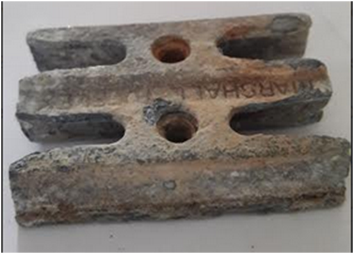

Hi all,
Just moved into a new flat and have had some probs with the windows. A few were blown, one handle didn't work and two of them stick on the latch plate when opening/closing. I got a guy in to sort it all out, and he did so, except for the sticking problem. He told me that it was a common problem with that type of window (quite large and hinged at the top). He said that the sheer weight of the glass causes the frame to bow, and that nothing can be done.
However, on closer inspection, I find that the worst window sticks only on one side and, after taking off the latch plate, it doesn't stick at all.
Is it possible to source a latch plate with a lower profile or, failing that would it be OK to grind about an eighth of an inch off the bottom of it?

Yes. there is evidence of a condensation problem. is it relevant to the sticking problem?
Its relevant to a rusty frame keep, these things are zinc plated, how the hell did it ever go that rusty?

I was told that the previous occupants (it was tenanted) never opened the windows, hence the condensation. Are those frame keeps easy to source? I can't find them on ebay.

Search then for pvc window espag keeps or strikers, you should get some results then. However the keeps are frame specific and the underside matches the contours of the pvc frame.....the 'profile' as we call it in the trade, without knowing which make of profile you have then its just as best to buy some universal ones
Sorted. Had to drill mew fixing holes in the UPVC but the 8cm keep seems to have solved the sticking prob. Have already ordered another for the kitchen window.
