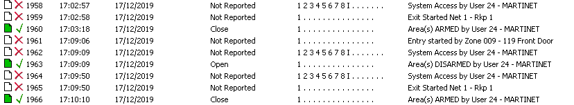

The zone description is showing upon entry (e.g. "Entry Started by Zone 009 - 119 Front Door); but upon exit, the zone description is ambiguous (e.g. "Exit Started Net 1 - Rpk 1").
Any advice on how this can be rectified?

What’s wrong with that ? It’s saying you started to set the system from keypad 1 on network 1
