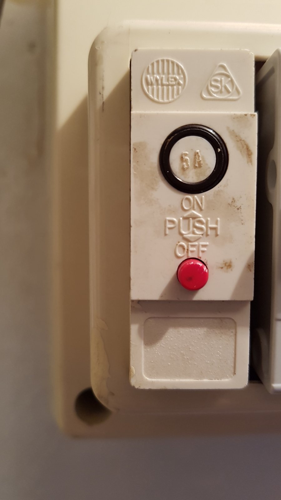

Hi,
I have recently purchased the Wired Ring Door Bell. Ideally the transformer should be placed in the CU but i have no space left in mine plus house is all tiled flooring and wires all hidden.... will work out costly to get the wiring to the door bell.
I have a option but need advice to ensure its ok/safe....
In the porch there used to be 2 lights on 2 different switches/cables. I had changed the lights to LED and only using one switch/cable now. The other switch/cable was secured and closed up. These cables are 1.5mm and wired/coming from a 5 Amp circuit breaker in the CU.
Would it be safe to use the closed up wire already in the porch and connect to the Ring Door Bell transformer? Will is still get the power it requires?
I have bought a DIN single module for the transformer to make it accessible and tidy.
Yes, as long as you do it safely.
Yes, as long as it has a permanent live, not a switched one. How did it used to be connected to switches and light?
Thanks (ban-all-sheds) much appreciated.
The closed wire is actual on a lighting circuit that had 2 Light fittings in the porch. The 2 new LED lights/bulbs are now just on one switch now so had closed the 2nd wire off. This had its own separate switch that can be reconnected to be permanent.
Yes all work will be carries out safely, DIY I am very hands on plus minor electrical work. I just wanted to double check on this before commencing forwarded.
Just to clarify, the Lighting Circuit is on a 5amp fuse in the CU.

Hi, in answer to the OP's post, yes that sounds like a good solution the 5a mcb is fine for the wiring to your transformer.
Thanks,
Dave
I read that as possibly the OP is thinking of using the bell push to switch the mains supply to the transformer. ( I have seen that done ) That is not a good idea and with most door bell push buttons it could be potentially very dangerous
The existing cable could be used to connect the bell push into the ELV ( Extra Low Voltage less than 50 volts ) circuit of
|----- transformer secondary ---------------- Bell push----------------Bell-----|
