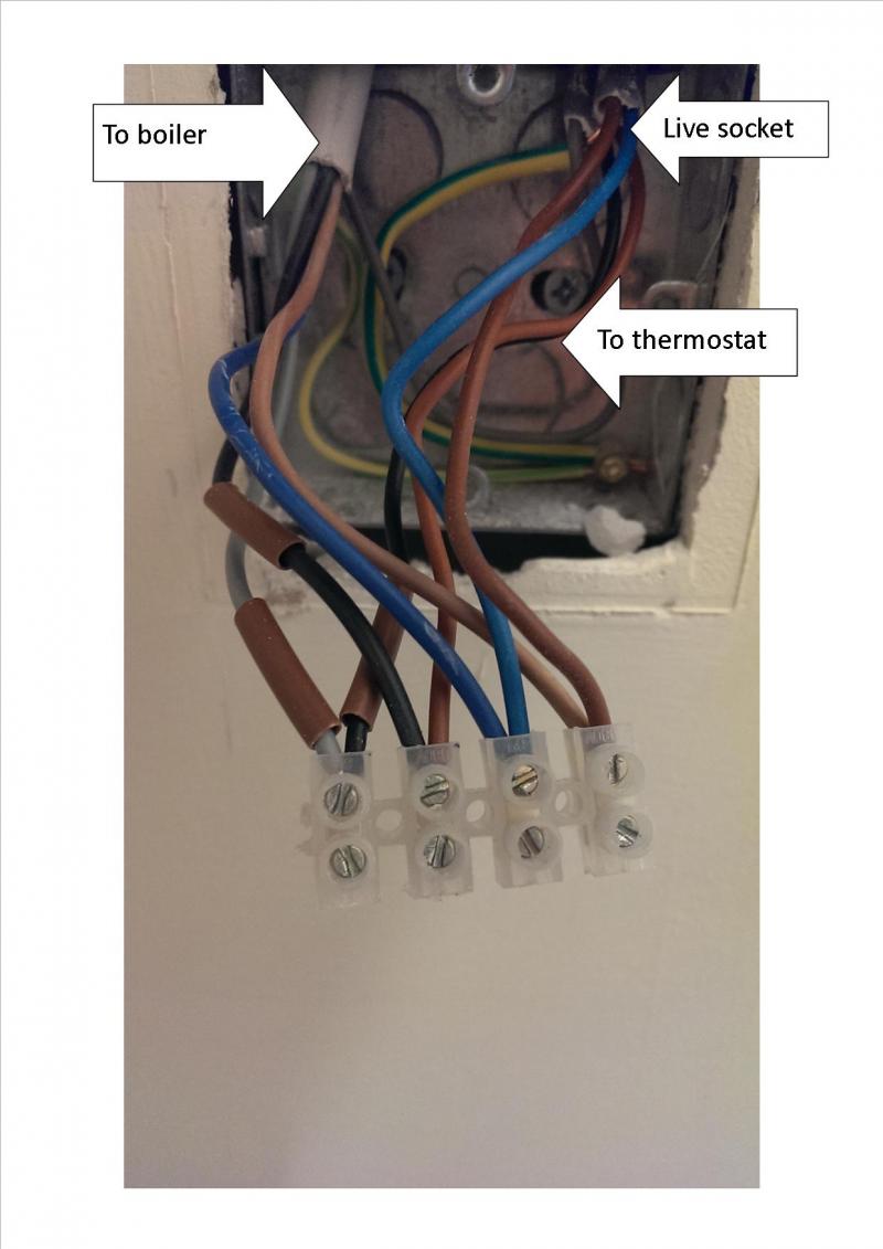

Based on the limited information you have given, I have made a sketch of how I understand the Aube RC840T is wired. Unfortunately saying that..
The boiler has a 4 core but unsure how these are connected internally
Is not very helpful. This information is essential, because methods of wiring, boiler requirements etc., change from installation to installation, depending upon the connected components and who installed it.
Most boilers require a permanent live, a switched live (that starts the heating running) and a neutral. The Aube provides these, but you will need to find out the correct connections for these at the boiler end.
The same is true of the thermostat. The Aube unit provides 24 VAC control signal, you will have to confirm that this is suitable for the Nest and what terminals to connect to.
Finally, there is no mention of a timeswitch, so I assume the 'Nest' can provide time control as well as temperature control.
Taking into account other comments regarding motorised valves. There isn't any wiring for one shown in your photographs, and as not all systems have one it's likely there isn't one. However if there is some wiring for one elsewhere that changes everything.
Stems sketch above looks ok the colours are
blue = neutral
black = line
red = S/L
but it is only ok if your boiler is currently switched directly via the thermostat at line level.
as others have mentioned there may be other components in the system and also as has also been mentioned the unit is designed to switch resistive heating loads ie elements not boilers (its overkill)
looking at your Pic above it seems as though you have a actual switched pair coming from the boiler (the black and grey) they are sleeved brown so one would expect them to be at line potential but are you sure they are?
just because your room stat is rated at 240v it doesn't mean it is switching at that level
what make and model is your boiler ? as many are designed to use either a switched live or a ELV pair nowadays

Regarding my drawing, when you said..
That was the point I was trying to make by making the following comment about the wiring to the boiler;
Sorry it wasn't clear.
