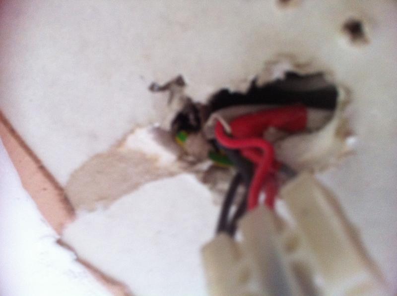

Hi all,
I would be very grateful for some advice with reconnecting my light which became partially disconnected whilst I was trying to reattach the light fitting to the ceiling (the light was currently off, but there was a spark when it fell)
So, coming out of the ceiling are 6 wires in total:
One single black, which has some red tape slightly further up (switch wire?)
Triple red wire
Double black wire
The double black is still connected to the neutral/blue wire coming from the light
But the triple red and single black (with red tape) have become disconnected from the earth and live wires coming from the light
Above the wires coming out of the ceiling I can see them bundled together in either red or white casing. I can also see some earth/green&yellow wires up there as well (but none are coming down through the ceiling)
So my question is, do I attach the earth wire from the light to the triple red from the ceiling, and the live wire from the light to the single black with red tape from the ceiling? Or vice versa? I assume they were all attached in some way or another before the light fell?
Would be grateful for any advice you can give me….
Apologies if this is an obvious question, or has been asked many times before…
Nina

Can you upload some photos of what you have?
Thanks both for you quick replies
I have attached two photos? Can you see them? I have made them viewable to "Everyone".
The light itself is metal (i will take a picture of it tonight) and attach
So i need to attach the single black wire (with red tape), the switched wire, to the brown/live wire on the light. The triple red ceiling wires will be left as is, unconnected to the light. What about the earth wire from the lamp? Slightly concerned that there is nothing for the earth wire from the "metal" lamp to connect too...

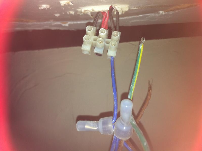

There are currently only three terminals all of which are currently in use by the wires from the ceiling, one is being used by the switched wire, another by the 3 reds, and the third by the two blacks. Do i need to get a 4th terminal? Slightly concerned that the light has been in use for the last few years without being correctly earthed. Thank you
Yes, get another piece of connector block for the earths, or you might find that when you pull them down from the ceiling there might be one on them already.
If the light was unearthed before than that was wrong, but the earth could have been connected to the others and pushed above ceilinbg and pulled apart when it fell, you don't know, either way, ensure that you *do* connect it this time... AND GET A SOLID FIXING ON THE LIGHT, PREFEABLY INTO A JOIST THIS TIME :LOL: :LOL:
The photo you have is the start of correct wiring.
The blue wire goes to the two blacks (as you have already done.
The brown wire goes to the single black that has the red tape on it.
The earth wire (green/yellow) from the light must connect to the earth wires that are up in the ceiling. Use another piece of choc block terminal for that.
It did not matter if the old light was not earthed unless it was a metal fitting.
But do not worry about the old light. Just concentrate on the new light. It is metal and has an earth connection. It must be connected to earth,.
Last thing. Thos three red wires, in the middle of the terminal block. leave them like they are. DO NOT connect anything else to them. Red wires are very aggressive and they bite anybody if they are messed around with, especially if they are from a different colour tribe (they especially hate blues and green/yellows)
