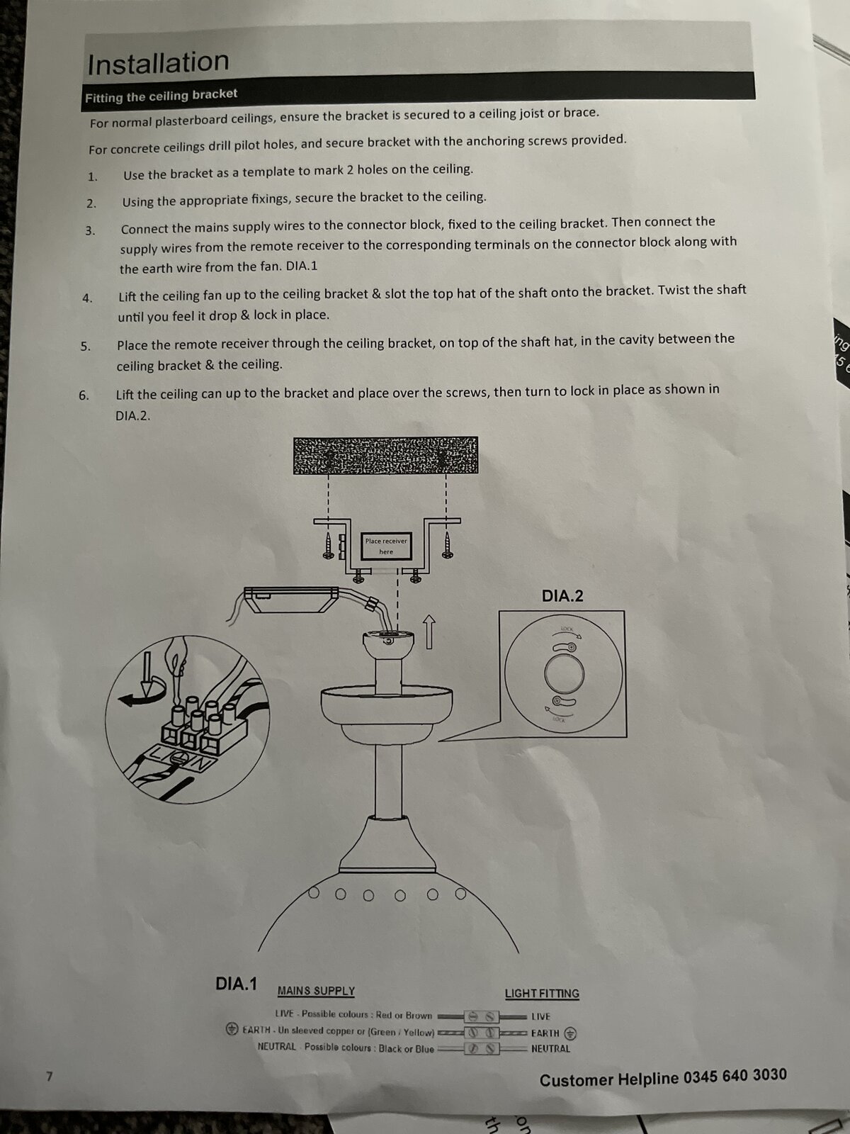

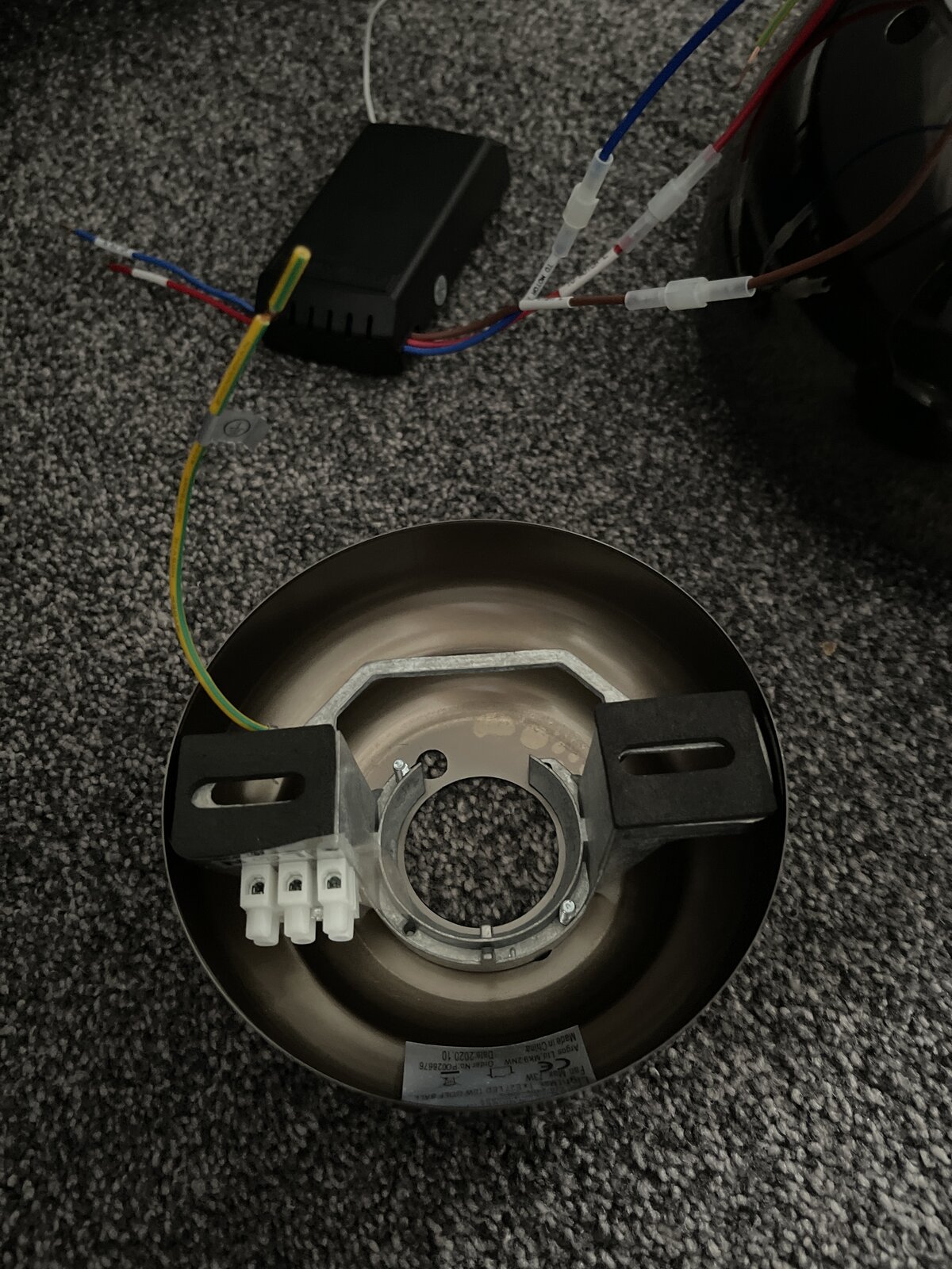

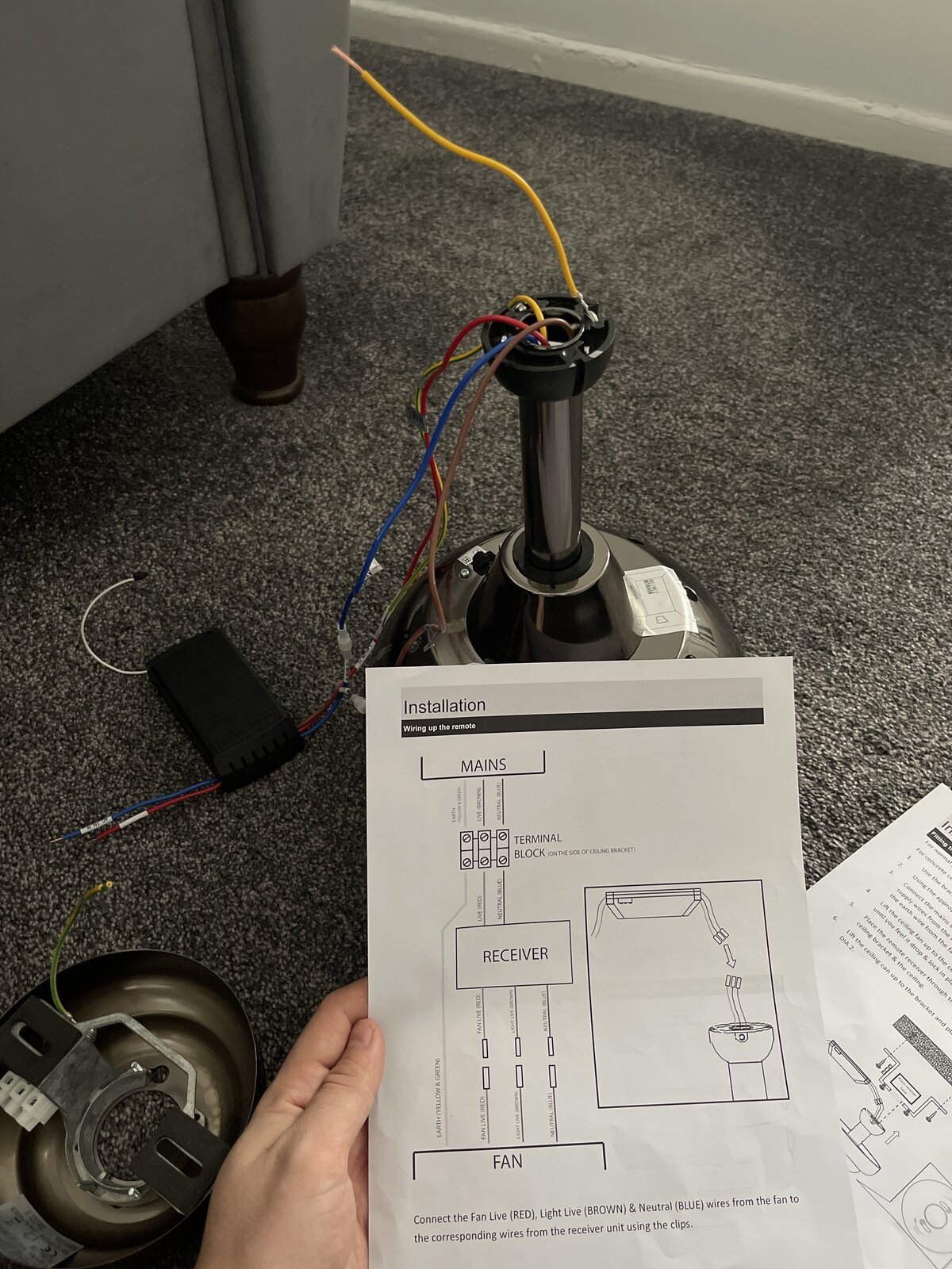

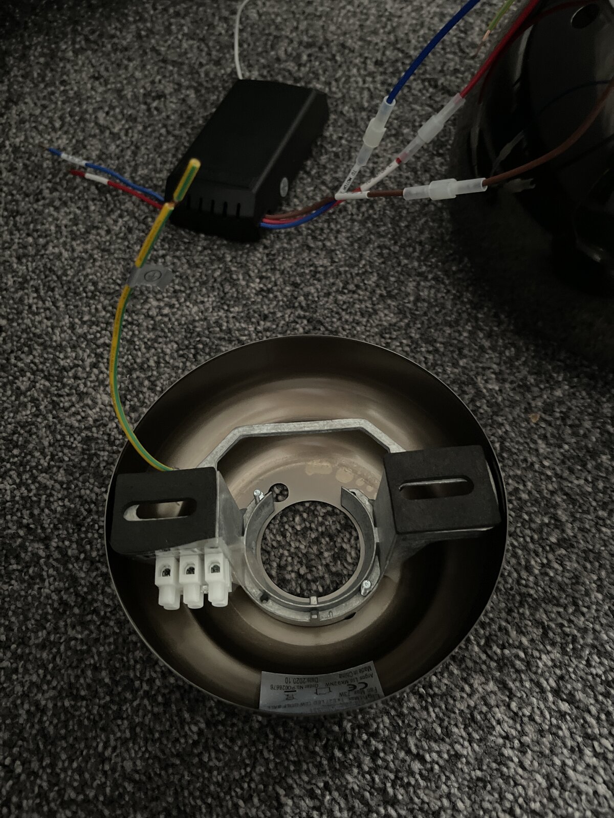

Hi guys,

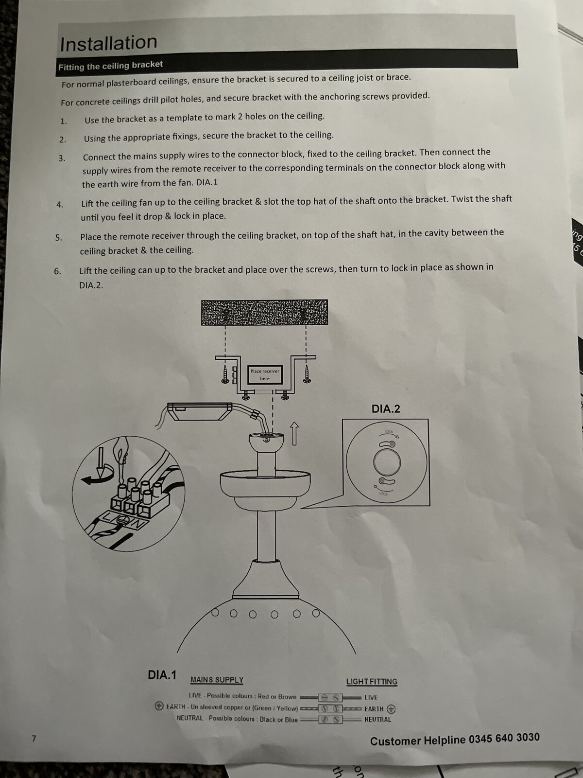

New to this forum and I am in need of some help with wiring a remote controlled fan to my existing ceiling rose. At the moment I have a chandelier that I am replacing with this fan. I’ve got an earth , live and neutrals with 3 live insulated separately which I won’t be touching. Next the ceiling fan bracket has an earth wire and a connector block. The insurrections say that I should connect the mains supply wires to the connector block so all three neutral, live and earth connectors and then connect the supply wires from the remote receiver to the corresponding terminals on the block along with the earth wire from the fan.

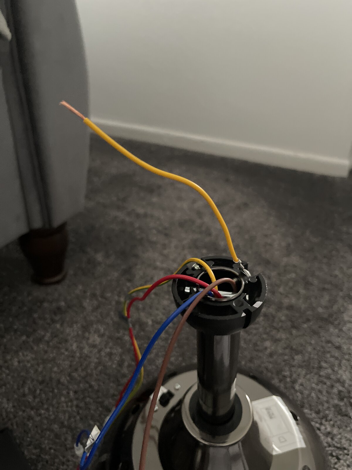

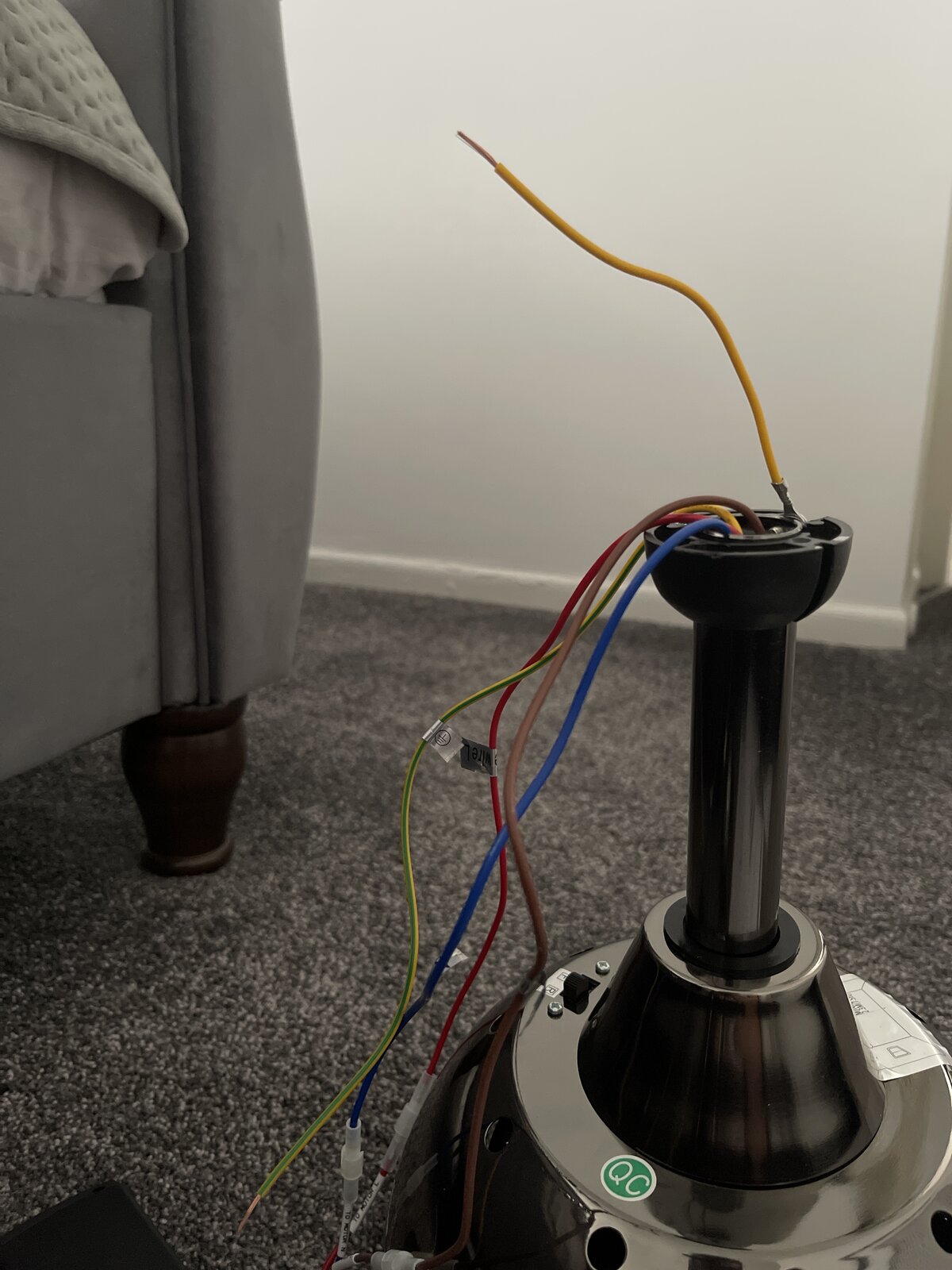

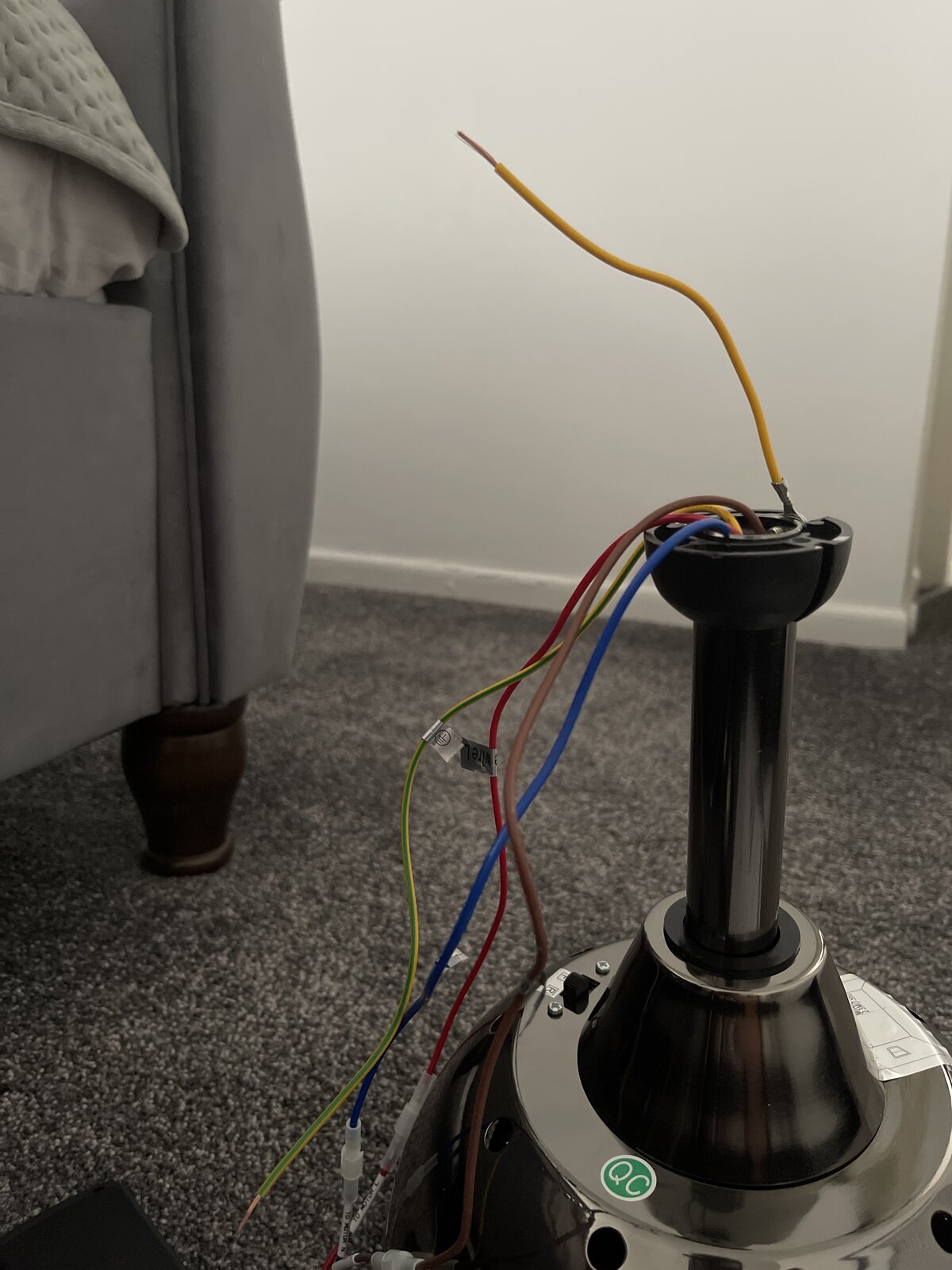

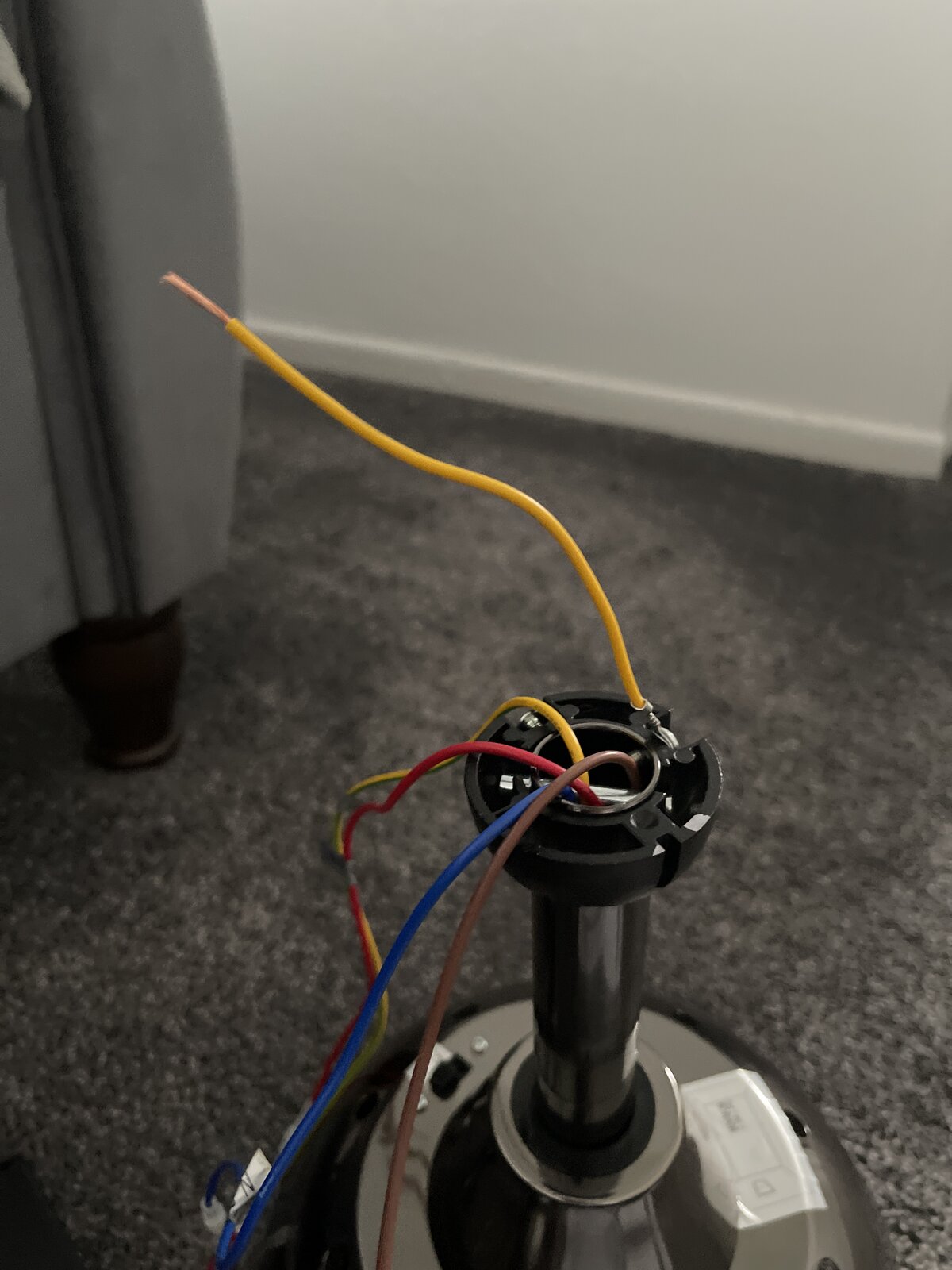

as you can see there is an earth wire on the ceiling bracket, the fan and on the shaft. I’ve pictured them so you can see. I am confused as to how to wire all 3 earth wires with it all? I’ve uploaded the instructions and some photos of it all. Any help would be much appreciated please.
Thank you

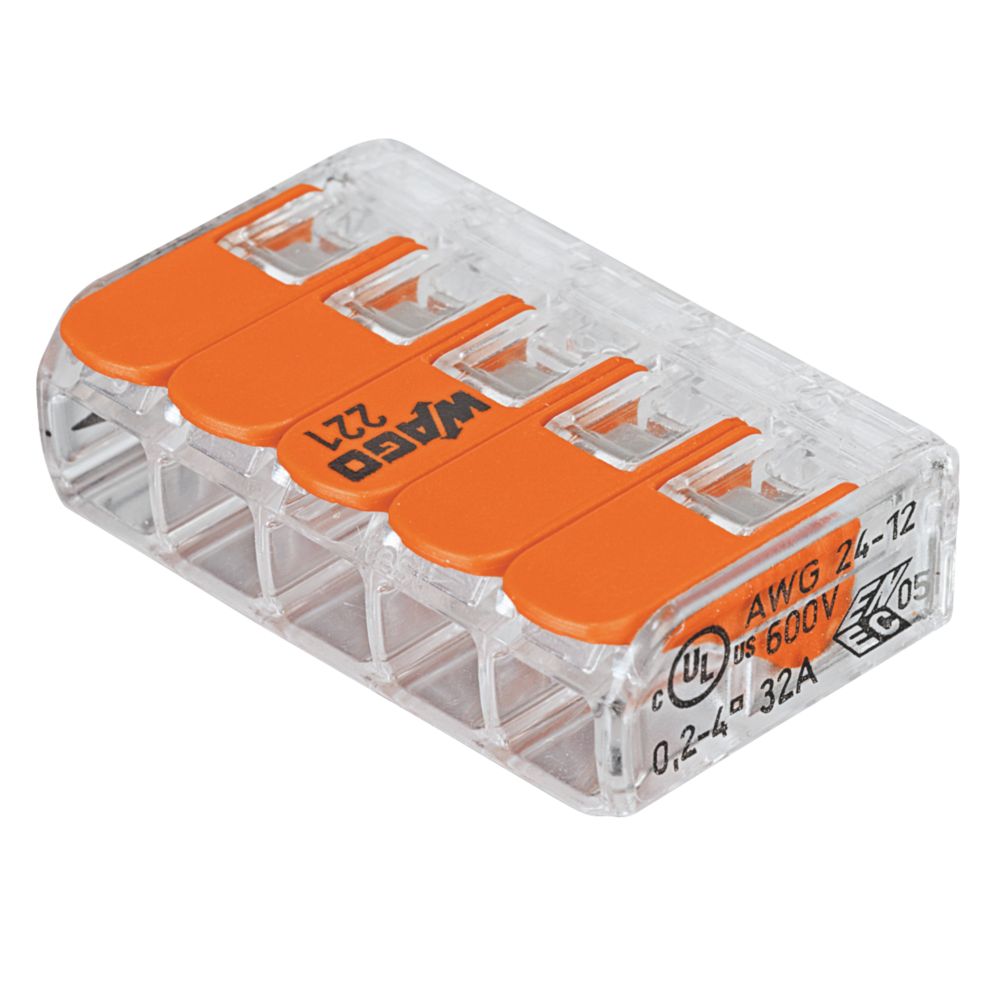

Does look a but of an odd set up, easiest way to link lots of wires together is using a Wago block you can buy a pack of eight from Toolstation for around a fiver.
