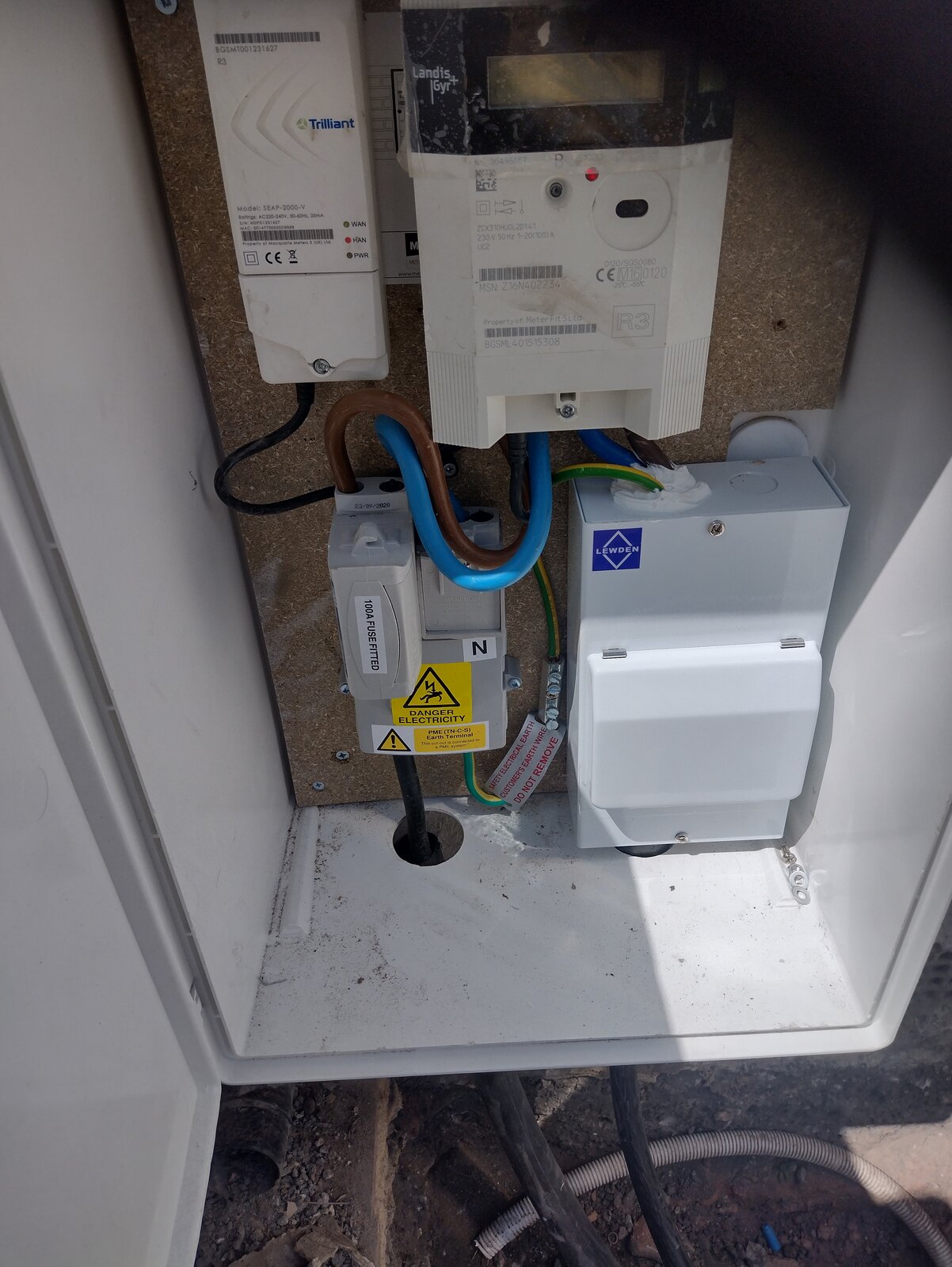

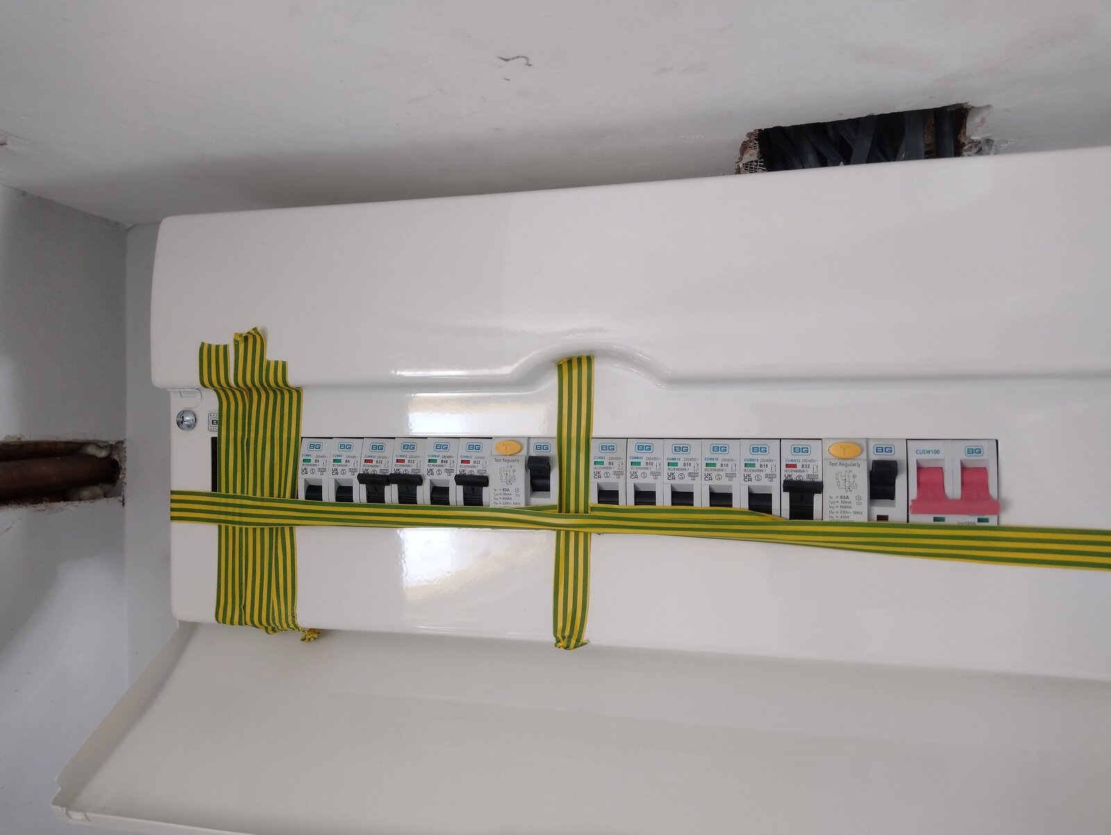

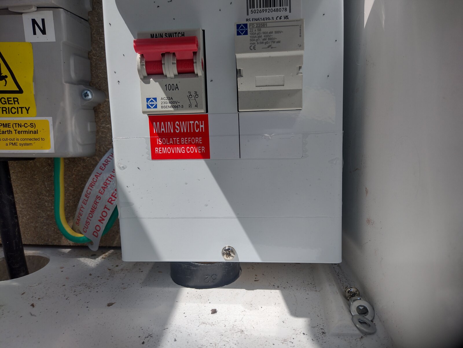

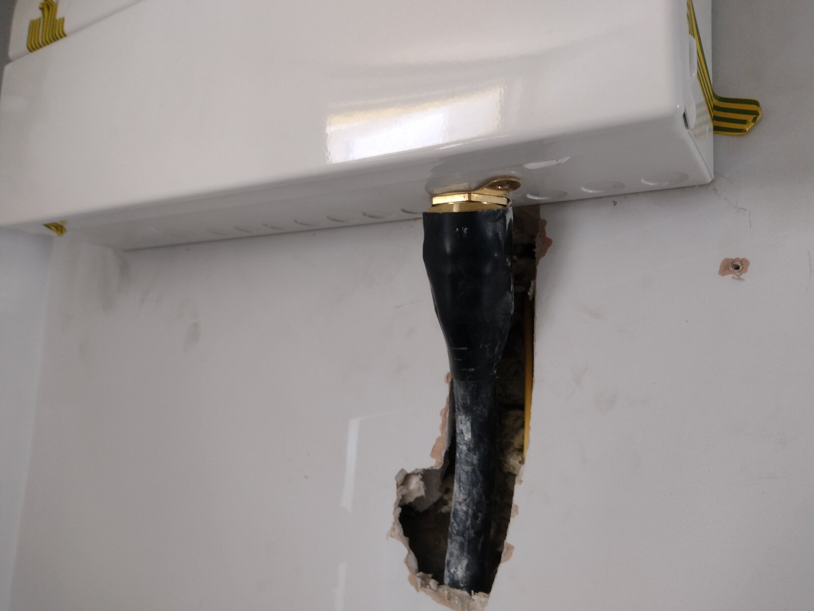

Floorboards are up temporarily so want to take advantage and get the wiring through for an EV charger
My question is is my existing set up okay for something like a 7.5kw EV charger?
Also what size cable(s) do I need?
Consumer unit is 4m away from where EV charger will be. EV charger will be on external wall where trench is

6mm² cable would be the usual choice.
That consumer unit is not suitable unless it can be altered to accommodate an RCBO and surge protection.
The blank holes need to be filled with the appropriate blanks, not random lengths of tape.
Would 6mm SWA 3 core suffice?
Or would I need special cable like this from toolstation? i.e. 6mm 3 core power + Cat 5e
The toolstation cable does not look armoured would I have to protect it with something like plastic plumbing ducting pipe as it enters the ground and through the building?
I have the following consumer unit
Is it just a case of fitting and RCBO and surge protection for the EV charger alone, or would all the MCB's/RCD's need to be changed?
If Cat5e is required for an internet connection, current monitoring or both of those, that cable could be used.
Alternatively separate cables could be used for the supply and data.
If only a power supply is required, then 6mm² SWA will be fine.
Non-armoured cables are not suitable for use underground unless installed in steel conduit or similar.
That consumer unit is sold as a 'dual RCD' item, which almost certainly means it only has 2 neutral busbars and no facility for installing RCBOs or anything else.
A new circuit for EV cannot be connected to either of the existing RCDs.
