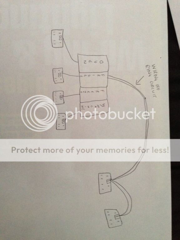

i am currently rewiring my house done all sockets now come to kitchen and im stuck,
i want above the worktops switches that are labelled oven, fridge,freezer,washer,dryer
however i am not sure how to wire it
do i just do it like im doing the sockets get power from socket to the box im puttin in with all the labels on and then from there to all the appliances ?
i have done a quick drawing below
thanks
sorry ignore the oven thats having its own wire straight to the consumer unit will be washer , dryer , fridge , freezer
thanks
You could have a 32A radial feeding that lot.
Or you cold have individual radials feeding individual appliances.

thanks for the reply,
can i do it the way i have done it gettin power from the sockets ?
I would imageine the sockets are 13amp?
I agree re: radials for each / one radial. I might be tempted (loading dependant) to knock it down to a 20/25a radial though so you can stick to 2.5mm rather than going up to 4mm, but that's preference/loading dependant.
I think gridswitches are the way to go for switching above the counter.
Could go with 3 x FCU's but that would look pretty rubbish.

For the original question, that cannot be installed as a ring, and unless you want all of those items on a single 20A circuit, the cables will have to be inconveniently large.
