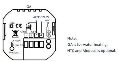

At present i have a Worcester boiler which carries two wires neither of which are live to a Honeywell manual thermostat. I wish to replace it with a wireless thermostat which of course needs to be powered. The new thermostat as four terminals, terminal one is marked (close), terminal two is marked (open), terminal three is marked (N) and terminal four is marked (L).
and above the N & L is printed AC95-250V. Can someone instruct me if a 240V plug can be wired to the thermostat and if so which of the four wires go to which terminal?

That thermostat appears to be a Mairuay thermostat GA version.
From the diagram on the back,
you can see that it is really designed to operate a motorised valve that requires a live output to open it [2], and a live output to close it [1]. In the UK this would be known as a MOMO valve and is extremely rare, only slightly less rare than hens teeth!

There is no voltage free contact with this device, it can only provide a 230V live output, so it will not be a suitable direct replacement.
I suspect this is an item really designed for non UK installations. I have seen this type of thing bought in the UK on Amazon, when someone has inadvertently strayed from Amazon.co.uk and on to Amazon.com instead.
The GC version provides a "dry" or "voltage free" contact.
