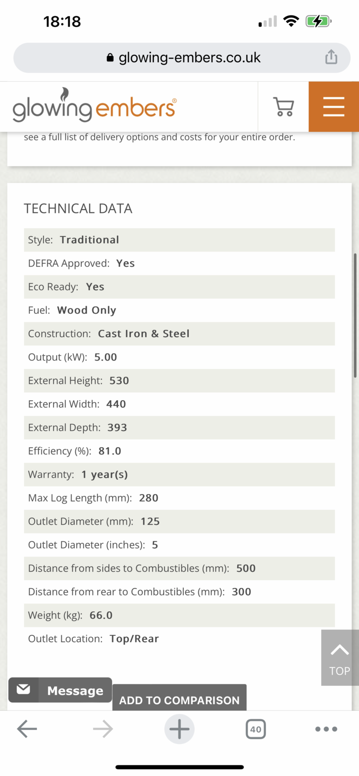

I notice looking at the original stove specification that it is possible for the flue gases to exit from the top ( as yours does) or the rear.
This means that the stove can be pulled forward, and a 90 degree bend would be needed so the gases exit the back of the stove, turn 90 deg upwards and the connect into the existing flue. The existing top outlet is blanked off.
The stove has a maximum output of 5kW - anything larger requires its own ventilation.

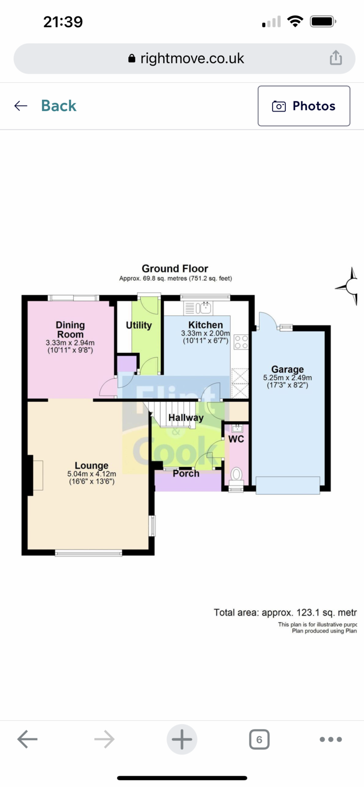

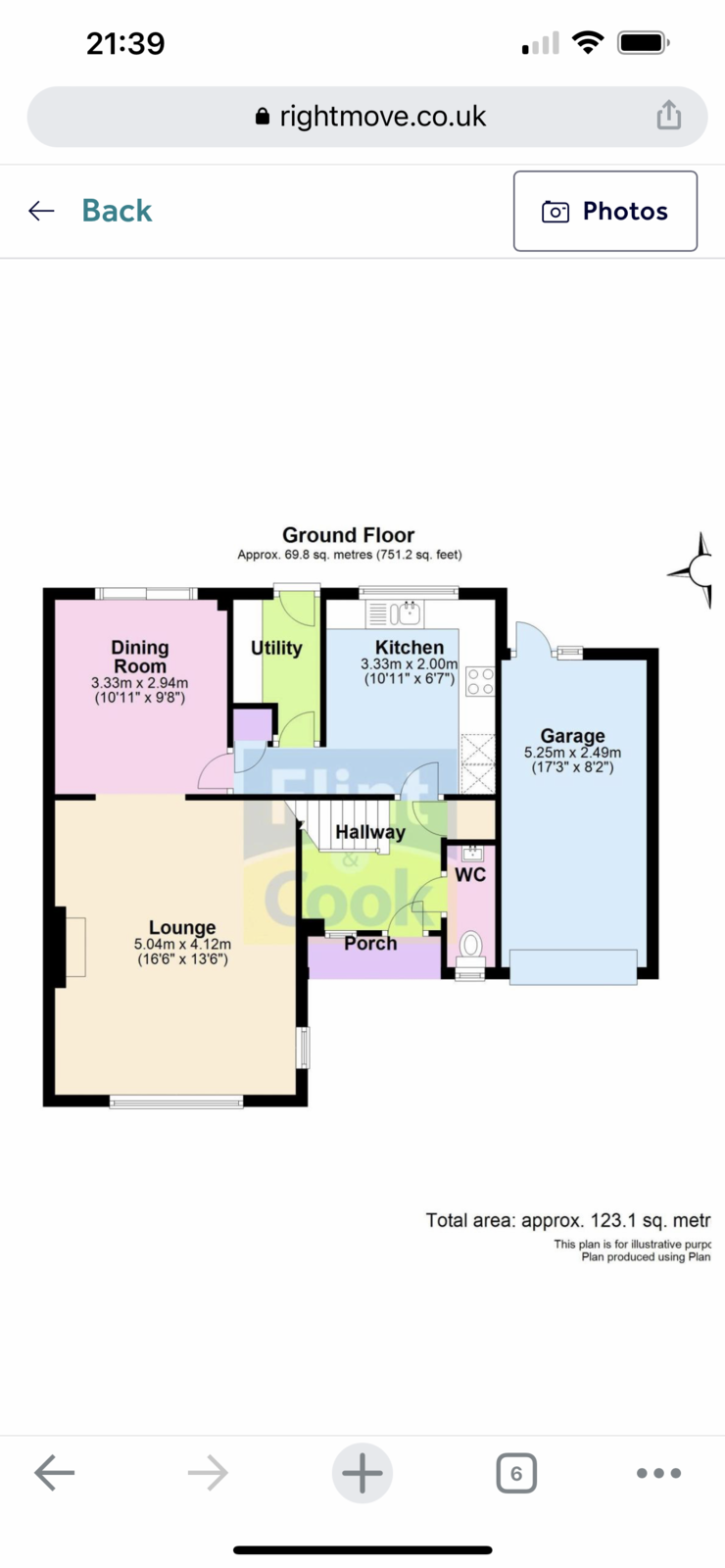

Can you draw us a top down sketch of what we'd see if a horizontal slice was taken of the entire wall, fire, everything at a height half way up the log burner door?
(If it helps visualize what I'm after, imagine you have a chainsaw that will cut anything, and you slice horizontally through your entire house 18 inches off the floor, then pick the now loose top of the house up and throw it away; what do you see left behind, from a birds eye view?)
Here’s the floor plan? Does that help lol.
The space is big if you take into account the joining dining room which is open plan (open archway wall).

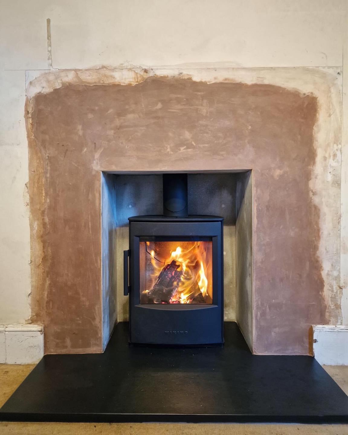

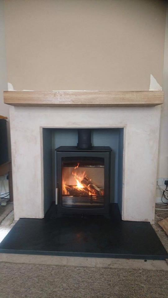

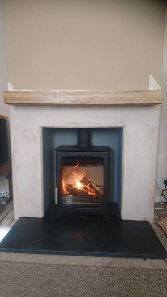

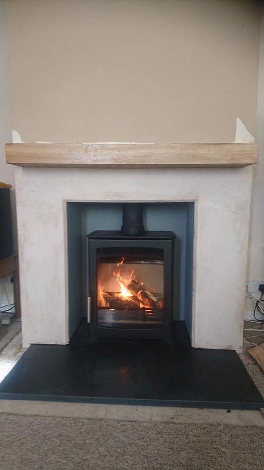

Would this type of thing be a better set up? So basically remove our surround which isn’t very tall and increase the height of the space and get a wood mantle instead? So we could have a fan above? Or if not possible smaller wood burner to increase space above.
I believe the surround could be removed and the hearth could remain in tact as even though it’s stone they are superstore parts, just depends on how much damage is left removing the upper parts of the surround!

I am thinking the same, so to remove the surround, increase the hole (just the space above) the gap can’t be increased widthways as it’s inline with the chimney breast and install a new mantle.

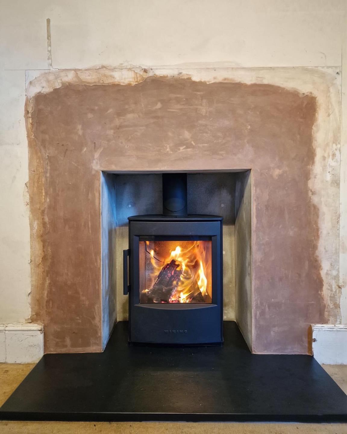

Meaning it would be something like this? But potentially with a larger gap if we replace the stove with the smaller version… we have Hunter Allure 5 but could swap for Allure 4?
Don't think you need to increase the gap on the sides, the last two stoves I've had throw most of the heat out the front and top, the sides not so much.
Have you already made a space for the stove or is that work happening?
I'd be tempted to double the space above the stove... based on the photo in your previous photo.
If you can't there is a 'thing' you can fit in the flue that has a small electric pump and a coil in the flue pipe that burns more efficiently (apparently) will see if I have a bookmark, as I can't remember the name off the top of my head.
You shouldn't have any problems with a TV above that shelf/mantle, it protrudes a fair bit and will be a good deflector.

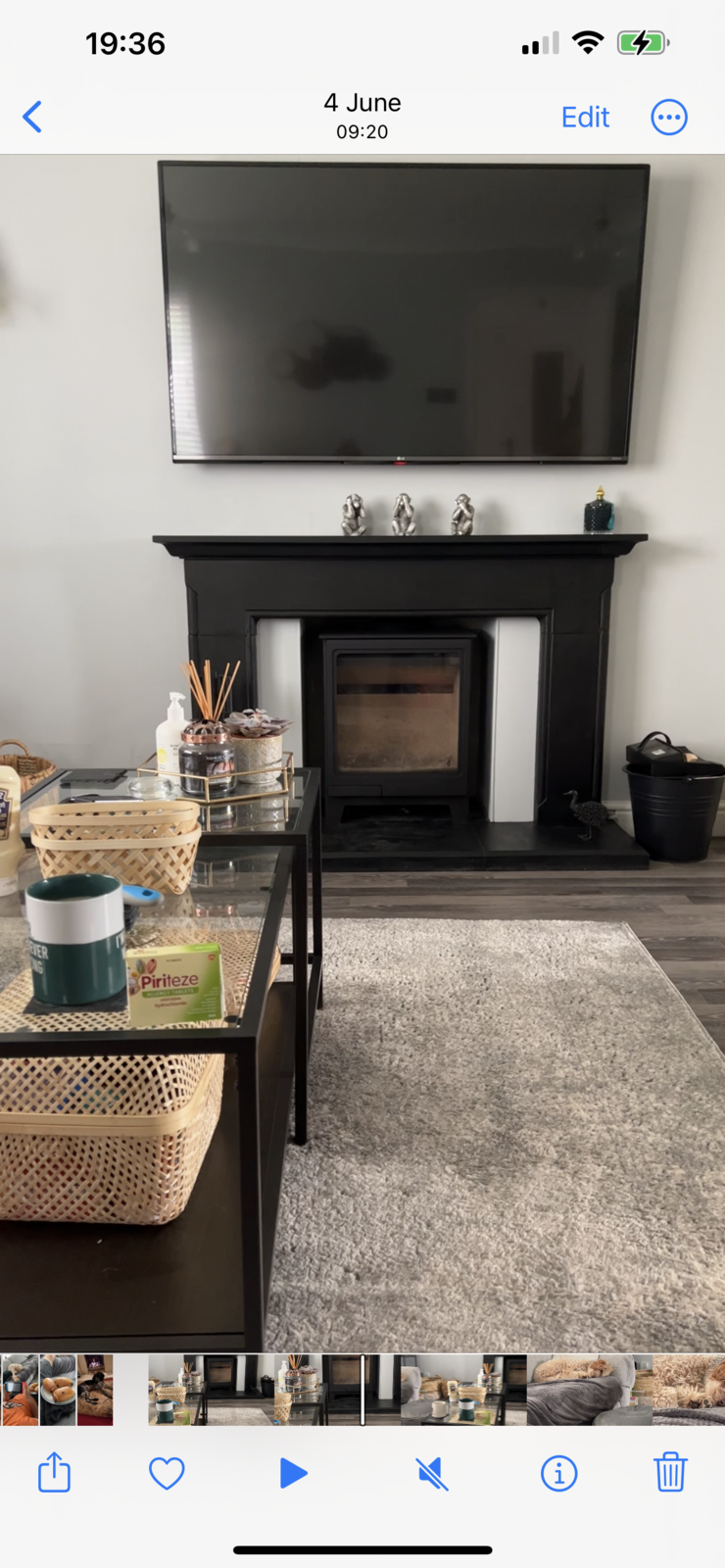

Nope no work has been complete yet, the fireplace was installed about 10 months ago, I’ve contacted the company and have asked them to come out to look at our options to increase efficiency.
We could increase the top gap a lot if we reduce the size of the wood burner, otherwise it might not be double as the burner is kind of big competitively.

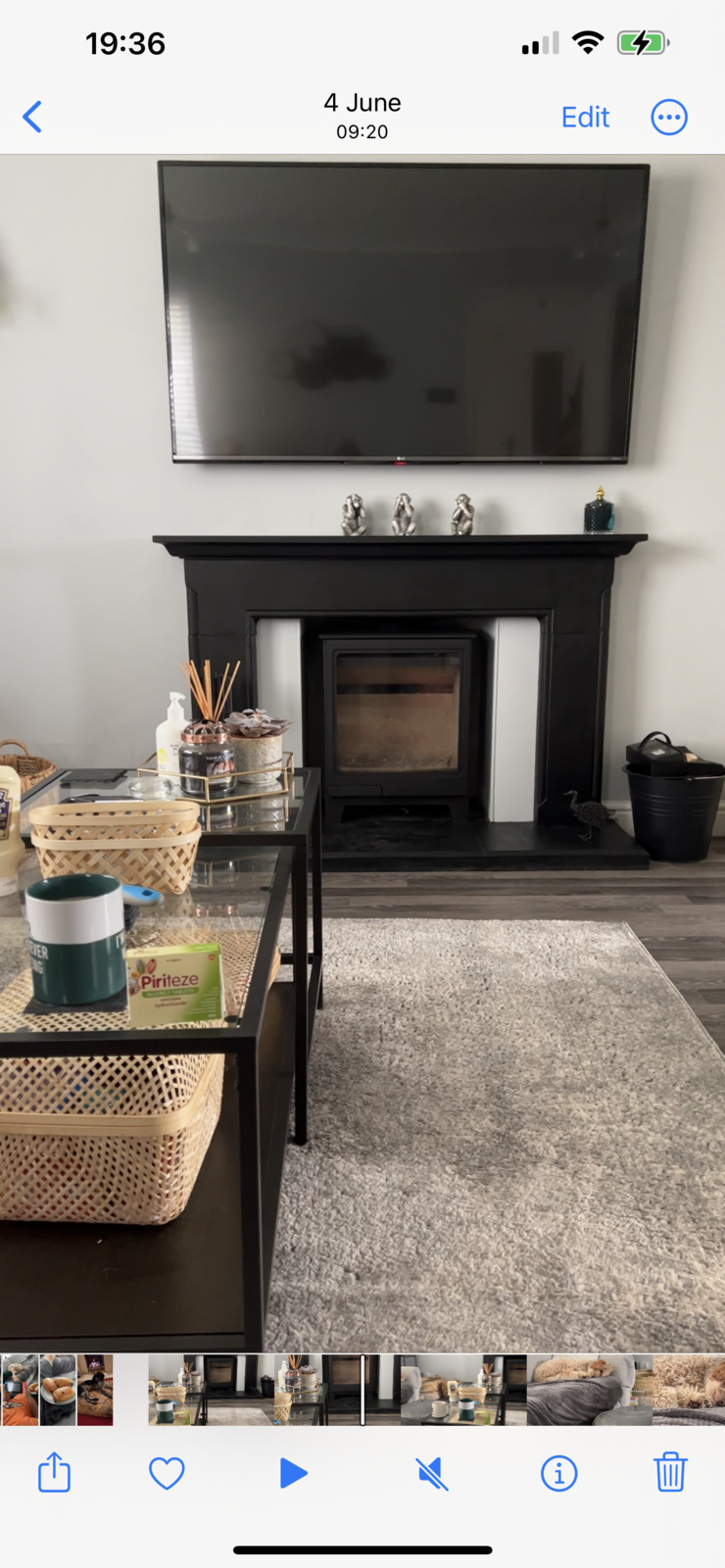

This is the current set up. You can see the stone mantle (original house feature we wanted to keep hence the not so good install) is pretty thick above the burner, so removing that have having a thinner mantle would make for more space. There’s also a tv above it currently…
The amount of money you are going to spend will not be recouped in energy benefits.
If the chimney is sealed to prevent hot air escaping, and reasonably insulated with fireproof materials, the heat will have no option but to heat the room and the brickwork surround.
Incidentally, I have a friend with one of those stovetop fans, and he swears that if you hold your hand in front of it you can't feel any difference.

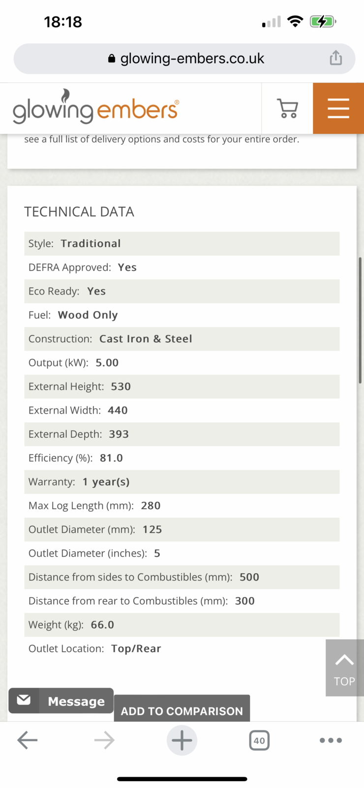

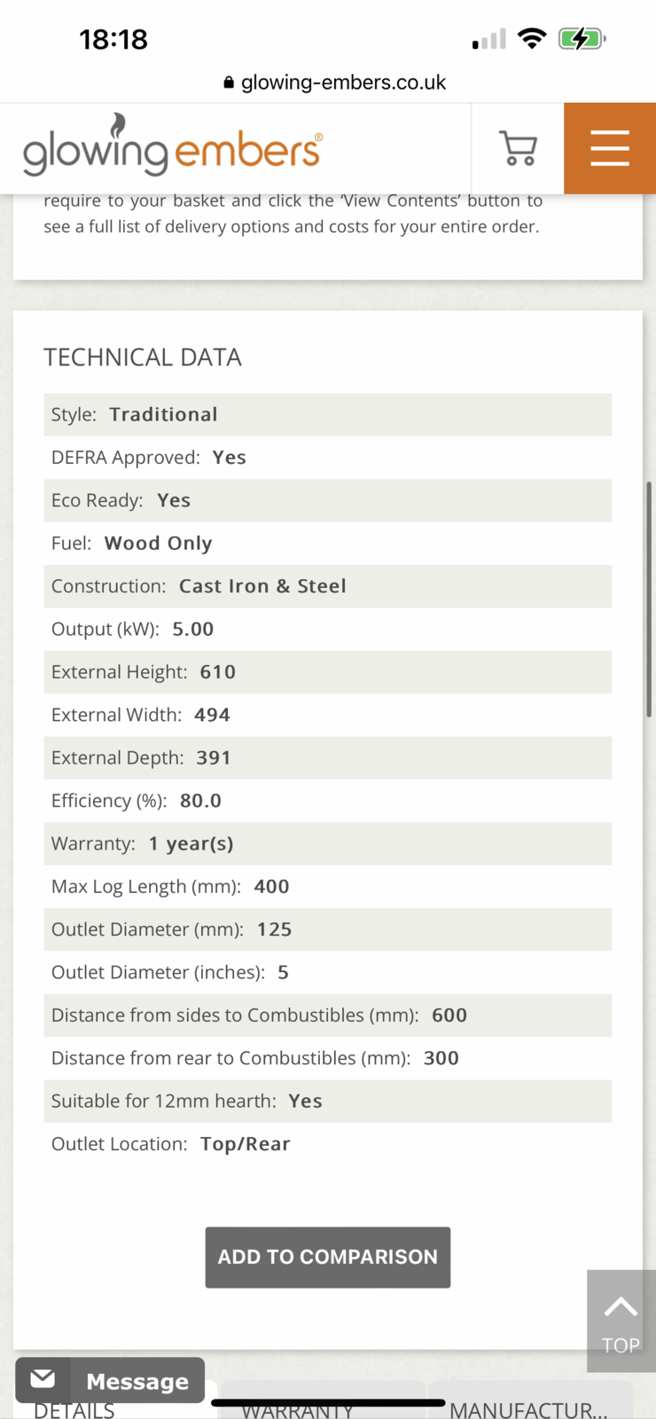

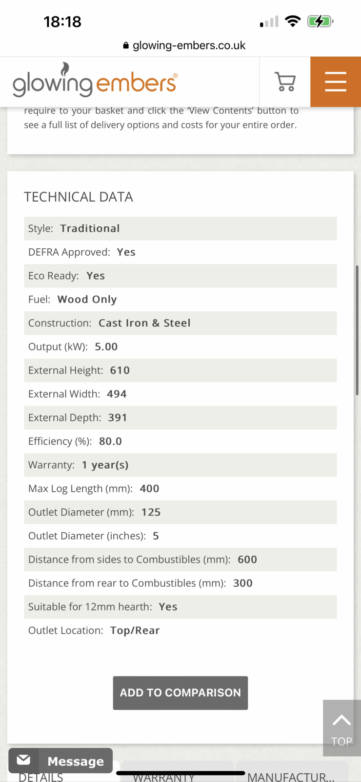

@Mr Chibs i previously posted the dimensions of the stove we have and the smaller version but here again! I think the output of heat is similar just the inside volume is bigger on allure 5.
Getting a smaller burner might not be an option financially it depends if we can sell ours and replace it or not!

In my opinion, the current stove looks too large for the opening. It just doesn't 'sit right' in my eyes. I think the smaller one looks much better.
However, before deciding what route to take, I would compare the cost of replacing with the Allure 4 against the cost of any building work.
It may be that the supplier will give you a good part exchange deal against your current one.
