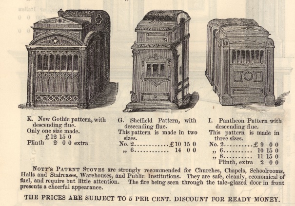

I now recall that Whipps Cross Hospital ( my local when I was growing up ) use descending flue fires on the larger wards before a centralised heating system was installed
And there were these for churches and similar but also used in large houses where staff / servants could start a fire in the upward section of the flue to create a convection draw before the fire in the stove was lit.
A normal solid fuel stove cannot be interlocked to make the fuel go out if the fan fails.
