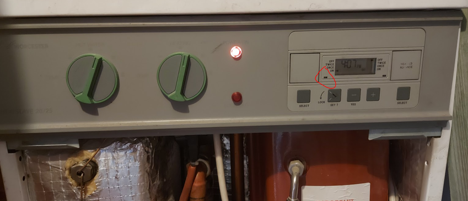

Control Panel - Power Light - On, Lock Out - Off, No HW Light - when I press the button does not come on, although it is set to on.

post a pic of any controls you have and of the boiler control panel too, can only be a control fault or DHW flow switch fault, does cold water actually come out of the hot tap when opened ?
Is the manual lever on the diverter valve floppy? If yes, switch off all power to boiler. If it still remains floppy then the motor is jammed and needs replacing.
Cheers - I've attached a picture of the control panel and normally the light circled in red would be on.
Yes, currently cold water comes out of the hot water tap when turned on.
The manual diverter valve lever is not floppy and is currently set in the up position.
