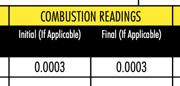

Combustion reading 0.0003 initial 0.0003 final. (is that very low?)

just a thought, Combustion reading 0.0003 initial 0.0003 final. (is that very low?) can it be too low?
hi, not sure what you mean. the only 'readings' i got on the Safety Record sheet is see image attached
The ratio is pretty meaningless...it's the ratio between carbon monoxide and carbon dioxide. The figure is "designed" to show how safe the combustion is but the relevant figures we need are the carbon dioxide at the high and low combustion settings.
Given the boiler is so new a proper annual combustion check should have been done and the figures obtained entered into the service log at the back of the manual (for compliance with the warranty). Have you checked?

Engineer asks to see past boiler record C0/C02 rates. Engineer opens last page and just says...'Oh'...er...!
I can read his body language straight away.
Checks the levels/ratio and off the scale.
