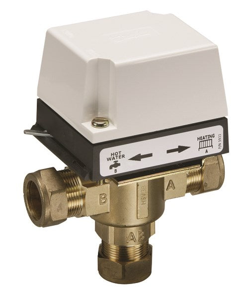

Charles, I have read it several times, including the additional posts, and you keep saying at rest it’s at position A for hot water and mention position B for central heating. Please see image of Danfoss, but there’s generally an industry standard:
Chris,
That is NOT my model of DV valve. My one is a competely different make, model and fittings.
Mine is a DRAYTON "Hansen Class 'F'" DIVERTER VALVE
27904 8-718-684-238
and I have it IN MY HAND.
Position A is the default rest position and is the DHW position FOR CERTAIN.
Position B is CH position, and the valve has to be powered to achieve that state.

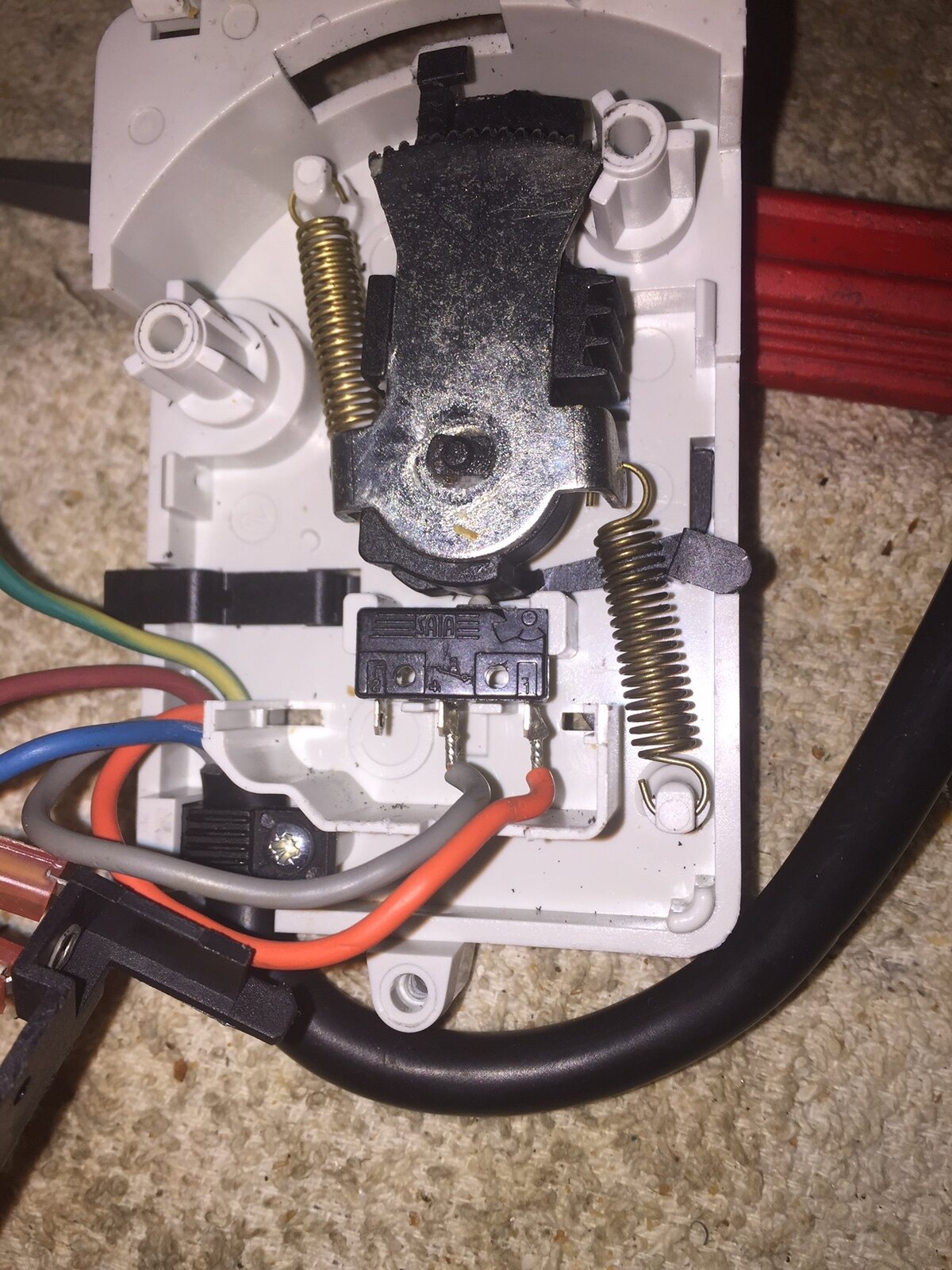

Here is a photo of the DV controller opened-up ready for the change-over of the microswitch.
You can see the springs, and that the indicator lever peg is all the way down, in position A.
CharlesY
