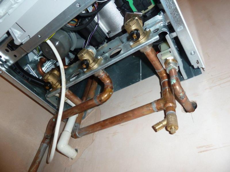

I'm not sure what pictures are wanted, but here's the bottom of the boiler showing the condensate setting off through the wall. On the other side it currently just juts out - the route I described is what he said it will do. Having found the installation instructions in the house I see that they say if it must go outside it should run internally as far as possible and change to 32mm pipe before going out. It doesn't do that.

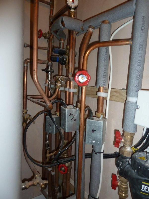

With regards the the 'rats nest' maybe I'm being unfair - maybe this is as good as can be expected from two-zones-plus-hot-water, since there are apparently a lot of components to fit in, but this is what I have on the wall of the cupboard:
Should this be more tidy? Or am I being unreasonable? I feel certain he's got the TF1 in the wrong place, connected the wrong way round, and the condensate drain is wrong, but am I wrong to hope for a tidier layout here?
This part of the house is completely new all the pipework is new, the boiler is new in a new kitchen that's down one floor and about 5m to the right. There was completely free reign on routing all pipes, so they could come into this cupboard wherever was convenient.
TF1 at bottom right. It is on flow from the boiler. Water is flowing up but the arrow on it is pointing down. The instructions say that it comes ready for upwards flow so it's been changed to wrong. For downwards flow you should apparently use the red O-ring and red spacer, but those are lying on the floor of the cupboard. I think he's used black spacer and blue o-ring.
So flow comes up through the TF1 then turns over and goes down through the valves, though to get to the upstairs valve it dog-legs round the cold feed to cylinder (has the blue things on it - presumably they are pressure limiter?) and the hot water running from the cylinder down to the ground floor and another pipe that comes off the primary leg to the cylinder which has the pressure gauge on it.
Filling loop is behind the upstairs valve. I don't see a check valve anywhere, but could it be built-in to the loop assembly (visible above the 2-port valve)?
At the very back are some pipes that take hot and cold to the bathroom behind the wall at the back of the cupboard.
Bypass is the 15mm with red wheel valve that's nearly central in the above. It comes from the flow where you can see above and into the return just before it dives into the floor.

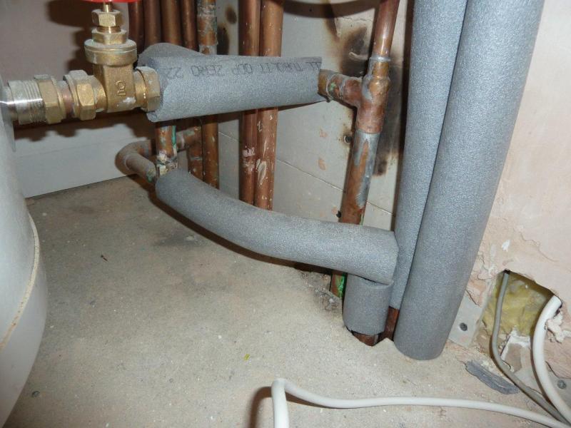

The floor looks like this:
From right to left: flow from boiler (lagged) flow to downstairs heating behind and return from downstairs heating in front (both lagged) return to boiler with the 15mm bypass coming off the top, hot to ground floor, cold from ground floor, first floor flow, first floor return, pipes at the back going through wall to bathroom.

A couple of pictures of the overall view of the airing cupboard would be handy to give a context, as well as a shot or two of the condense pipe. Which should be going outside if there is a kitchen sink nearby :rolleyes:
From your shots though, and ignoring the stupid location of the filter, I would give that pipe work a C minus.
I wonder if he has put the filter on the flow because it is the first pipe in the cupboard you can reach? Is the return tuck at the back out on the way - or the one right close to the floor?
I think TF1's are shlt anyway - every one we fitted leaked within the first 2 years.

Returns are all close to the floor:
Third pipe from the right that gets just above floor and then heads left (lagged) is one heating return, it meets the other heating return head on at a tee, the combined water then turns vertical before turning towards the camera and joining the cylinder return at a tee, heads to the right of the picture, turns at the wall, gets to a tee and heads off down into the floor towards the boiler.
At that last tee the leg heading vertically is the bypass, though it dog-legs a bit on its way to the wheel valve.
Is there a 'not' missing there?
There's not much more to show of the condensate pipe - at the outside at the moment there's just 100mm of pipe sticking straight out from the wall and dripping on the patio. He says he's going to run it down to ground (which is 300mm or so below floor level indoors) then run it horizontal round the corner and to the down-pipe gully, but it doesn't do that yet.
Is that an unvented cylinder? Looks like a pressure reducing valve and an expansion relief valve in the picture with a stop tap after it on the feed to the cylinder. If so that is very wrong, there should be no valves between the cylinder and the expansion relief valve.
tbh as we can't get a feel of the space available, it all looks a bit tight for future maintenance and parts replacement. Sometimes its worthwhile to try and plan the pipework before hand.
