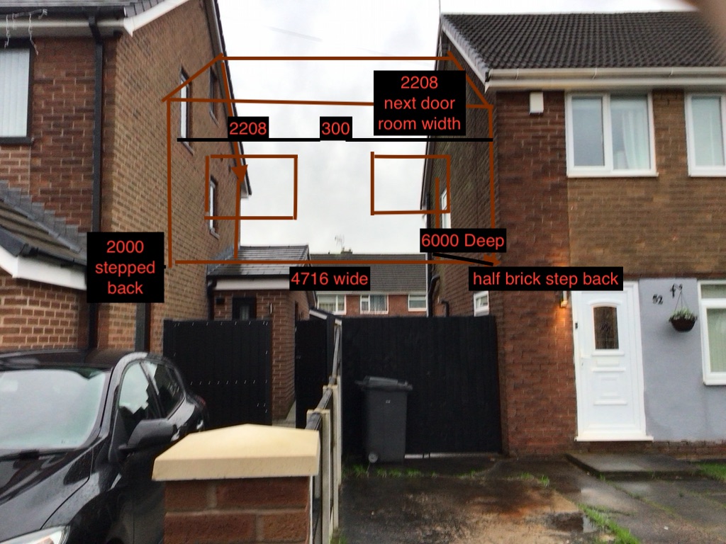

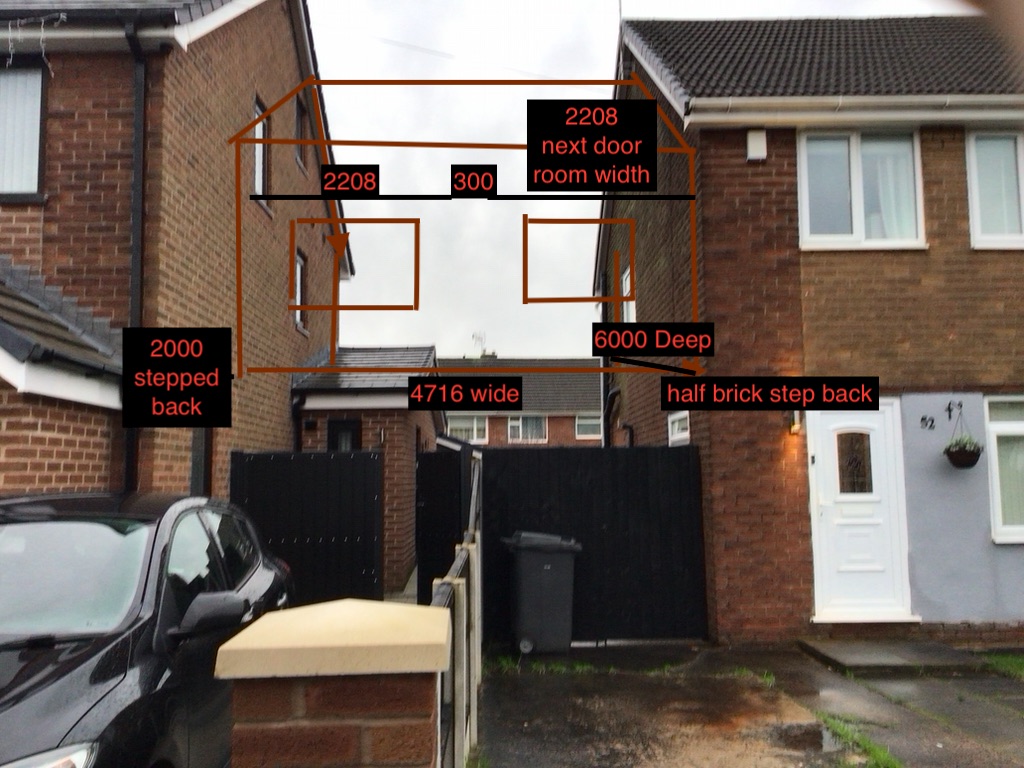

I’m thinking of a extension but only access but would this pass building regulations?

This is to access a side first story only extension to access the room.
So you’re proposing a first floor or two storey side extension and the only access into this new first floor room is off the stair between the first and second floor levels?

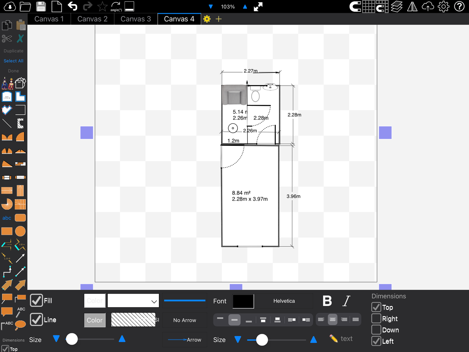

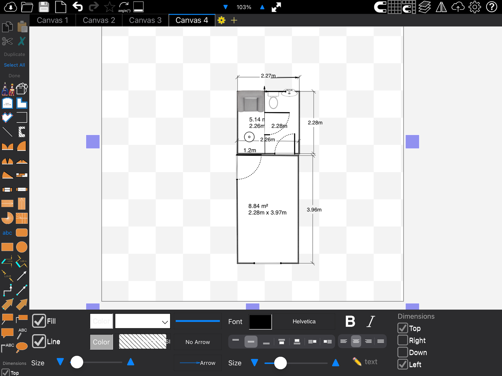

Do you have any floor plans you can upload?
The extension will span the 2 properties and the access will only be able from the first floor window witch is the middle gable window on the drawing

If not already obtained, I'd be more concerned about getting planning permission.
