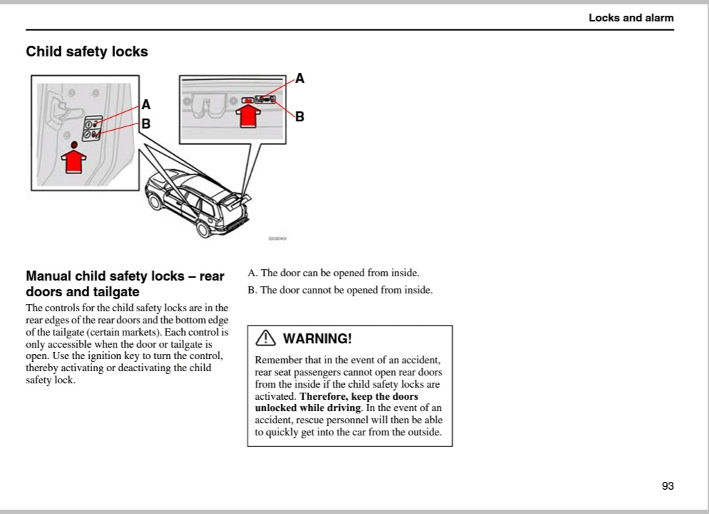

foxhole Joined 14 Mar 2006 Messages 22,074 Reaction score 3,082 Location Essex coast Country 2 Nov 2021 #17 freddiemercurystwin said: I'm not quite sure I follow what the Oap's exact problem is. Click to expand... See Original post, does my vehicle have manual child locks, no point ripping out the door cards to fix something that’s not broken.

foxhole Joined 14 Mar 2006 Messages 22,074 Reaction score 3,082 Location Essex coast Country 2 Nov 2021 #18 Had both panels off , effected a strengthening of both door pulls, I can see they operate at the lock, but still neither will open.

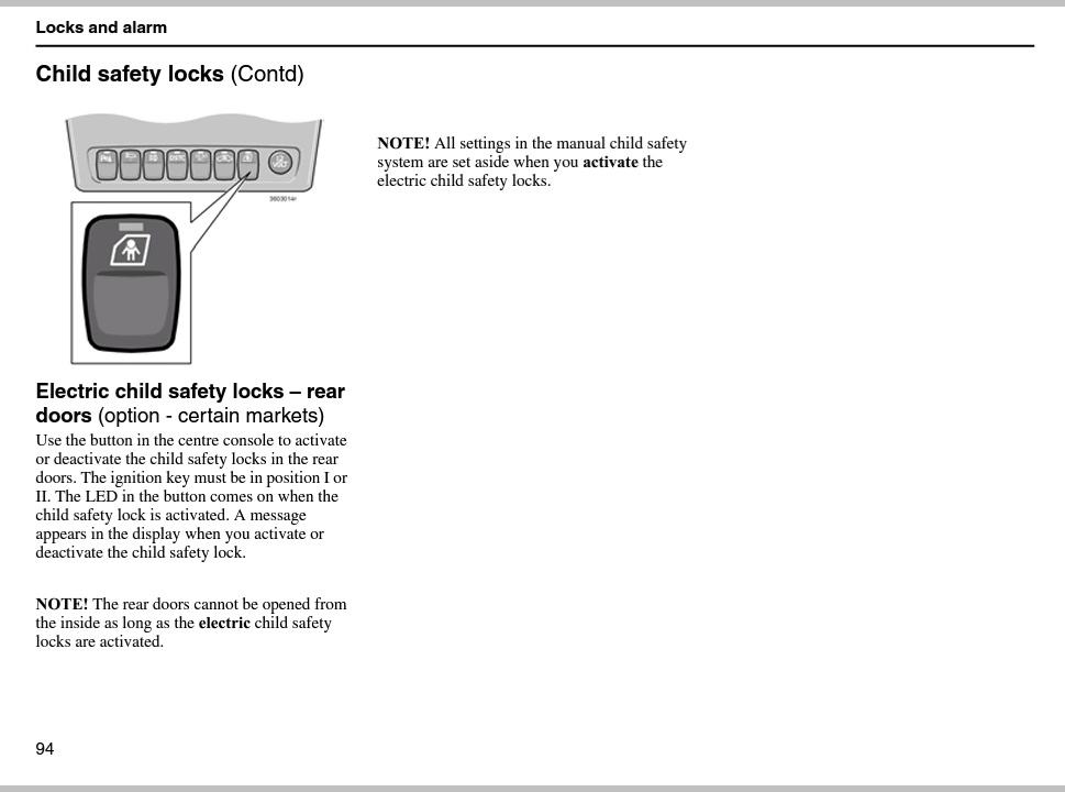

R RandomGrinch Joined 15 Jun 2021 Messages 5,786 Reaction score 2,130 Location Wales Country 2 Nov 2021 #19 foxhole said: Had both panels off , effected a strengthening of both door pulls, I can see they operate at the lock, but still neither will open. Click to expand... I'm sorry, that didn't work. From the 2004 handbook, there are the only two options, and I guess you've seen these already: If you have the button, you have the electronic version and it's worth checking the switch operation etc.

R RandomGrinch Joined 15 Jun 2021 Messages 5,786 Reaction score 2,130 Location Wales Country 2 Nov 2021 #21 foxhole said: No attachment Click to expand... Sorry, try a refresh. I just had to edit the screengrab.
