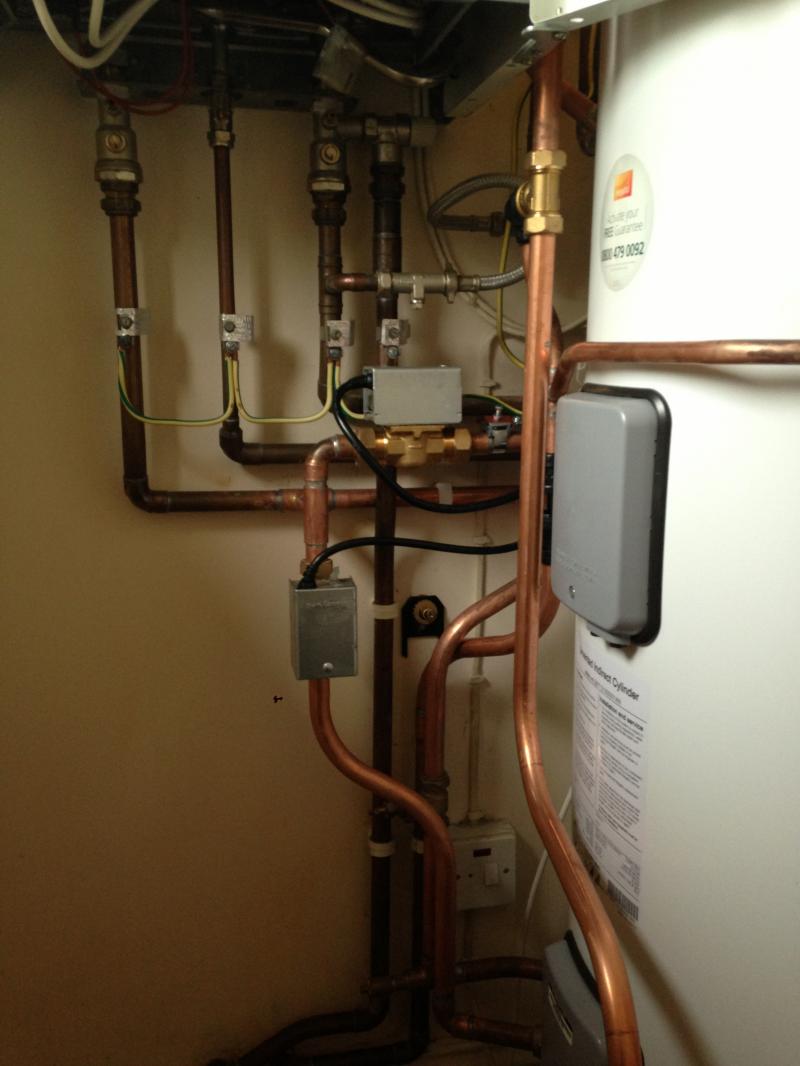

Y plan with 6 core and 5 core valves
Is the plumber G3 registered, Just ask him about the D2 pipe from the tundish ;)
I'm not G3 but thought it had to be 300 straight below ? (Waits for incoming)
Where the flow comes off the boiler and tees off for the two 2ports, where does the horizontal pipe go to ?
Gigz tundish can just be seen between vertical copper pipe and electrical box on the megaflow ;)
I sees it but it looks like its got a bend(s) below. Mind you me peepers aren't wot they used to be ;)
Yeah the bend has to be at least 300m away. Or are we on different thought paths? :oops:
No, I think we're on the same path, thought it had to be 300 but wasn't sure.
