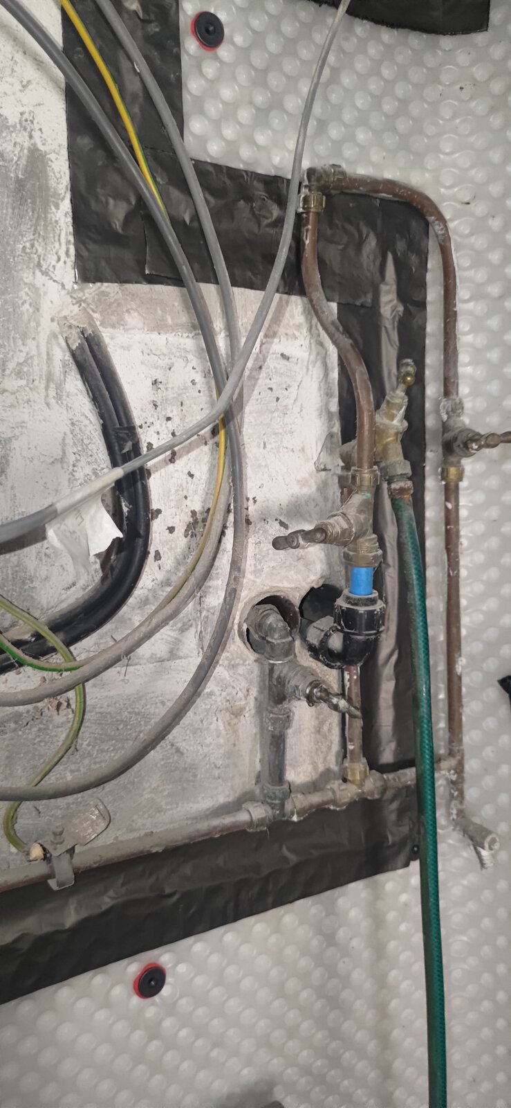

Hi all,
I need some advice. Our stopcock is peeing water in the basement. It's right next to the electricity meter and fuse board.
We can't find an external street meter or stopcock and the water board hasn't a clue where the feed is. So I've excavated the back yard and exposed the pipework. It seems the mains feed is in yellow 25mm MDPE pipe. The stopcock in the basement is attached to 20mm blue MDPE. I'm assuming they ran the 20mm blue inside the 25mm yellow.
The house was built in 1992. Why would they use yellow pipe? Is this common practice?
I need to use a squeeze off tool to cut the supply so I can fit an external stopcock. Will clamping off twin pipe work or do I need to cut out a section of yellow pipe first?

Seriously! Black pipe from top of image is gas to meter box. Grey downpipe is the electrical supply. (I patched it because I opened it up to see what it was) blue MDPE on left supplies redundant outhouse. (who builds an outhouse in this day and age!) yellow MDPE is mains water. (see threaded rod I used to mark from the internal stopcock)

How about a photo of the stopcock and leak - we may be able to suggest a less devisive fix?

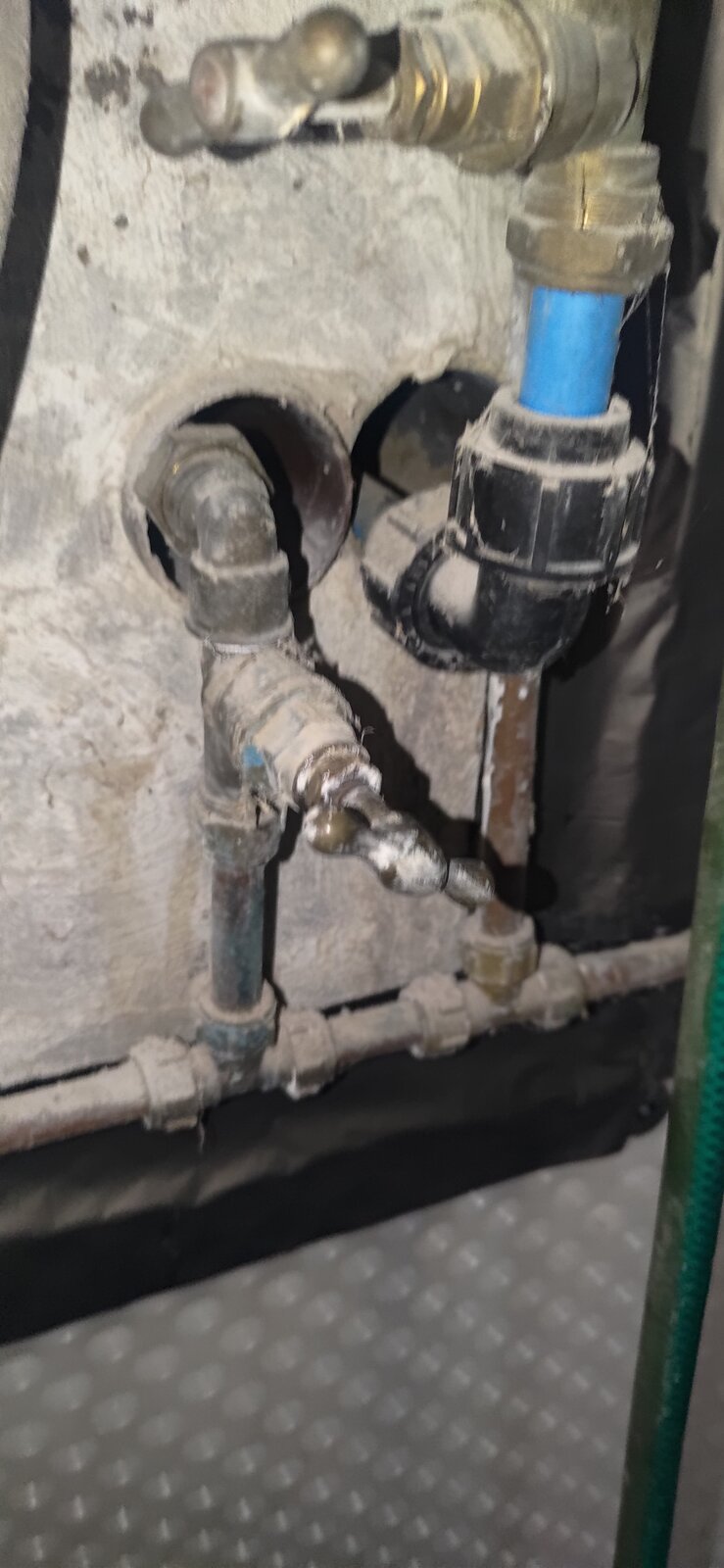

The attached are the basement feeds. No gas supply enters that wall. The only feeds in here are the phase tails for the electricity supply and two "BLUE" MDPE 20mm pipes. On the other side there is one blue 20mm and one 25mm yellow.
I can't touch that stopcock live when it's a foot away from exposed main voltage. Squeezing the blue pipe does nothing as its empty. I can open and close the right hand stop cock and see water start/stop at the outhouse without impacting the main house. The left hand stop cock shuts off the whole supply.
