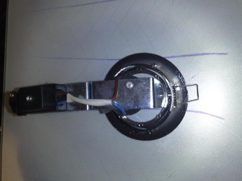

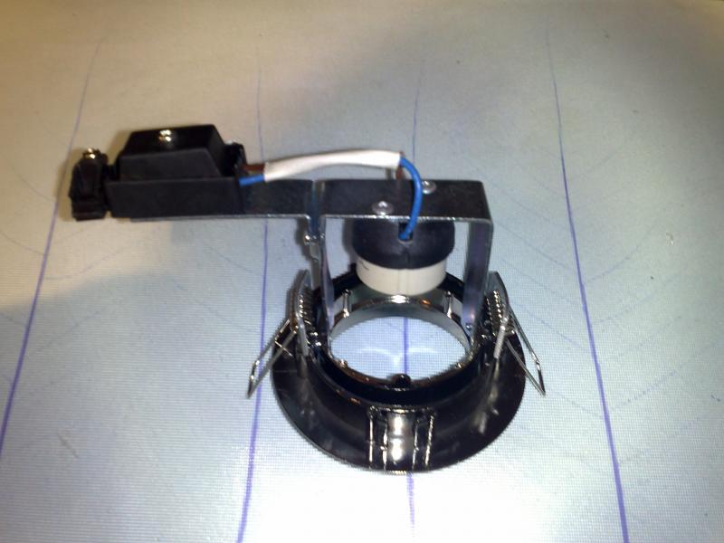

Hi,
I have just been repairing a GU10 downlight at home. The fitting is not earthed. There seems to be no means of connecting an earth to the light. The twin and earth cable terminates into a plastic cover that is screwed to the top of the fitting and the earth is in a connector block.
Surely the light requires earthing or am I missing something.

They surprised me too
Even though the singles touch the metal frame above the lamp holder they are still class 2 :?
I saw some similar to that yesterday.
The fitting was Class II, but the lampholder leads went through an unprotected hole in the steel case, into a terminal block marked with the squares symbol & "earth connection facility".
This was just a choc block for ensuring earth continuity round the circuit or somewhere to park the cpc.
