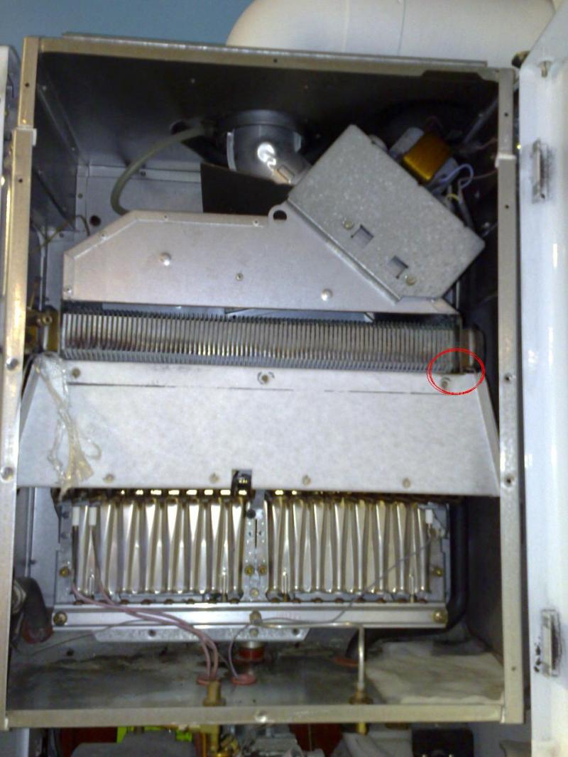

I have a VAILANT boiler which seems to have sprung a leak (1 week after redecorating the kitchen!!). Anyway, I am not 100% sure of the boiler model, (no manual left by previous owner) though it is a Vailant and is a conventional flue vented type. It must be AT LEAST 6 years old.
1. I would be grateful if anyone could identify the model as I can find nothing on the boiler which does this. A Picture of the inside of the boiler is here..
Below the shown part of the boiler in the picture there is a beige/brown plate that has a BAR pressure dial on the right hand side and an On/OFF switch and heat(?) dial on the left. It is wall mounted.

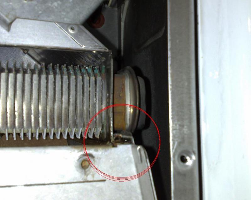

2. I have opened up the immediately accessible parts of the boiler and traced the leak up to what I think it the Heat Exchanger, though I am not 100% and would welcome any input here. The red circle shows the point to which I can trace the water back...

It certainly looks as if its the main HE which is leaking.

A new HE is probably about £140 or so. take about 1.2 hours to change.
Its about 80% efficient which is not too bad. A replacement might be about 15% more efficient but cost about £2000 installed.
The task of replacing the HE should be carried out by a competent CORGI engineer.

God knows what the particular variant is but its one of the battleships...is it the vuw range?, grey fascia panel, two hinged access doors etc.
Looks like the combi compact or thermo compact last made circa 1995 original 1985/87 reliable boiler parts still available

Thanks for your help on this. I had another look around the boiler the other day and found ID badge.
The model is Vailant Thermo Compact... VC GB 242EH.
Going by what Agile says about the boiler it sounds like the way to go would be just to get an engineer into replace the Heat Exchanger.
