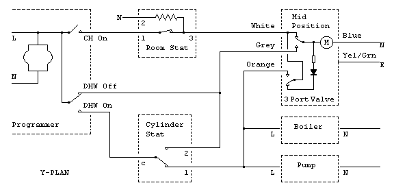

Hi,
Is it possible to do a plan W from a plan Y, without chnaging the valve of course. I'm trying to optimise my new oil boiler and I reckon it would be better on plan W where HW has priority. Of course I could just use the time clock but that's not as flexible.

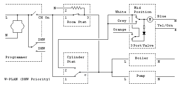

You would have to rewire from this:
To this:
ChrisR said:
... HW wouldn't come on unless the CH was on, and....
That is correct Chris. A "Priority" W-plan (in this case DHW) only needs one switched live (timed) contact to control the system. The W-Plan document, on the web-site that you provided link to, states (on page 2):
"Time Control - Any time switch or
mini-programmer may be used
provided that Heating cannot be
selected without Hot Water".
So, the CH only comes on when the cylinder stat is satisfied.
Thanks for that. But, I now see that I don't exactly mean a plan W, but rather a WY :) . That is I can separately control HW and CH but if HW is on then it takes priority.
My reasoning is that a HW boost would be useful about 5pm but I don't really want the valve flicking back and forth as the room thermostat clicks on. Thermal lag in the house is long enough that it would be better to heat the water, then do swap back to the house when the water is hot.
Actually the other thing I could try is making the HW circuit much lower resistance which should have the same effect I guess. The HW circuit has a gate valve and currently I've set it about the same as the CH circuit so that on HW only it does not trip the bypass.
In general it seems to me that having HW and CH on at the same time is not that clever an idea, at least at startup. It takes about 30 minutes for my radiators to heat up. So during that time the same water going through the HW circuit would be taking heat out of the HWC.
Not really. You might as well have water going to the radiators, as the surface area of the coil in the cylinder can't pass anywhere near the output of the boiler. All that will happen is the boiler will cycle on it's thermostat more. Just have a Y plan, it will save you having to put in an abnormal system.

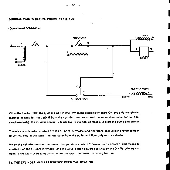

Well CH4 I ask again where the diagram came from. I think it's wrong, Honeywell think it's wrong, the customer thinks its wrong.....
It's based on a diagram from an old Honeywell book of Sundial heating plans:
In my sketch, I used the existing 'CH On' switch as the system timer, though it could just as easily have been the 'DHW On' switch.
It's purely academic now, but in what way is it wrong or wouldn't work?

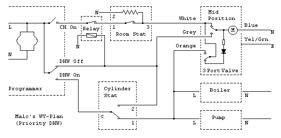

Malc,
The heat exchanger coil in your cylinder must be very effective to take 14 kW continuously for 20 minutes.
So, if you still want your system to have priority DHW, then a simple modification to your Y-Plan, which should work, would be to insert the 'Normally Open' contacts of a power relay (with a 220-240 V ac coil) between 'CH On' and the Room Thermostat - energising the coil from 'DHW Off':
The CH would, thus, only come on when the cylinder stat is satisfied or when the DHW is off at the programmer.
Thanks for the suggestion. Using a relay was the only way I could think of too.
